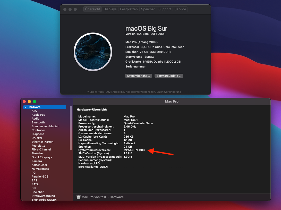

As long as you dont upgrade the processors (or keep a Tray with the original cpu). You can switch back and forth 4.1 / 5.1 firmware. Just dump the rom with Flashrom, Dosdude’s or my tool.
As long as you have not upgraded processor(s) you can flash back the 4,1 firmware with Flashrom/Romtool.
btw I flashed a very ancient 5,1 Firmware some weeks ago and it made no impact on the situation.
