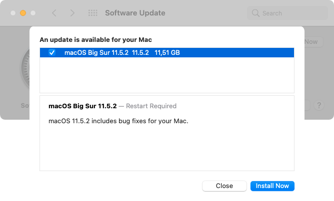

Apple just released 11.5.2 (20G95). Software Updates release notes:
  • macOS 11.5.2 includes bug fixes for your Mac

Just updated to Monterey Beta 5 and for the first time it updated on its own without any hard reboots!!
