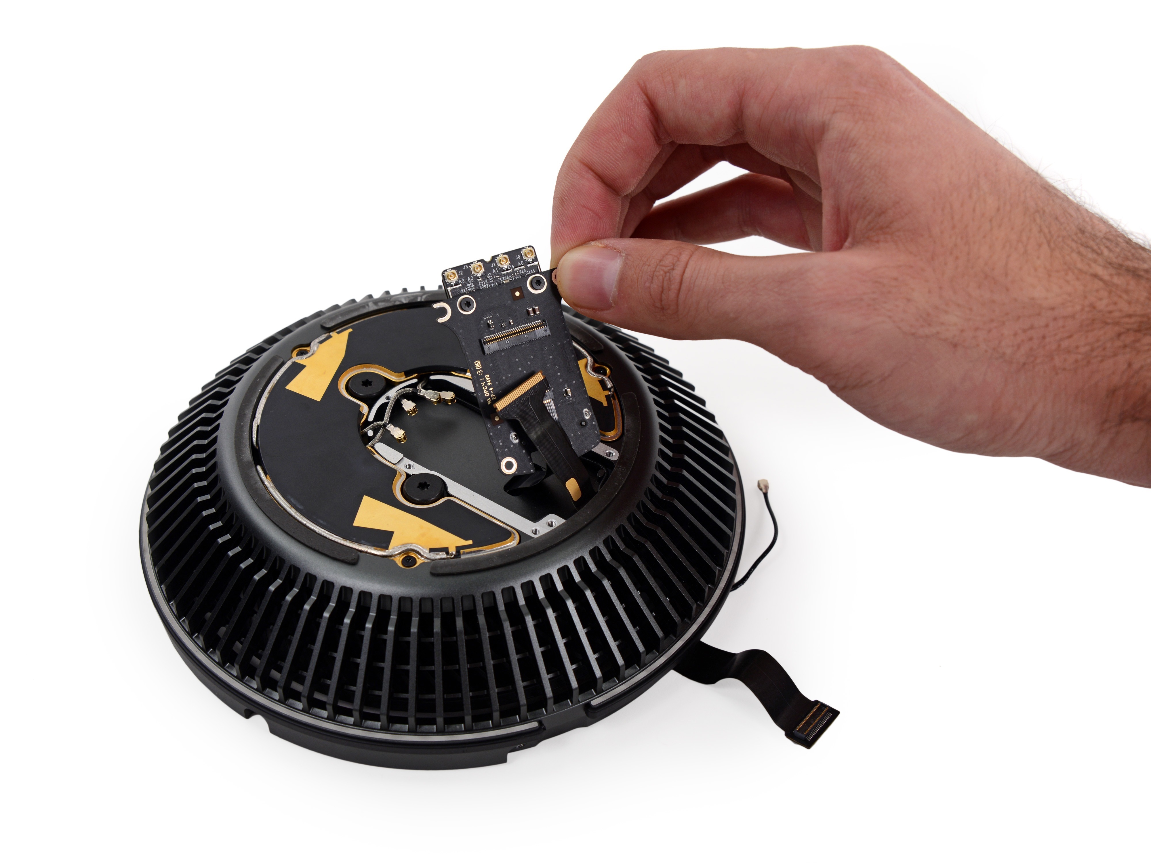

I am just downloading the diagnostic tool. What means/are disconnected airport?MacPro6,1 does not even have SATA devices…
No, you already have 481.0.0.0.0. You probably have something wrong with the 12+16 socket or the adapter. I'd install back the AppleOEM blade and try to run ASD 3S159 to see if something is wrong with the hardware.
Disconnected AirPort can cause high CPU usage and your low transfer rate can be from that.

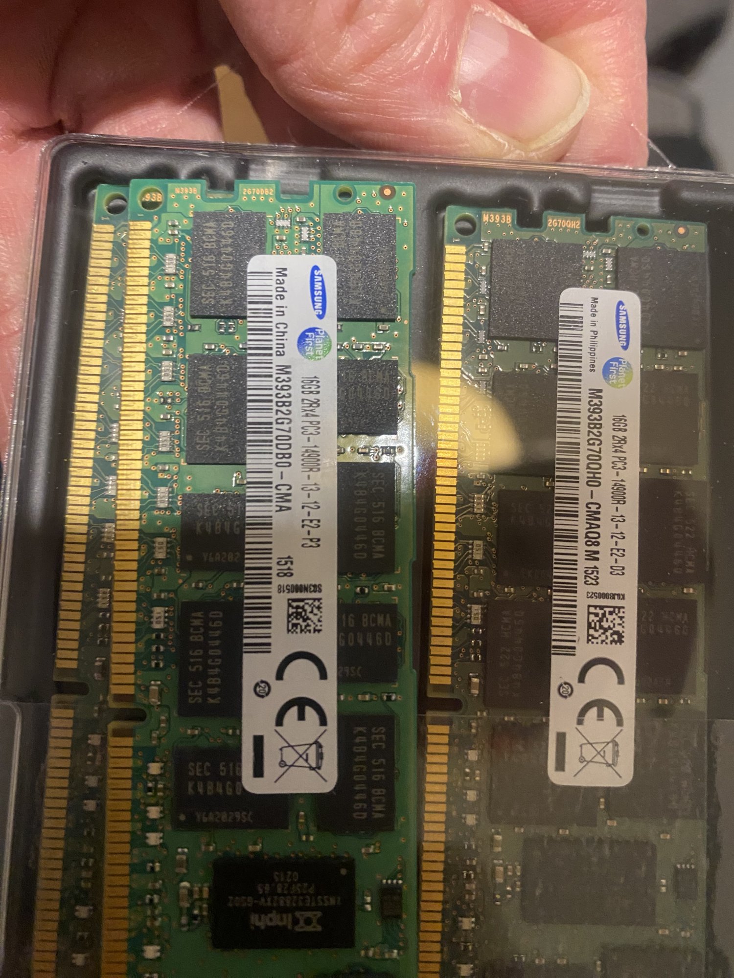

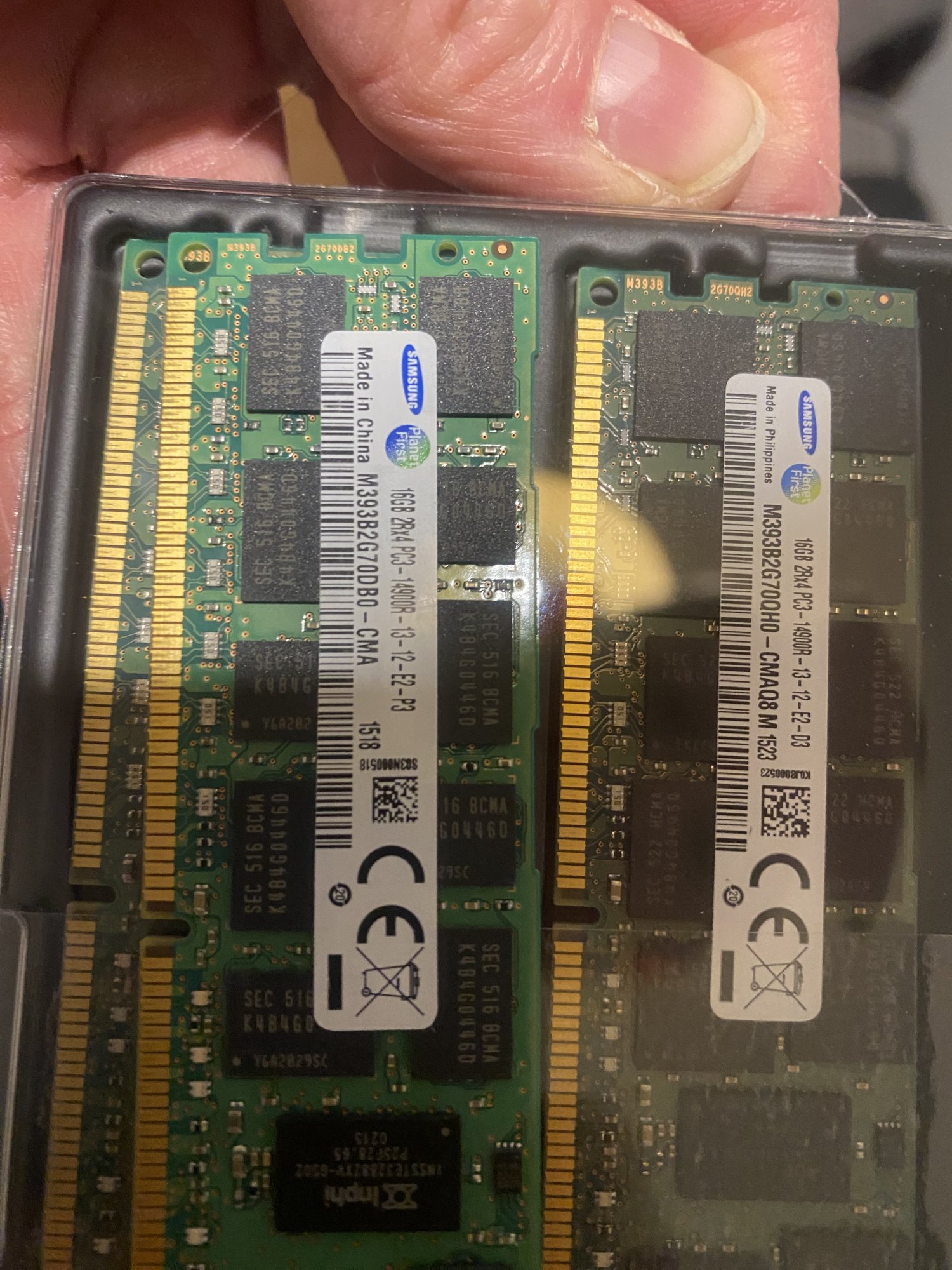

So here again some feedback- the issue lies in small details. After the memory Desaster I ordered memory specially from a German memory reseller for the 6.1.Can You see the difference? I cannot see, I am very sorry for that. The top one is the one not working, the memory in the package is working like a Charme.. now max memory and high speed NVME + total clean device (when opened for the airport topic cleaned the can with pressure air)So ladies and Gentlemen, This day I worked it out. The story went completely different. As you mentioned I tried the ASD and the Mac Pro was totally fine. No problem with Airport nothing. But one thing was NOK: The memory! When I bought it two years ago, I ordered non Apple memory that worked - 64 GB ECC-R. but exactly those lead to the problem. Registered dimms seem to be not so good. I changed back to the original ones I still had and ran the tests and wow! I have now 1400 Write 1400 Read! I also tried all the NVME I have still laying and the best performance came from the Samsung 990 Pro 1 TB NVME - WD Black or Crucial P3 or 970 EVO exactly 100 MB below. So this shall be the end of the story and I am happy!!! Thank you for ideas and effort!!
The spec looks identical so its most probable that the DIMM is faulty in some way. I had a similar situation the 6.1 which would run very slowly after I had installed a RAM upgrade. Changing the DIMM fixed the problemSo here again some feedback- the issue lies in small details. After the memory Desaster I ordered memory specially from a German memory reseller for the 6.1.Can You see the difference? I cannot see, I am very sorry for that. The top one is the one not working, the memory in the package is working like a Charme.. now max memory and high speed NVME + total clean device (when opened for the airport topic cleaned the can with pressure air)View attachment 2356230
I am thinking more on the memory organization. I am no Samsung DIMM specialist, but the working memory Has CMA Q8M signature. This might mean different internal details. In an HP DL380 G8 or a Dell server the memory might work without issues..The spec looks identical so its most probable that the DIMM is faulty in some way. I had a similar situation the 6.1 which would run very slowly after I had installed a RAM upgrade. Changing the DIMM fixed the problem
