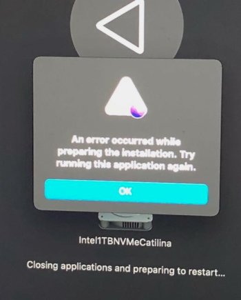

The machine came with 430.140.2.0.0 and no SSD, after swapping the Crucial P3 with a Samsung 980, and doing a fresh install of Monterey from flash drive, the SMBIOS is 474.0.0.0.0. Everything works as it should.
The problem with the P3 was that the Mac wouldn't show anything on the display at all, not even a black screen. It would chime as if it were booting though. I ended up returning the P3

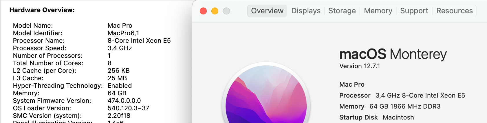

I don't have change to cross check but do you have any idea why the firmware on my mac are still the same?
Difficult to pinpoint. Usually is a non-compatible SSD installed internally, booting via external SSD (does not update the BootROM) or even something unexpected like Apple pulling the update.
Got it. It is because non-genuine Apple SSD in my Mac. After replace with the original and perform the upgrade, it is now 478.0

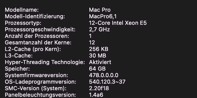

Short feedback from my side:
Updated Monterey on an external USB drive, and the firmware was also updated.
Internal SSD is a KINGSTON SFYRD2000G

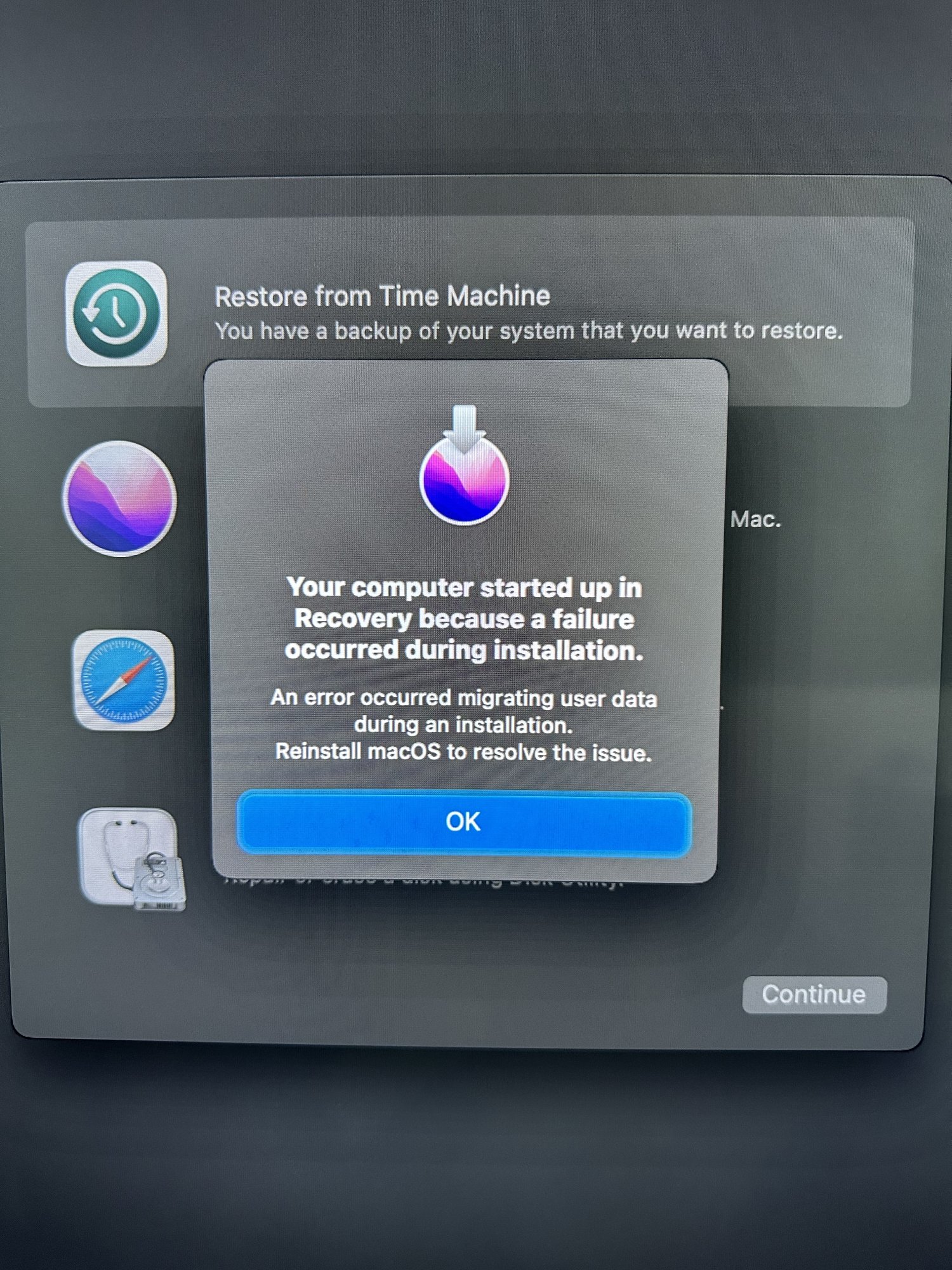

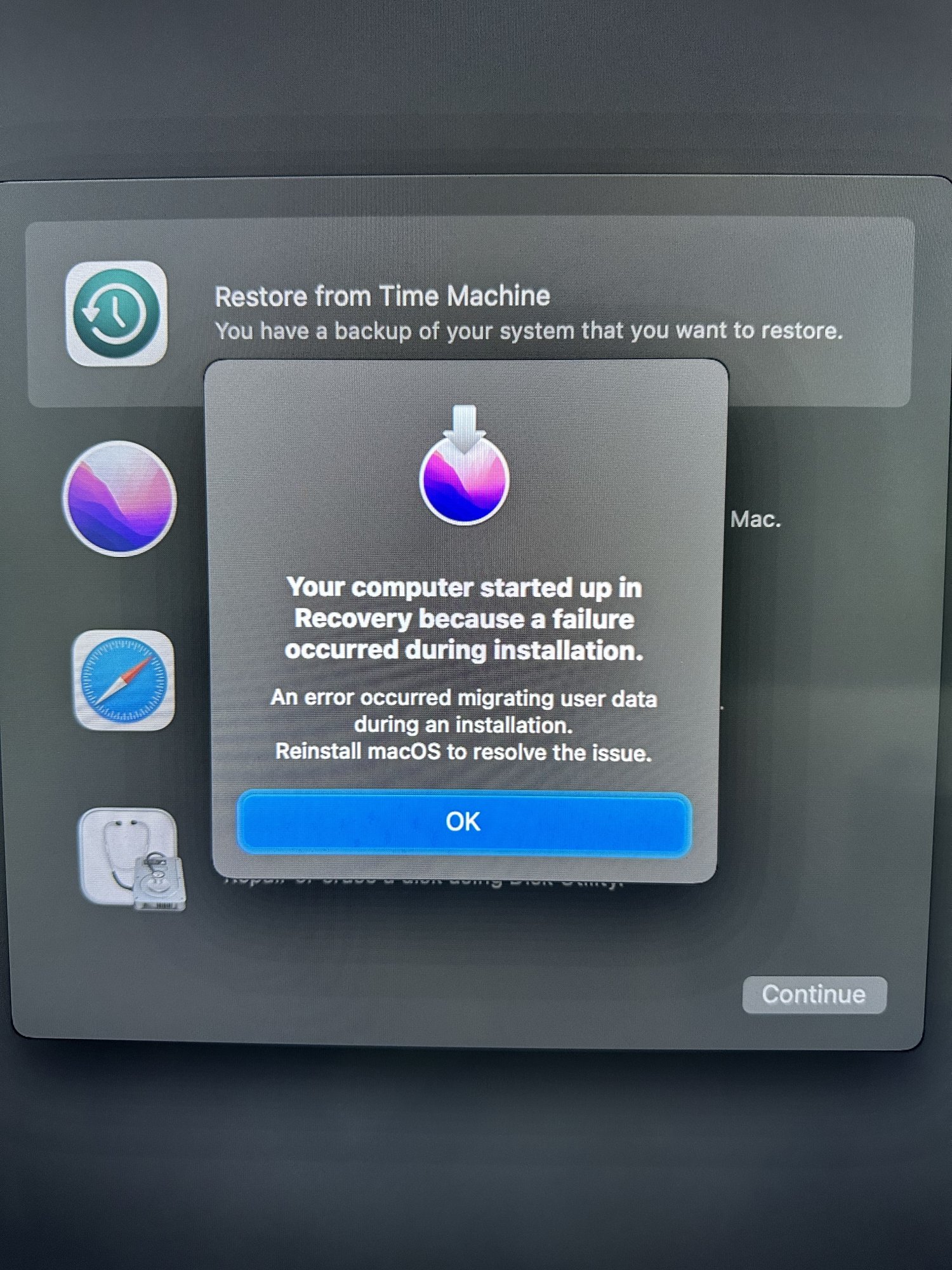

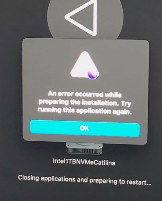

My Mac pro was booting fine until I did the latest update now it refuses to boot, I can boot it from my external bootable back up and from my win10 partition, I have tried re installing but it still reporting the error in the 2nd image below, first one is incorrect.
I don't understand it.
Model Name: Mac Pro
Model Identifier: MacPro6,1
Processor Name: 6-Core Intel Xeon E5
Processor Speed: 3.5 GHz
Number of Processors: 1
Total Number of Cores: 6
L2 Cache (per Core): 256 KB
L3 Cache: 12 MB
Hyper-Threading Technology: Enabled
Memory: 64 GB
System Firmware Version: 478.0.0.0.0
OS Loader Version: 540.120.3~37
SMC Version (system): 2.20f18
Panel Illumination Version: 1.4a6
