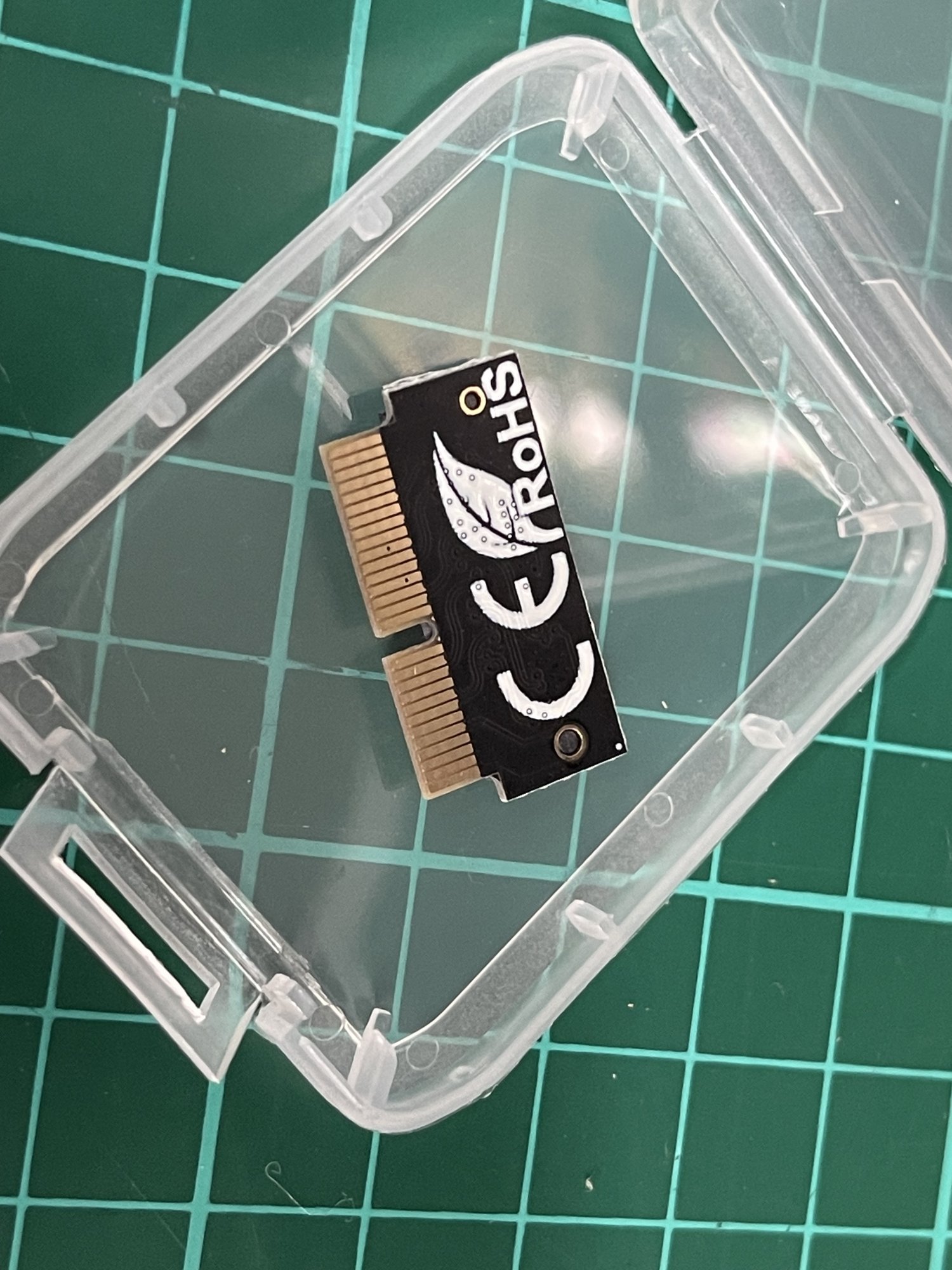

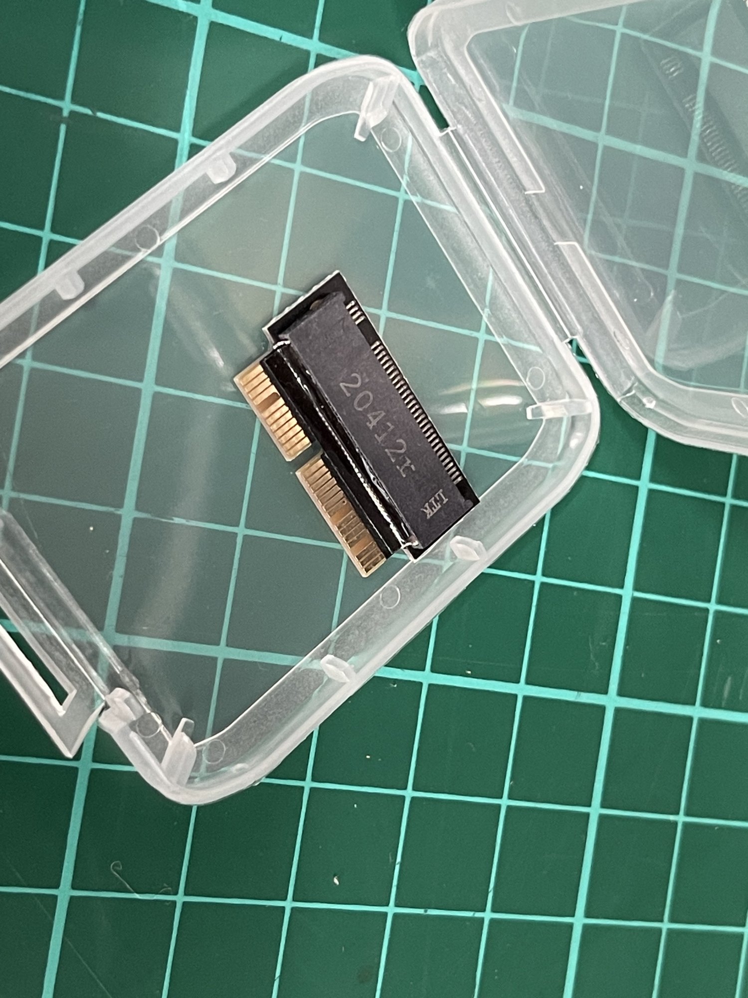

I believe it to be a Sintech, bought from this seller: https://www.ebay.co.uk/itm/323975203337
