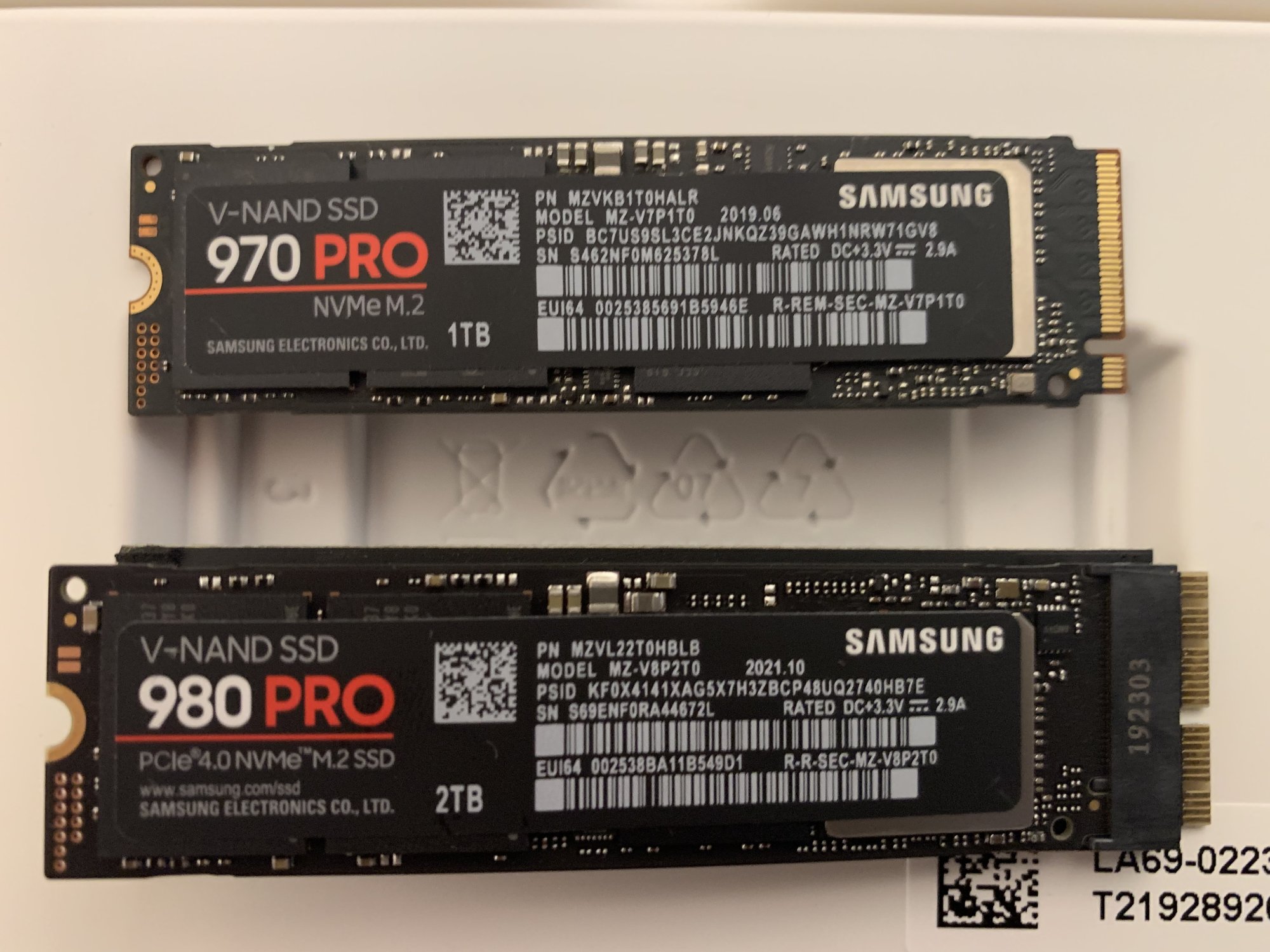

Mac 2013 don’t startup in recovery mode​
hello
I am trying to replace my Samsung 970 pro 1tb drive with a Samsung 980 pro 2tb on my larely 2013 mac
There is a strange problem:
- with 970 and mojave: no problem booting the mac, with a mojave usb drive, ready to install (keyboard mini bluetooh logitech and usb cable connect to usb mac port) appear firmware password enter my root password and appear recovery functions with not issues
- with 980 prepare into the mac without formatting already: CMD+R or any other key combination does not work: option, c, shift option cmd r, option cdm PR for reset PRAM etc.
I am suspecting that the battery of the mac 2013 BR2032 may be dead.
I can't find an explanation
thanks in advance
tsialex
Contributor
Jun 13, 2016
13,461
13,613
hello

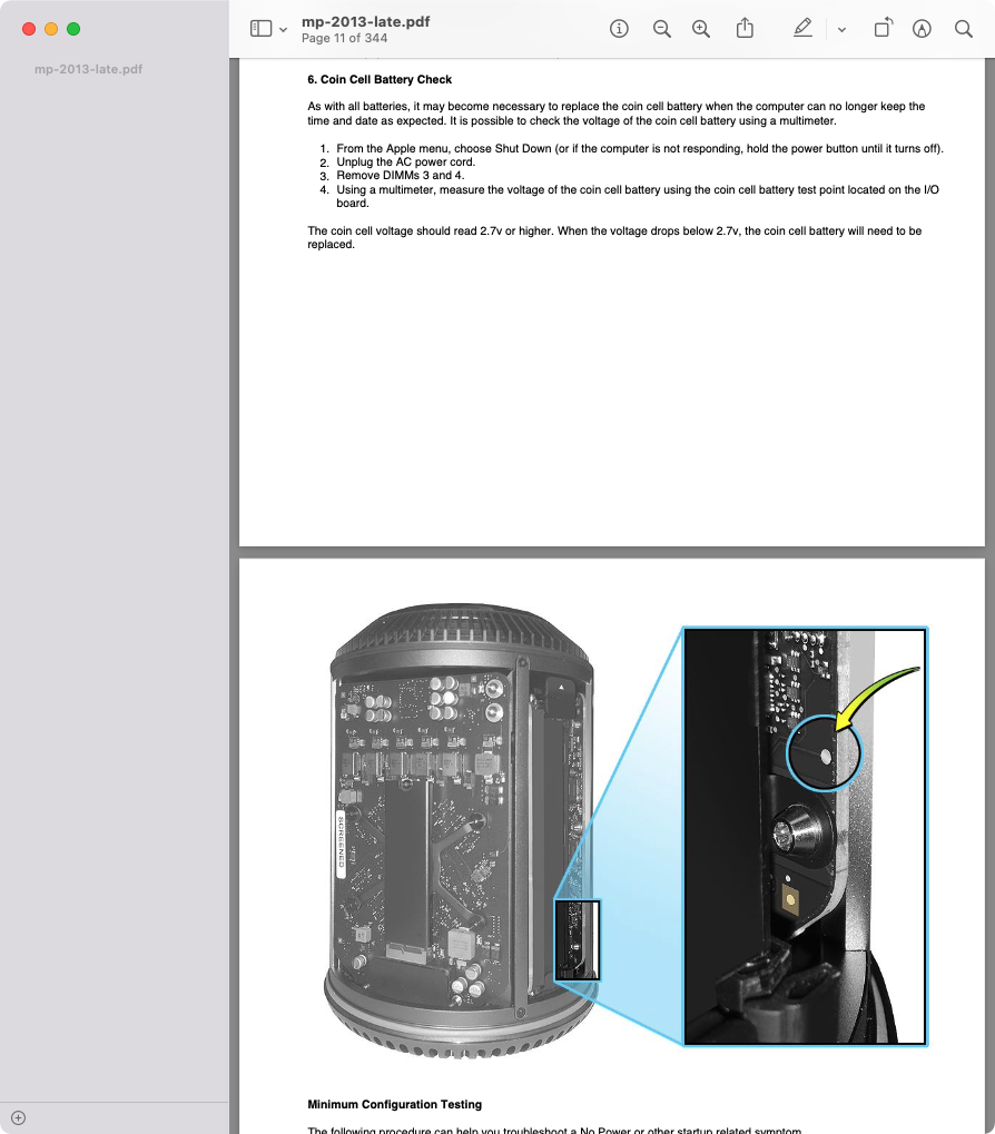

thanks in advance
Samsung 980 series is a PCIe v4.0 NVMe 1.4 blade that is not backwards compatible with Macs that have PCIe 2.0 NVMe 1.3, like MacPro5,1/6,1.
Samsung 970 series work fine with MacPro5,1/6,1.
There are RTC battery test points, easy to check:
Reactions: controsol
controsol
macrumors newbie
Mar 23, 2011
15
Thanks so much tsialex
I need to instal a 2tb unit, 970 pro 2tb is impossible to get
Can you recomend a 2tb for the mac 2013?
Thanks in advance
tsialex
Contributor
Jun 13, 2016
13,461
13,613
Will the performance be similar?
Thanks
Even if the performance is not similar, why it would matter since it's bottlenecked by the MacPro6,1 PCIe v2.0 connection?!?
It's limited to ~1450MB/s of the real life x4 PCIe v2.0 throughput and any modern blade is capable of at least the double.
