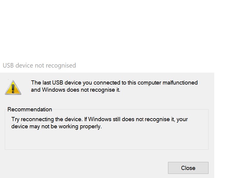

My 'Wacom Link Plus' arrived today and works with the RTX2070 card :). It looks stunning but need to sort the brightness driver out.
Only issue I have is that I have no sound
Is there a specific driver I'm missing? I've tried windows update and looking for drivers under device manager but still no joy 😢
