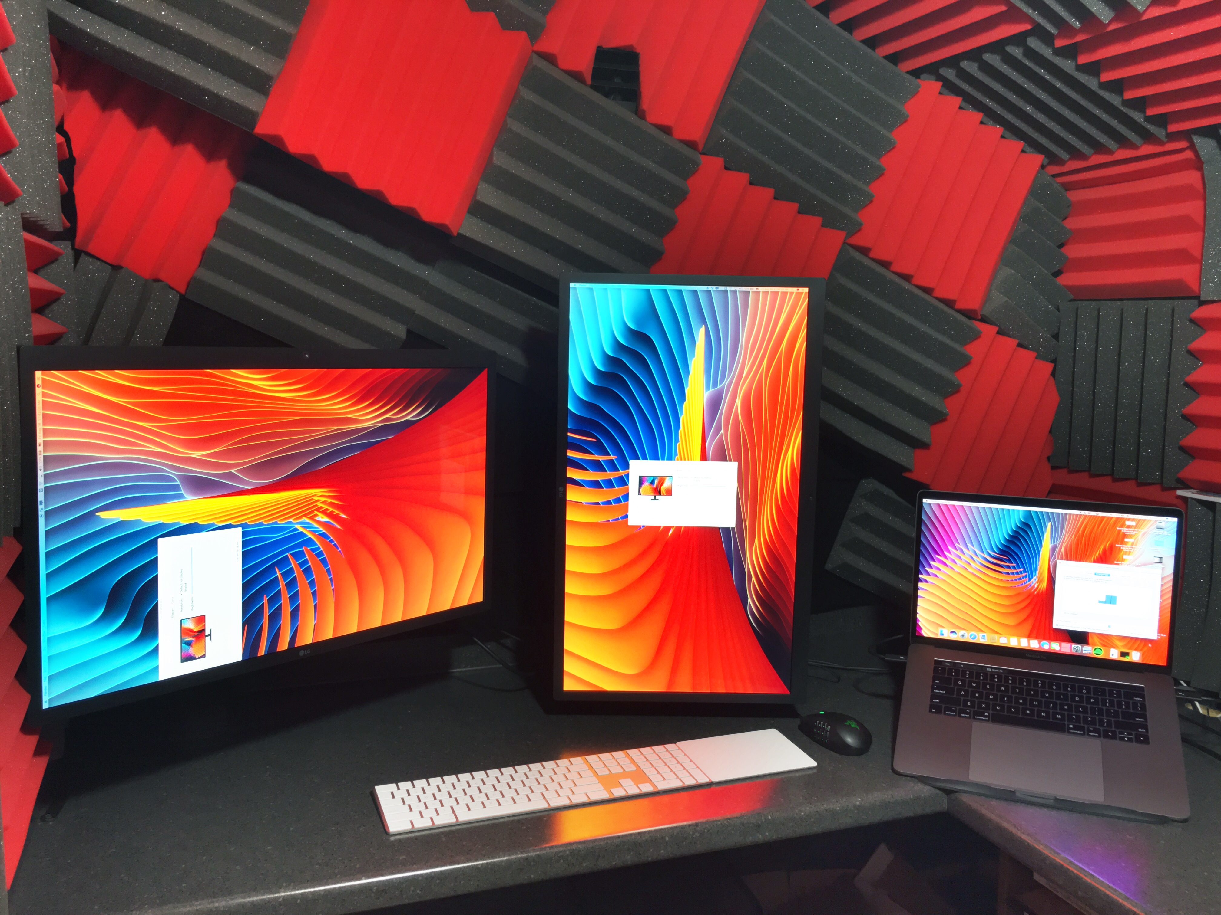

~~~ Minor Hack ~~~
While searching for a solution to this recently, I came across at least two websites (can't find them now) that had someone mention that they were able to get a pair of LG 5K monitors to display with BOTH being connected at the same side of the MBP. Other technical details of the TB3 standard shows that this should not be possible. The trick is to connect both TB3 cables at the same port at the same time. If connected "one at a time" then the second connection will never activate the display.
So out of curiosity I wanted to see this for myself: It works!
Then I discovered something else that was interesting: Rotation is natively available in Display Preferences!
The reason that this works is because in order for the MBP to display output to two 5K displays natively each 5K display needs to be connected to a single TB3 controller in order to manage the bandwidth of the TB3 protocol properly.
Left or right, each pair of TB3 ports on each side has it's own TB3 controller to work with, hence why Apple/LG state that you should connect each monitor to one side of the MBP.
So given that a pair of 5K displays does technically exceed the ability of a single TB3 controller to handle it adequately, what it is doing is the same thing that it does when you use a TB2 cable in between a pair of adapters. It is dropping the signal of the image down to a 4K output and then up converting it back to a 5K output. HiDPI is used, so the artwork of icons is used and looks decent, however due to what I will call a "pixel-doubling" sort of math going from a 4K signal to a 5K signal, I noticed that text would sometimes looks odd, such as the thickness of the line in the letter 'l' would be thinner than it would be in other places. Move the window that the text is inside of, and it would change thickness depending upon where you placed the window. To a casual data-entry person, they would most likely would never notice it. For those of us that are like myself, attention to details that are inconsistent just jump out and are difficult to ignore that distraction.

Sigh....so much for "wrapping it up", so here's a lovely photo of when I was able to get 90º rotation enabled on Sierra.

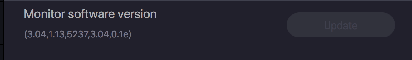

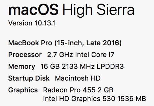

I'm very thankful if someone can help me quickly since my guarantee for my Macbook Pro 2016 will end next week and I need to take a decision what to do.
About 50% of the times I connect the LG Ultrafine the Macbook freezes and I have to reboot. Is this typically an error in the Ultrafine or the Macbook?
Another problem I have is lag in some software. This might be software related, but I'm very curios if it's the same for others? For example OmniGraffle works fine on the built in retina display, but when working on the 5K it's really laggy. Here's a video to show it (listen to the keystrokes) http://dl.pixelstore.se/nUIg.

I have the 2017 13" TB MBP and it has never froze for me when connecting to the monitor, however, it has failed to display an image once or twice at which I've had to disconnect then reconnect to fix it. This is running the latest firmware, same as you.
The lag I can attest to. Using Safari, with the screen maximized (or pulled to each edge) I get huge lag which makes the google maps website unusable (it actually freezes). However, shrinking the window to about a third of the total screen makes google maps usable again. Using Chrome to access google maps, there are no problems.
I even get lag sometimes when switching desktops, so I've minimized animations in Accessibility so it isn't as jarring.
Other than that, I haven't come across anything else. It wouldn't surprise me if some software isn't yet optimized to draw at 5k, and the integrated graphics on the 13" isn't helping either.

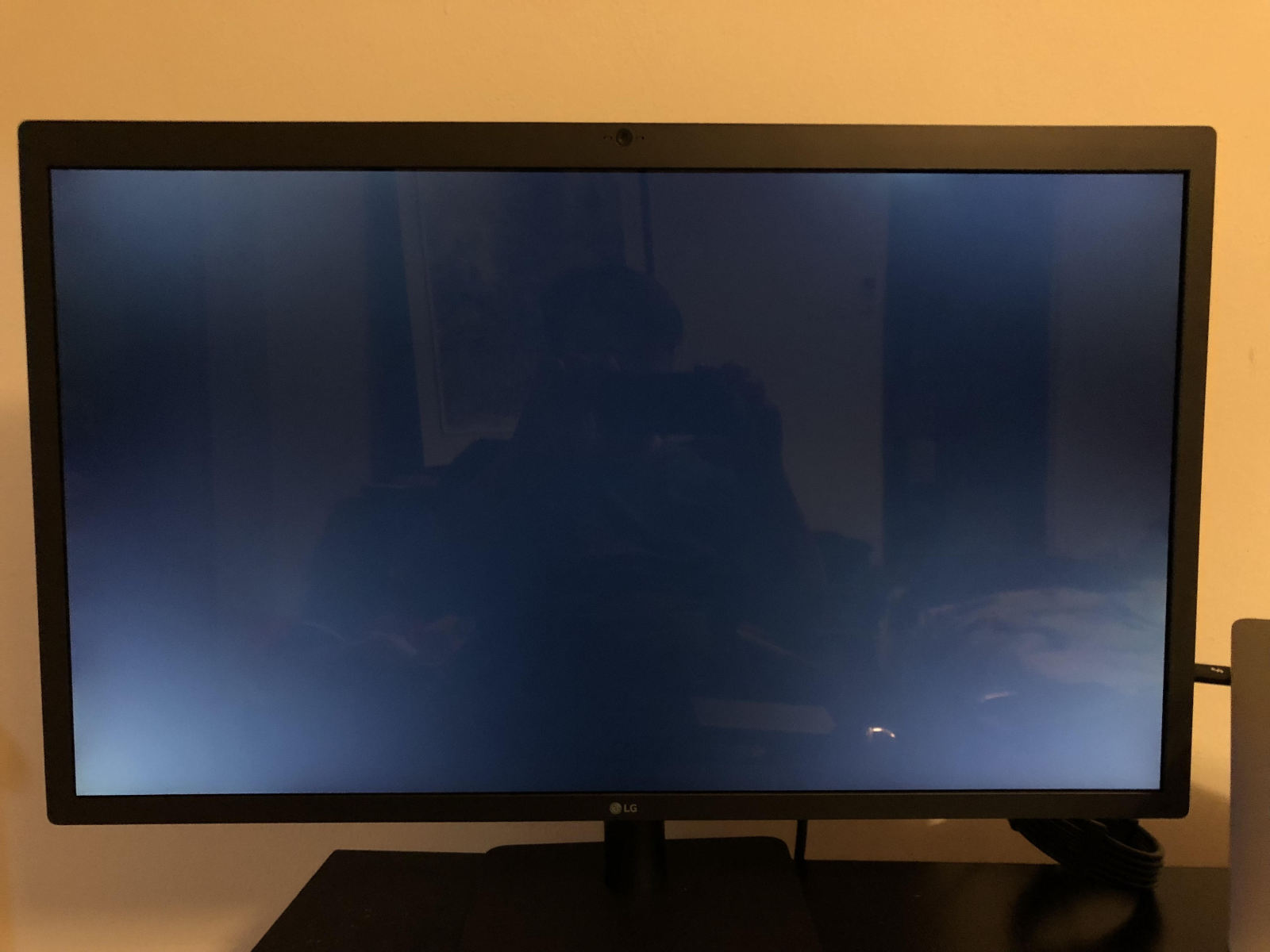

HI guys,
I just bought the 5k LG display from the Apple Store, and after bringing it home and setting it up, I realised that it has backlight bleeding on the edges. Is this normal for this display? Should I be returning it and asking for a replacement?
HI guys,
I have also the same problem in one edge. Also on MacBook. You will never find an perfect display. So its normal. You just see this when you put a black background.
this is one of the most expensive displays on the market. It's ridiculous to spend so much and not get a display that is less than perfect
Considering the cost, that's a little too much backlight bleed, in my opinion. You'll notice it when watching videos in letterbox.

Mine have much less bleed (only visible from the side and only in left downwards corner).

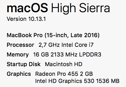

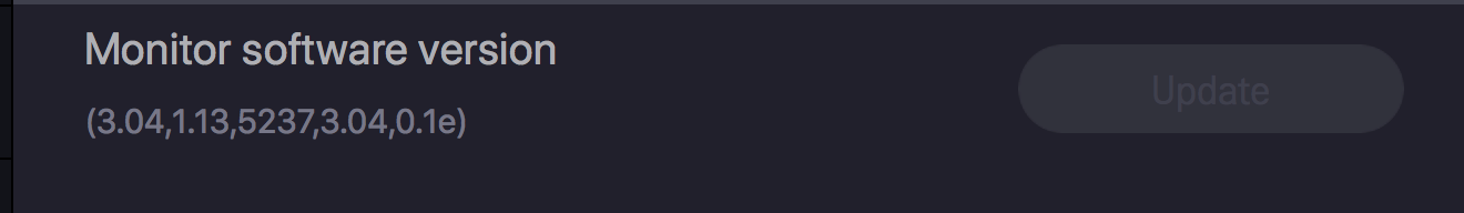

I have similar lag when running with my 5K. Can you check your console and see if this is anywhere in there:
