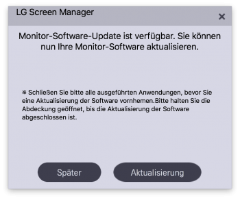

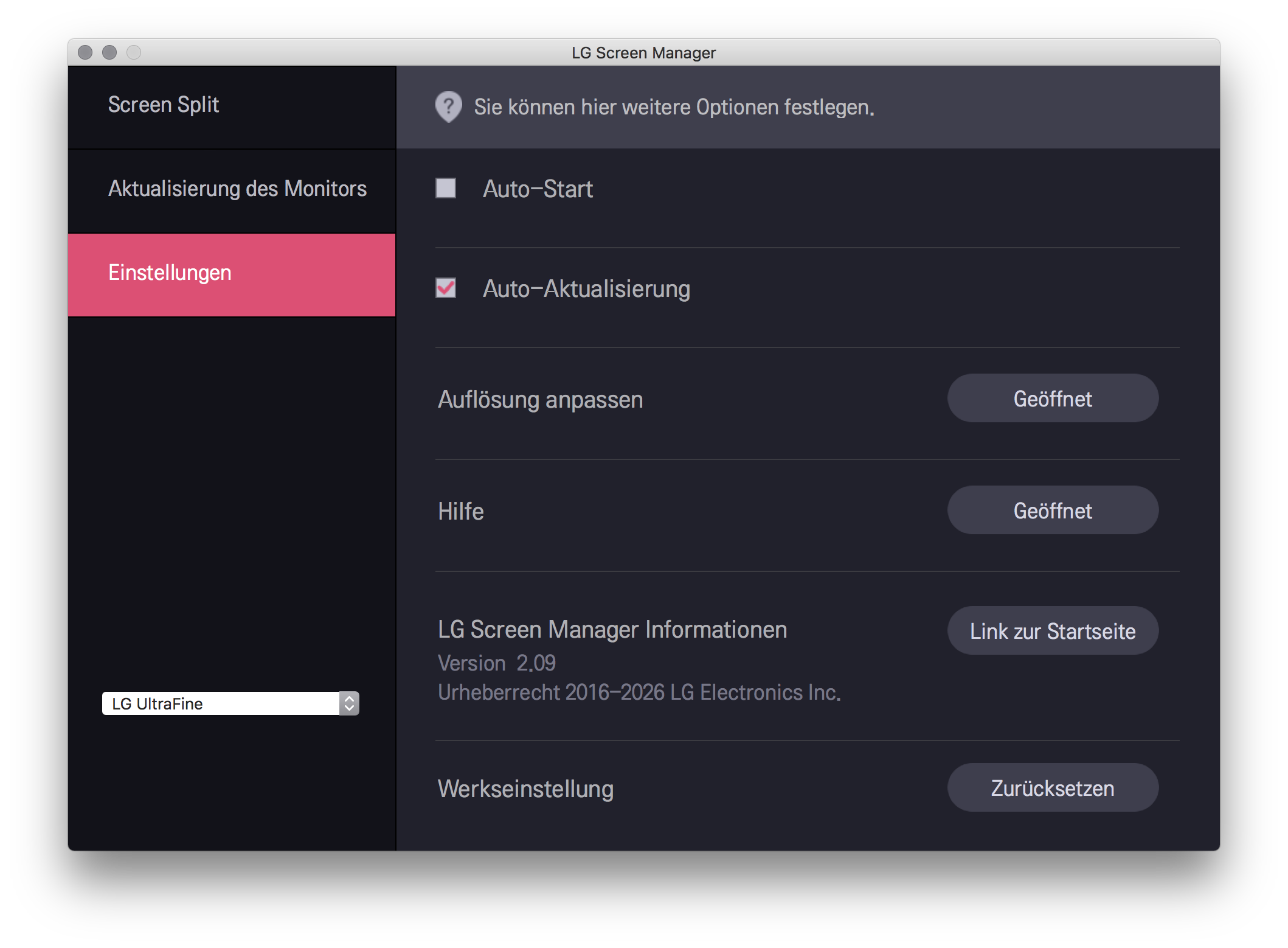

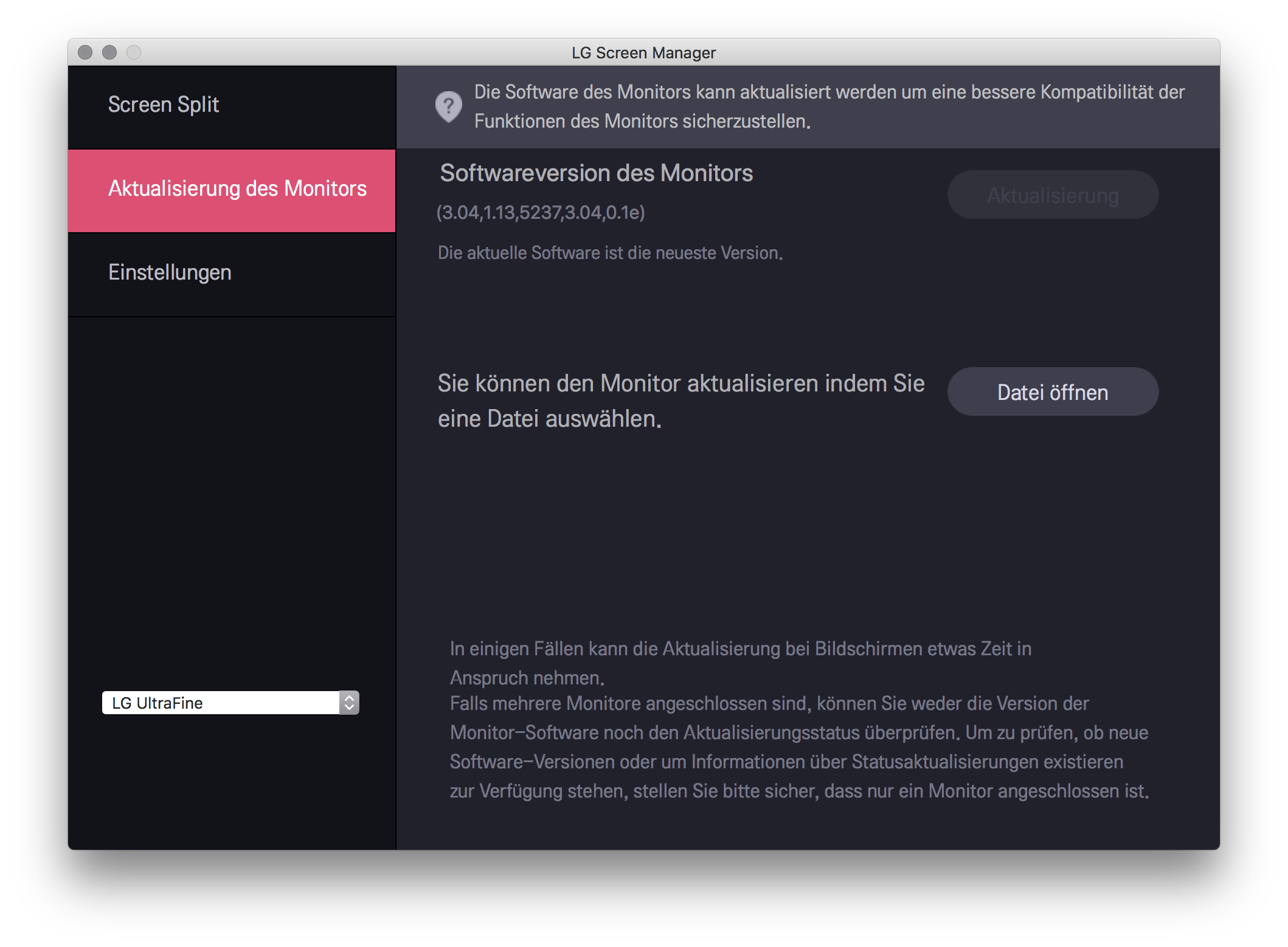

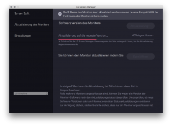

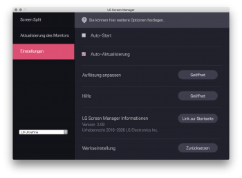

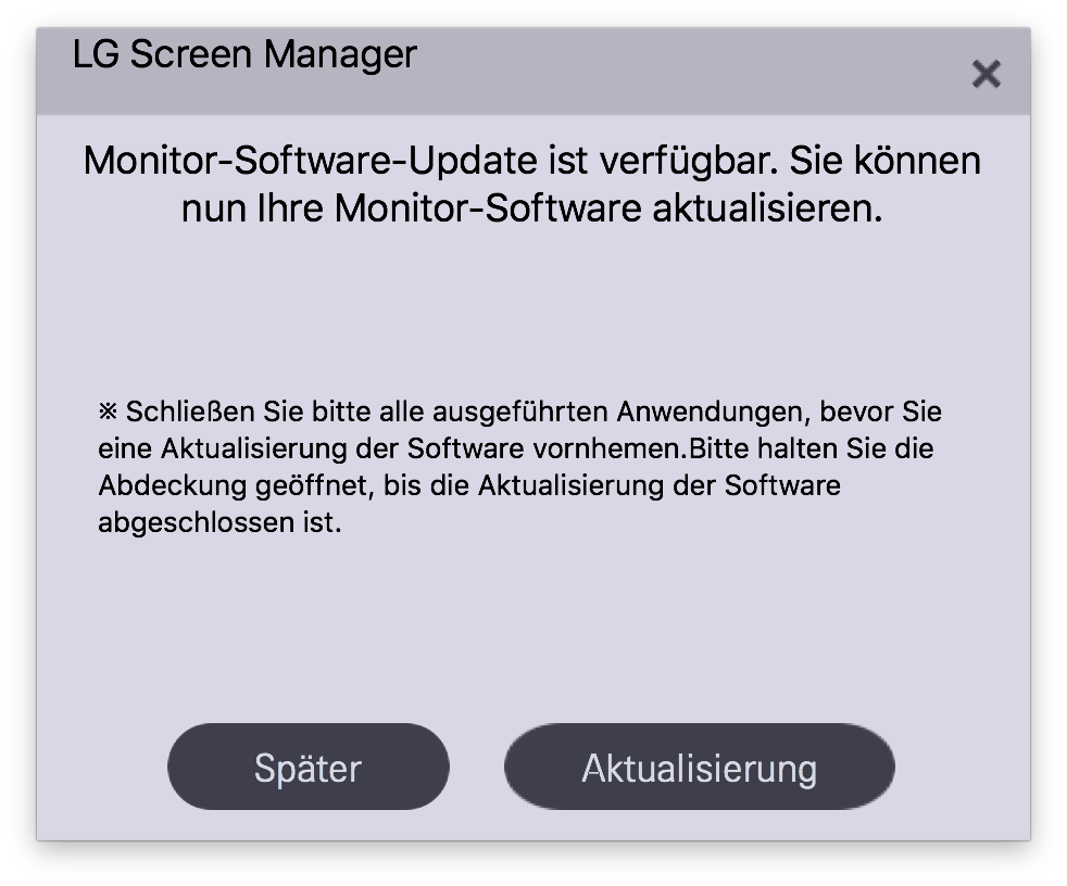

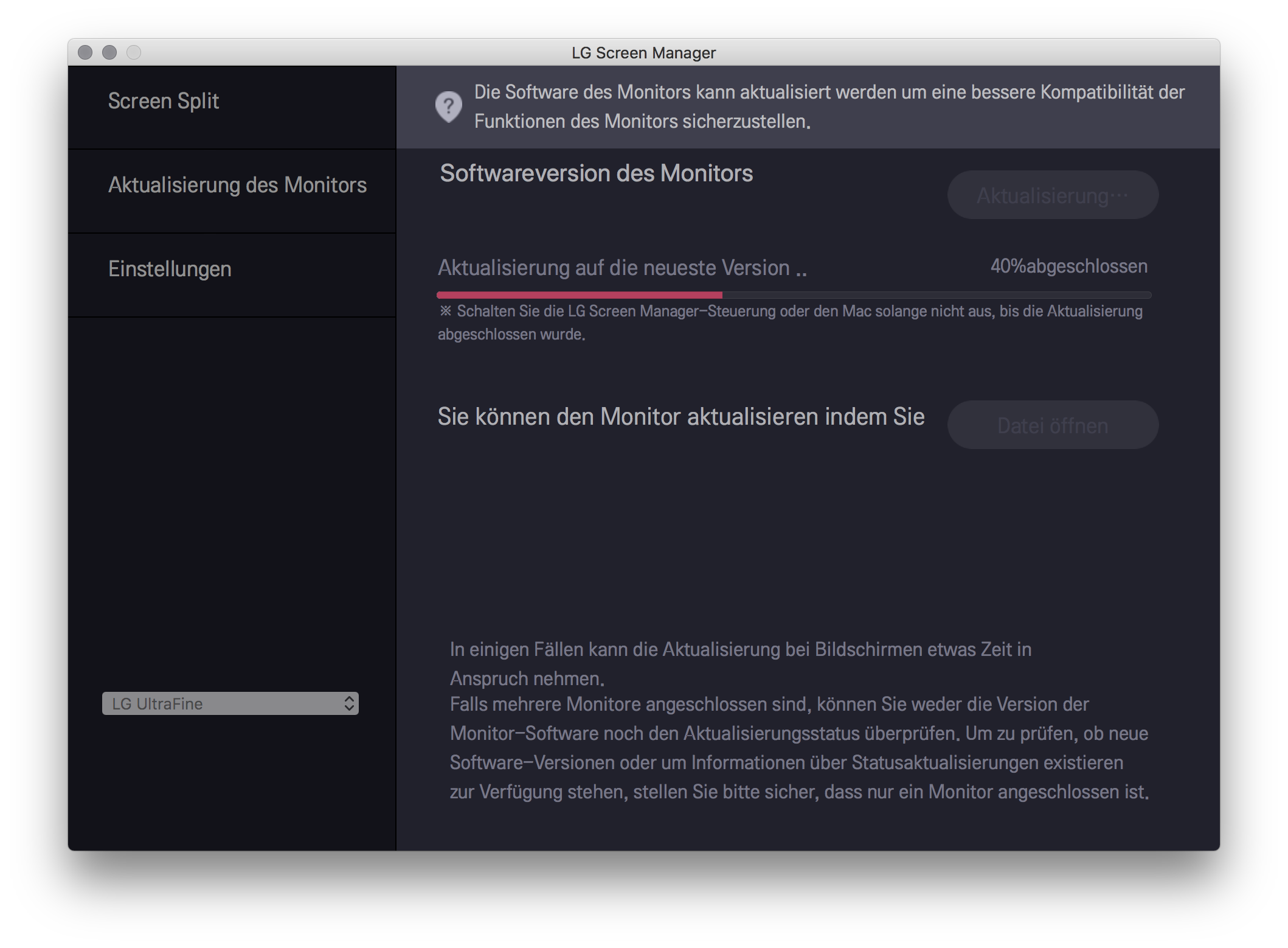

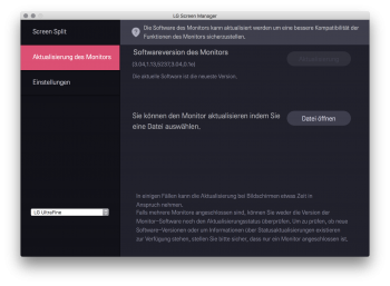

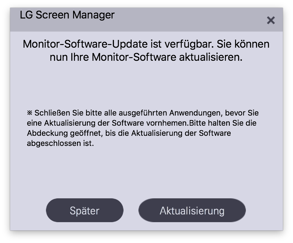

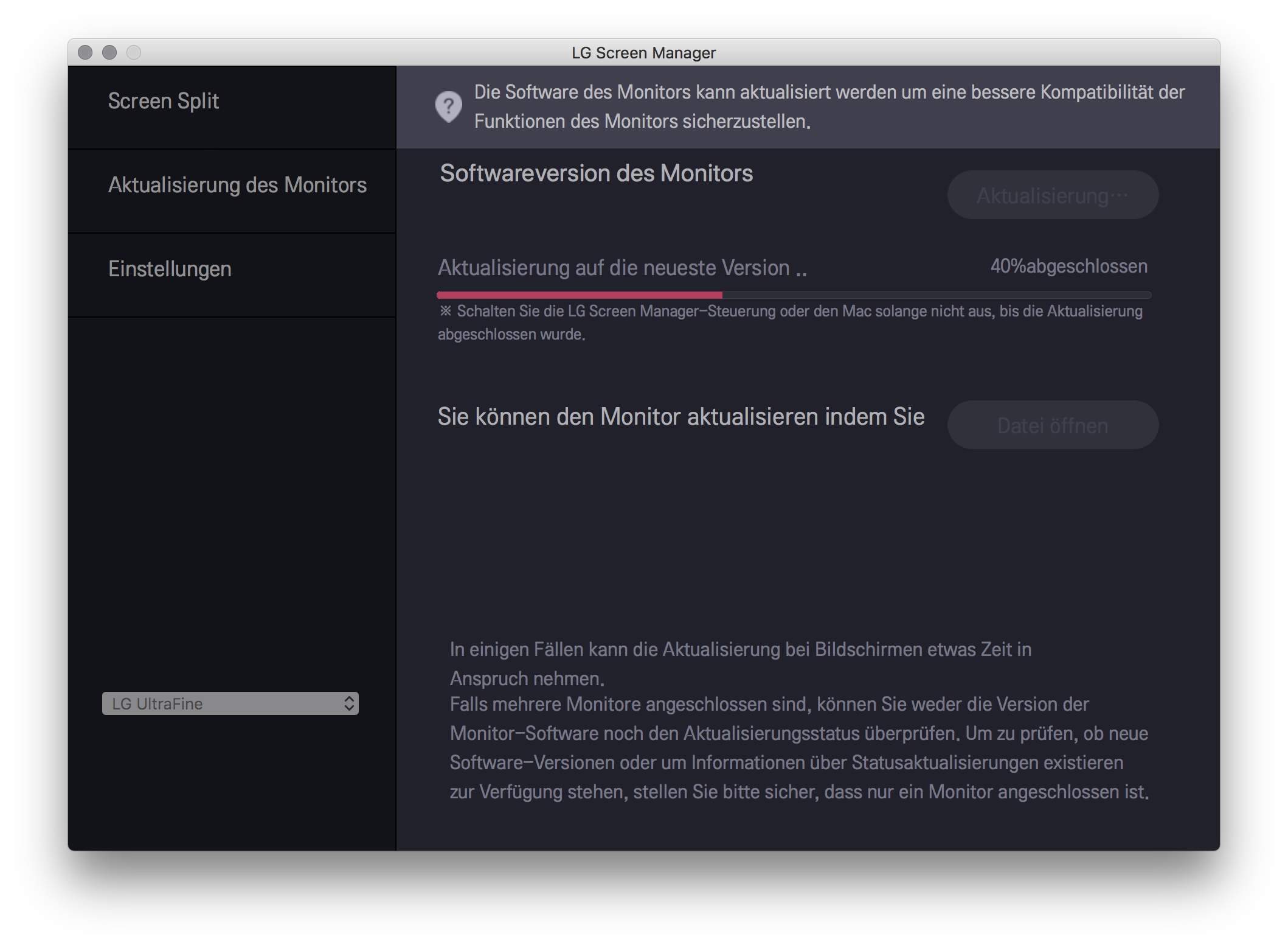

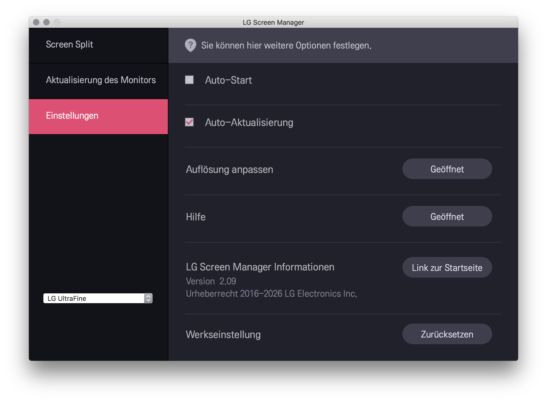

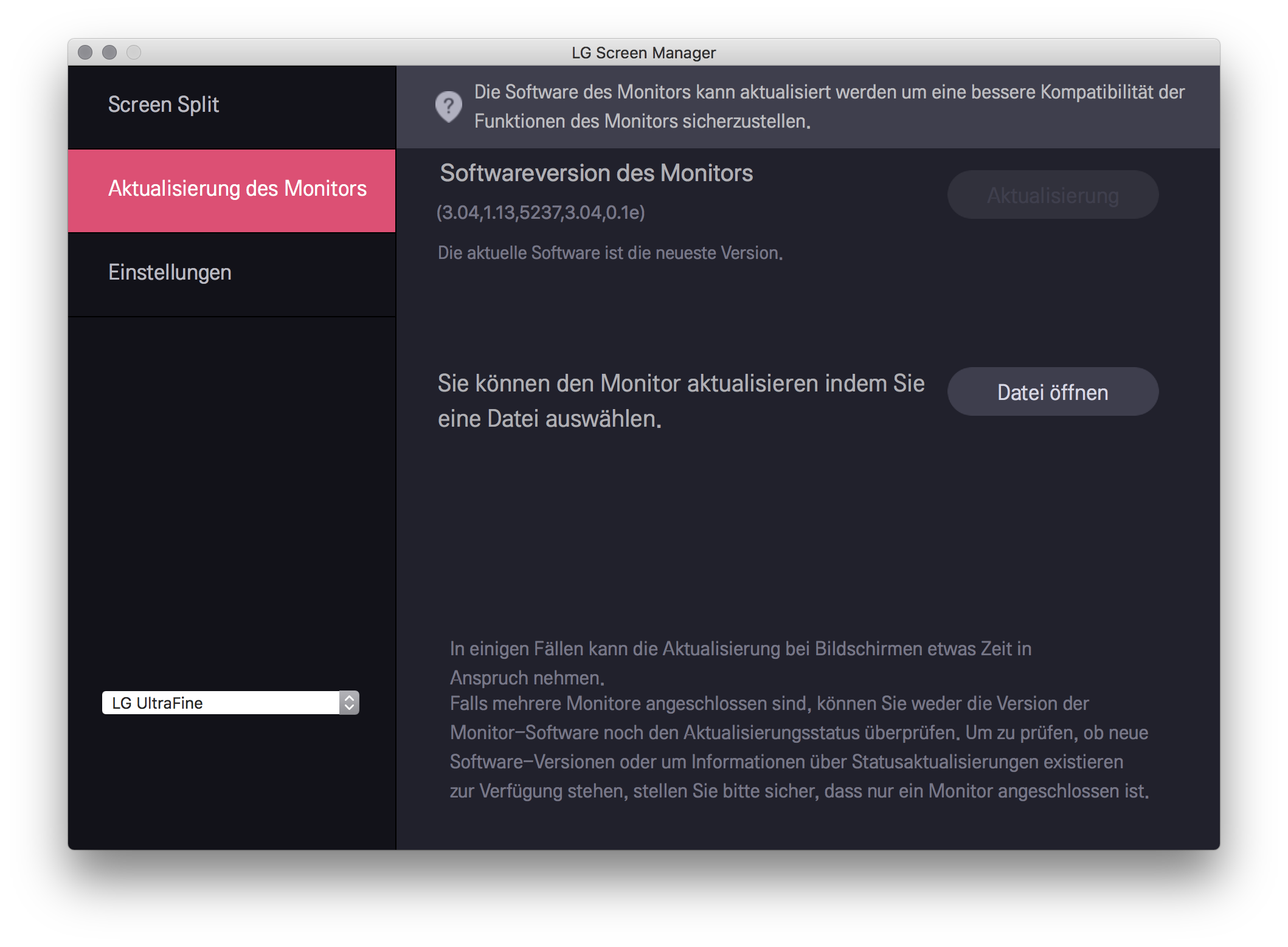

There is a new LG Screen Manager with version 2.09... After installing it I got the message that there is a new firmware. I started the procedure to upgrade and after the update I was still on the same version 3.04 tank before.
Every time I start the LG Screen Manager I get to the procedure of upgrading the firmware. But after the install it ist still on version 3.04. The most strange thing is, that after the upgrade procedure the application says I there is no new firmware available... But I know, the next time I boot the computer and I start the LG screen manager it will try to upgrade the firmware... Is anyone having the same issue there?

I installed the new versions then one at a time I used it to check the monitors for new firmware... no message at all.
I am on 3.04 was hoping for a new update....
Same here... I got the prompt for the new 3.09 version of the app and installed that, but afterward still showing firmware 3.04 with no upgrade available.
