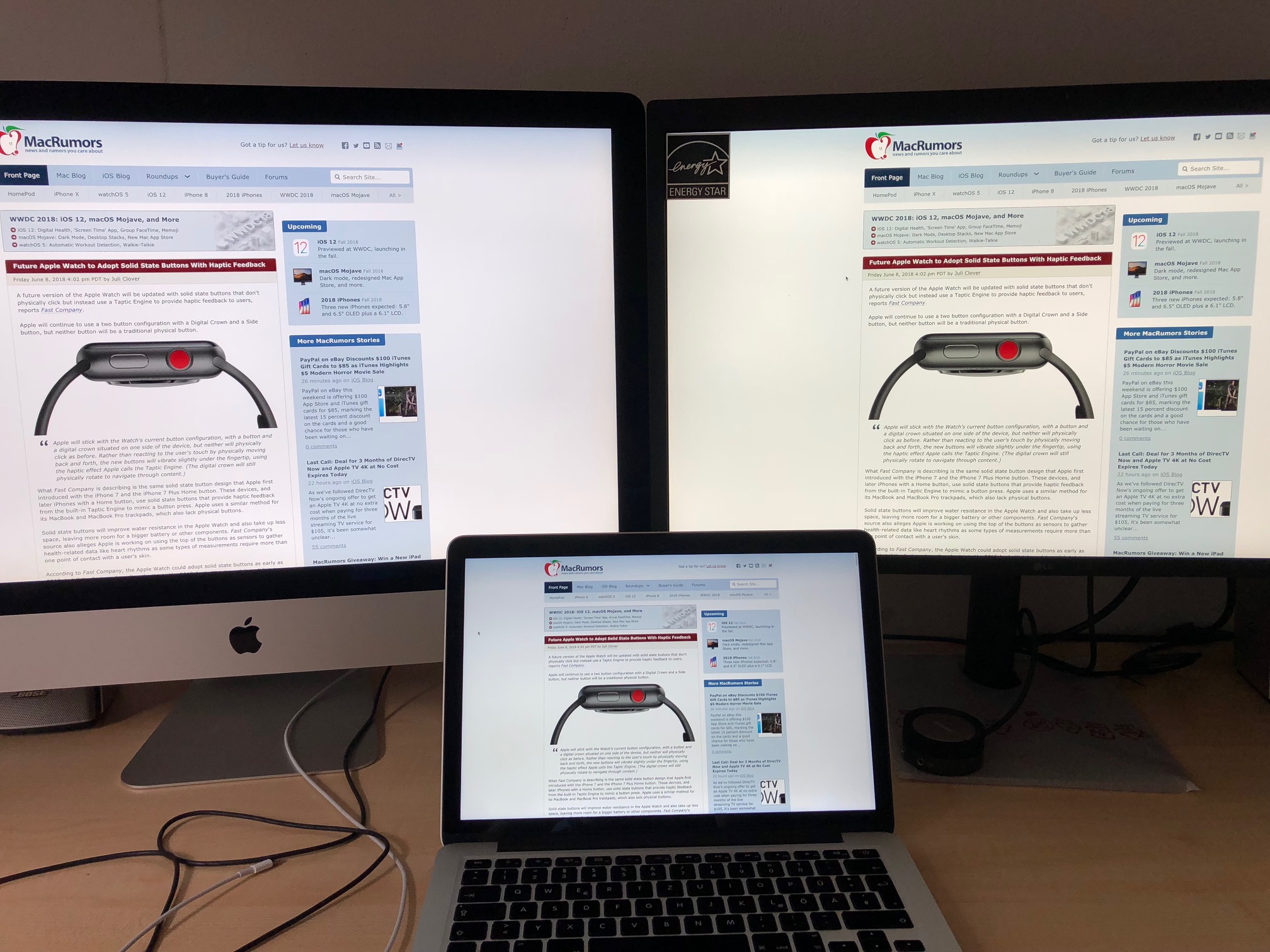

Quick question, got the LG 5k Ultrafine as second screen for the iMac 5k. The LG is clearly more yellowish than the iMac. The profile LG Ultrafine and iMac are both the same. Any adjustments I can make to have a similar view on both of them?
Pretty sure my Macbook Retina from 2014 or so is also more like the iMac than the LG 5k.
They should be calibrated pretty similarly, so - without actually seeing how 'yellowish' it appears - that sounds like a defect one of the displays, likely the Ultrafine.

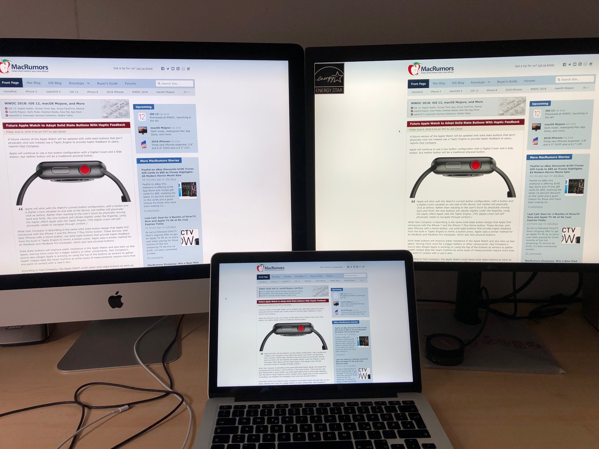

So here is what it looks like.
I had an LG 5k at home about 5 months ago and it looked fairly similar. Can anyone confirm that their LG 5k has pretty much the same brightness as their Macbooks or iMacs? I mean I would be very surprised if Apple manages to ship defect Ultrafine in 2018.

They should be identical, as it's the same panel calibrated in the same manner. Panel manufacturer, as always, is not perfect, and it's totally plausible that yours just has more yellow than standard. Are you within the returns window? Return it, get another, I'd wager the replacement will be different.

Tint: Calibrate both of your displays with a colorimeter. That is the only way to achieve perfect color between both monitors.

When it's heavily tinted with yellow or pink display, no way you can calibrated properly. The only time calibration works is when the color temp is off by default. The yellow and pink tint is something else, not the actual panel display color.

I can confirm the handful I've used have had yellowish tints to them, nowhere near the iMac quality. you can really tell on the menu bar and window menu bars its more of a nice blueish hue where the LG is yellow and not as macOS-ish.
calibration did nothing for them either. sort of the luck of the panel.
