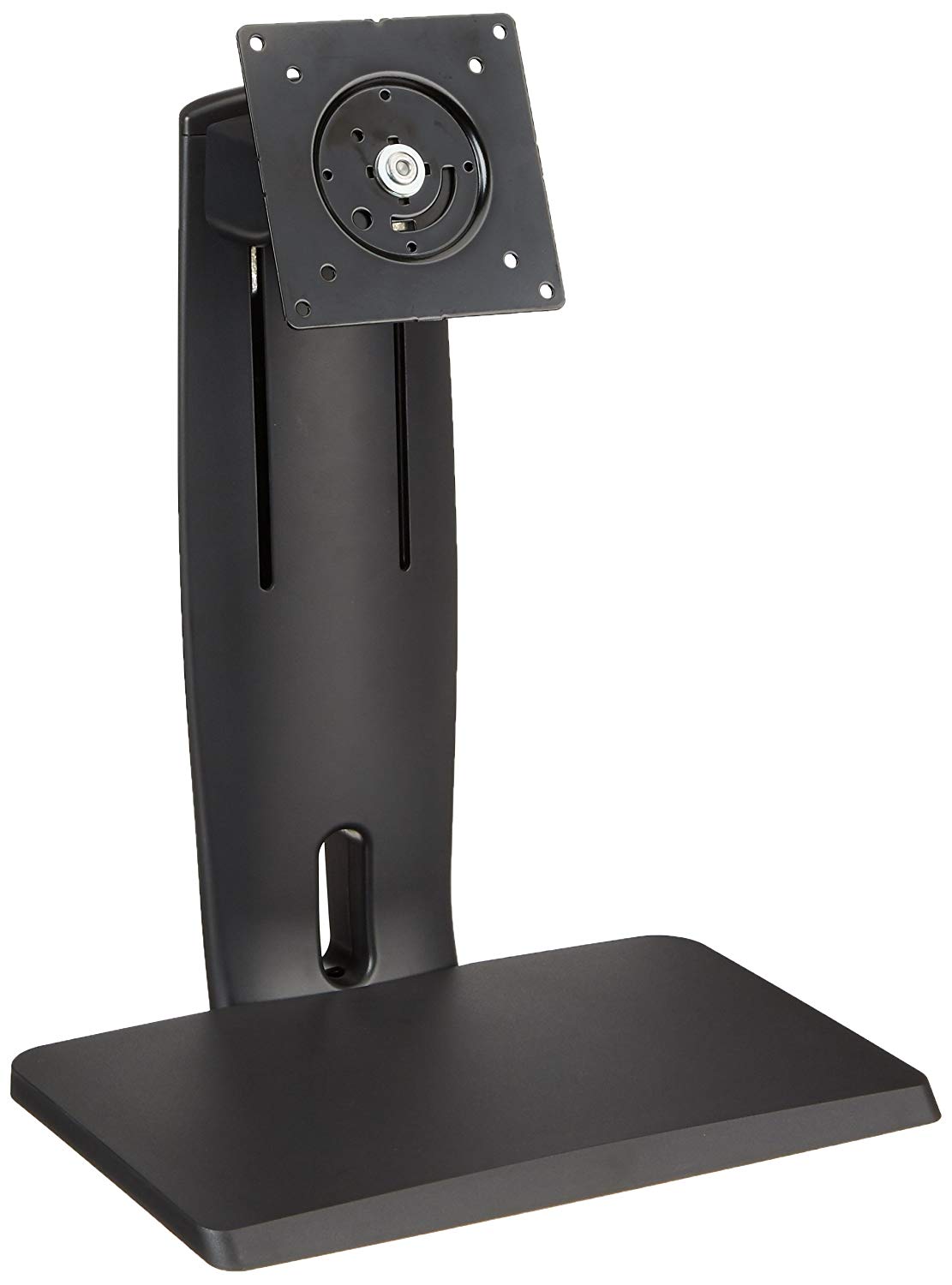

Anyone have suggestions for a third-party stand they're using or considered?
https://www.amazon.com/AmazonBasics...ords=vesa+stand&refinements=p_89:AmazonBasics
Amazon Basics has one for $37 that looks like it would do the trick for you. I have not used it myself, but the reviews look pretty good.

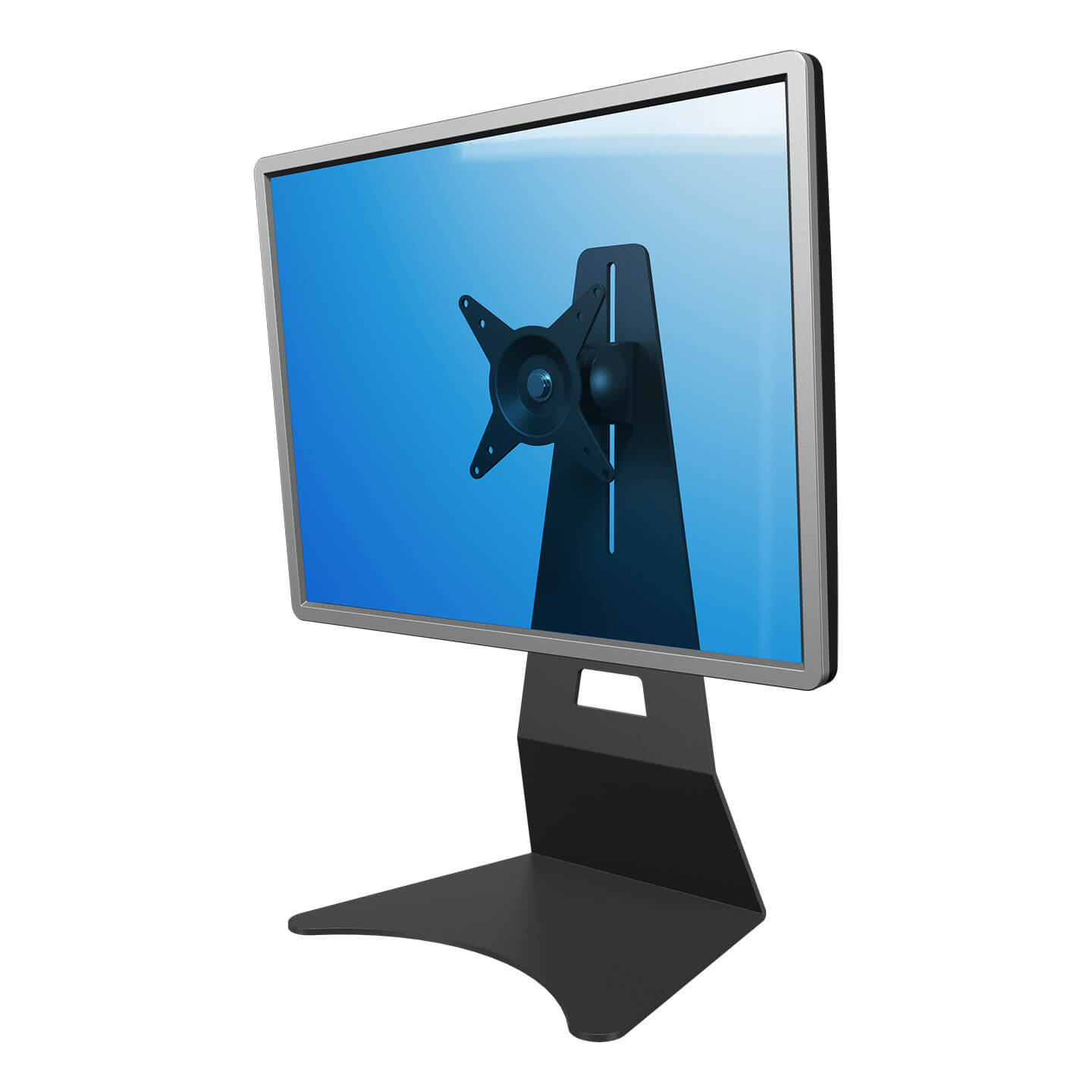

https://www.dataflex-int.com/en/product/addit/monitor-stands/desk/addit-monitor-stand-50/52.503
Something close to this style would be nice.

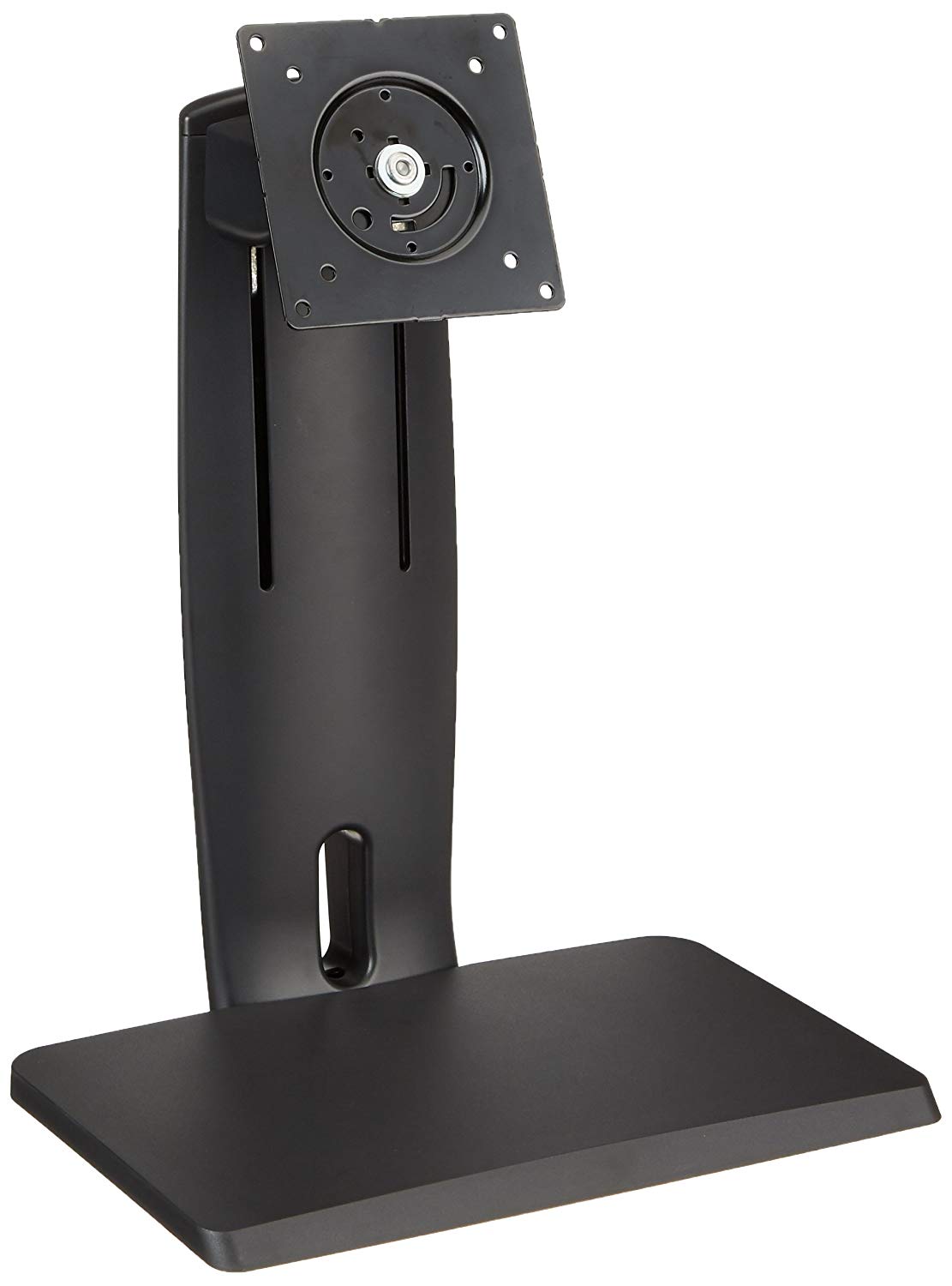

[doublepost=1542989680][/doublepost]https://vivo-us.com/products/stand-v001v
This one is an immediate buy...but, oh wait. What's with the stupid Chinese companies needing to screw up the aesthetics with their ugly logos having to be visible on the product!? Every **** company finds a need to take it and embellish the god-awful translation from something in their own language. I think I'd just rather see their own non-translated logo in their own language as opposed to some translated "Techno-Babble" name. Clue to marketing department: If your logo looks like garbled Latin characters, let's just hide it on an discreet label that's not visible in normal use.
