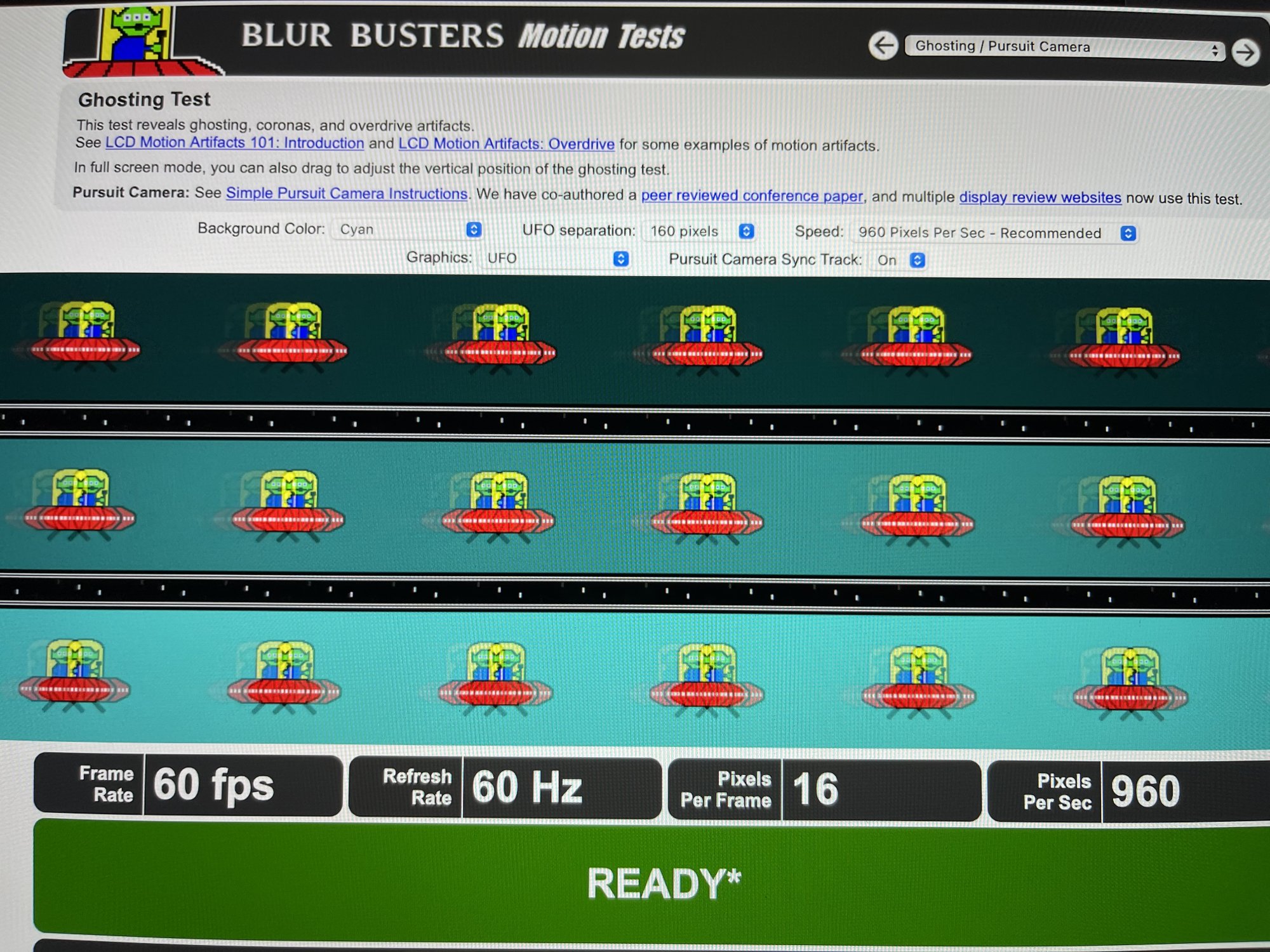

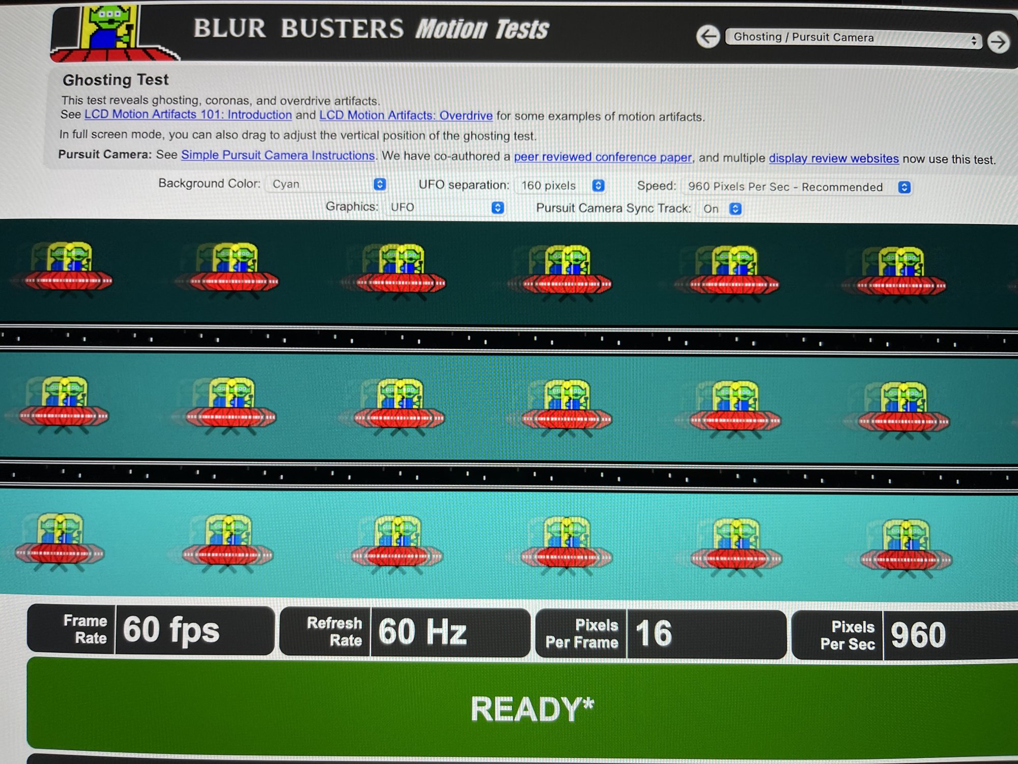

Thanks for posting. This looks fairly similar to the vertical lines I had. Interesting to know it happens on a modern, presumably perfect-functioning display.
My M1 display glitch has been one of the trickier computer problems I’ve ever debugged!
I think this -might- have something to do with display image sharpening (or at least the signal processing in the display) clashing with the output from the Mac. I changed the setting of the sharpening on the monitor and it obviously had a certain effect, because alternating between two values - for instance 20% and 30% would produce the lines or not. However I didn't find a value that would completely get rid of this...
