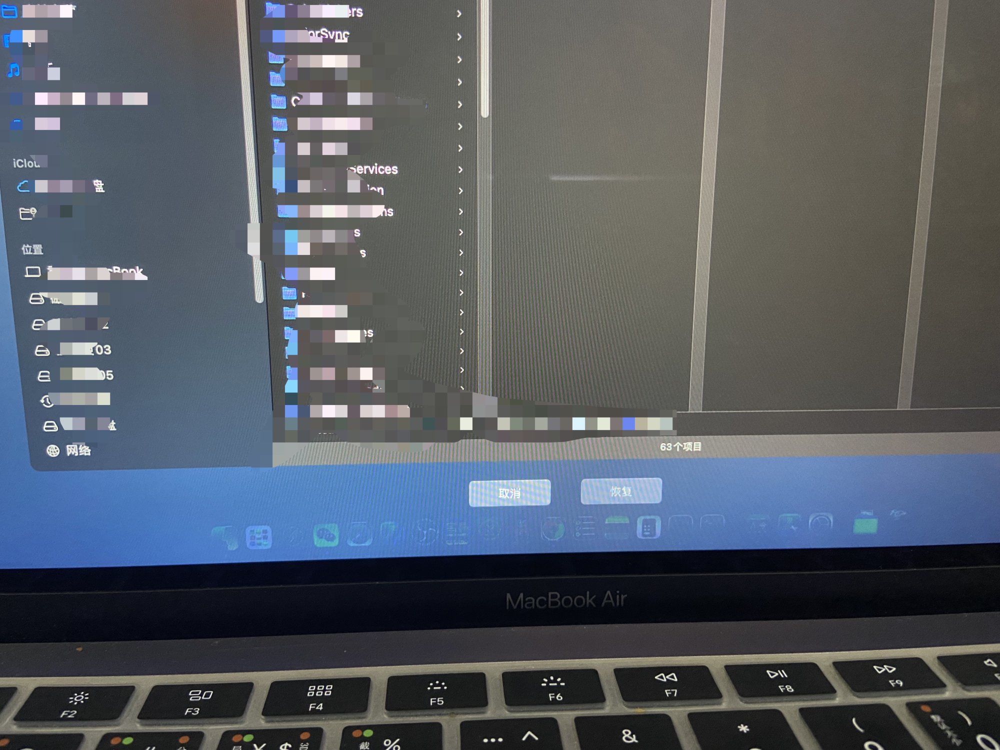

haha my main screen is broken. macbook air m1 8G 256😵

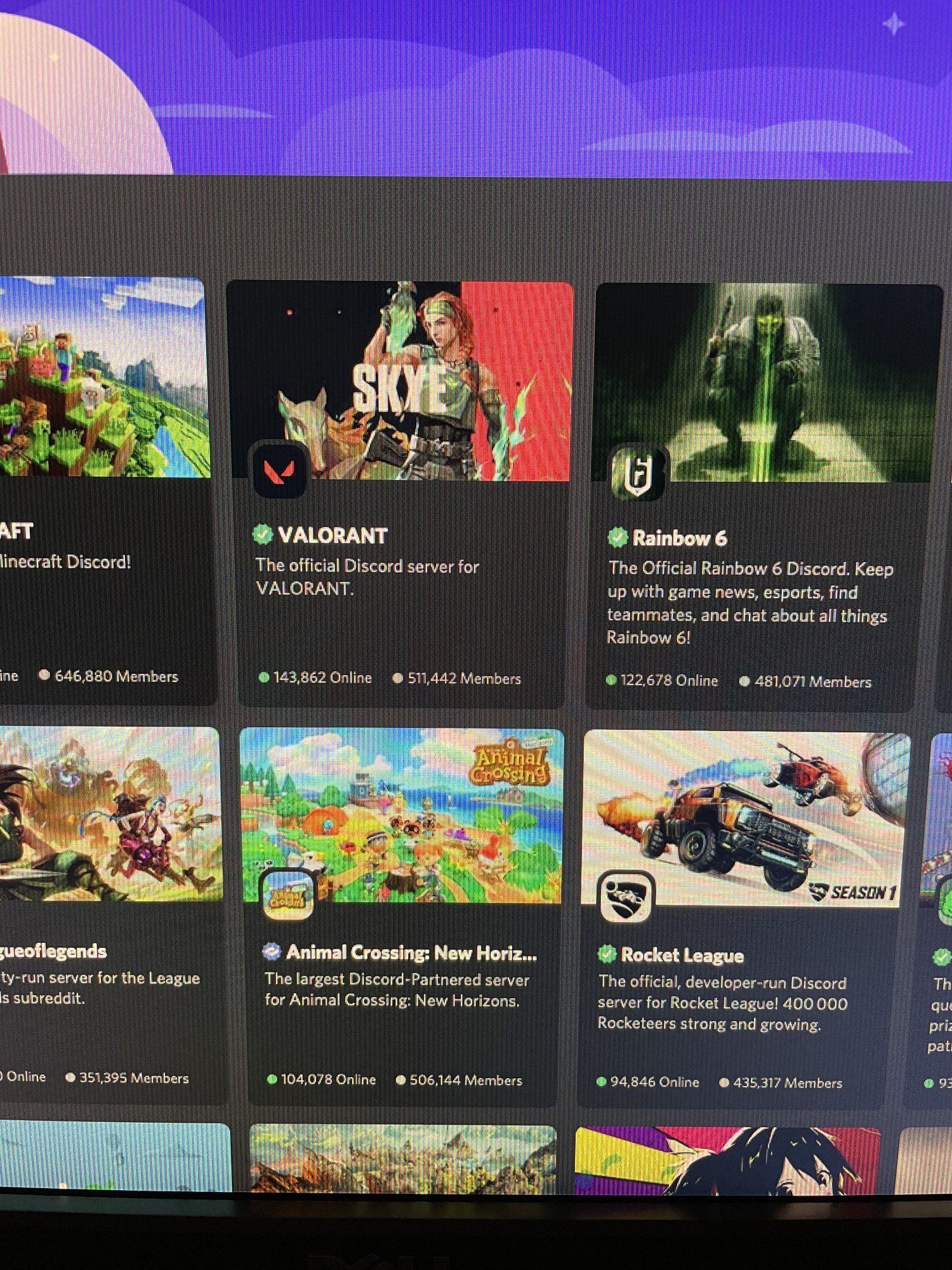

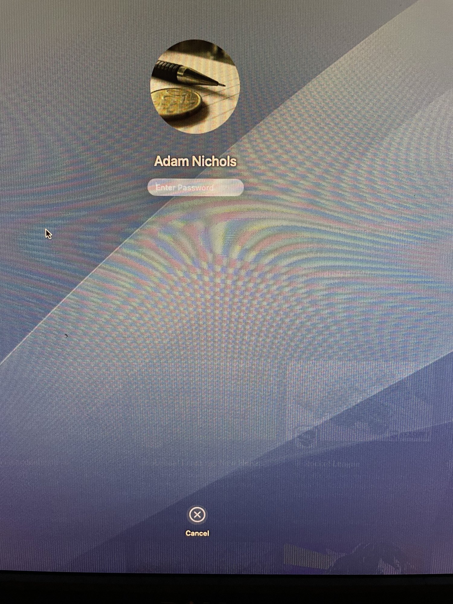

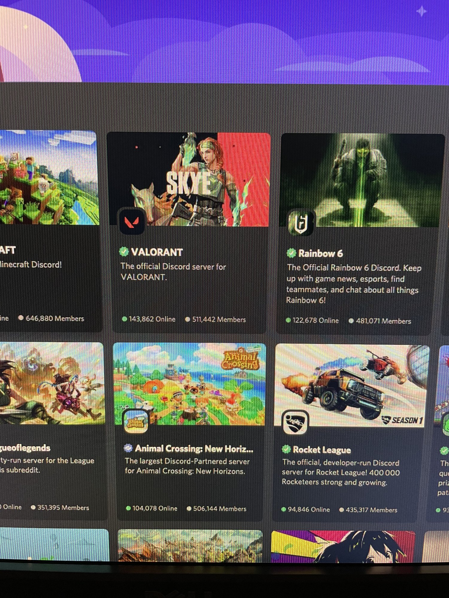

My M1 MacBook Air has a serious problem with external displays. Pinging the brains here in case there are any ideas more convenient than sending back to Apple.
Connecting directly via a known-good USB-C to DisplayPort cable, my Dell U2713HM (1) flickers, (2) shows vertical lines, and (3) mixes together previously-displayed frames with what should actually be on screen.
That last issue is the easiest to photograph. If I look at Discord and then lock my machine, a ghostly vestige of it shows through on the lock screen. This happens even if I quit Discord entirely, so it's not some sort of transparency effect:
View attachment 1679809View attachment 1679808
