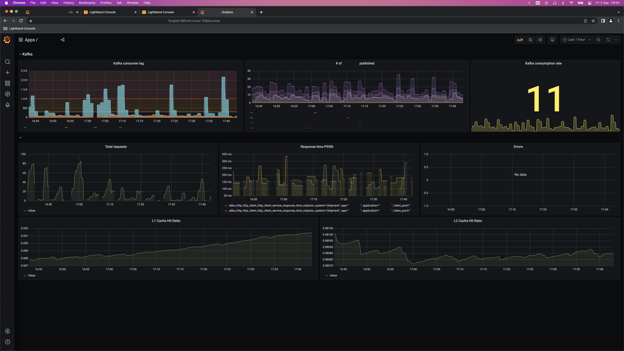

Hi. I've been struggling with this issue for quite long and found many opinions that this occurrs randomly. In my case there are several pages that have almost 100% chance to cause flicker/retention. I attach a full resolution screenshot as an example. Seems that this color + multiple vertical lines are more likely to force this issue. I'm currently using BenQ PD3220U. If you have the same problem and Apple says they are not able to reproduce it, send them this.

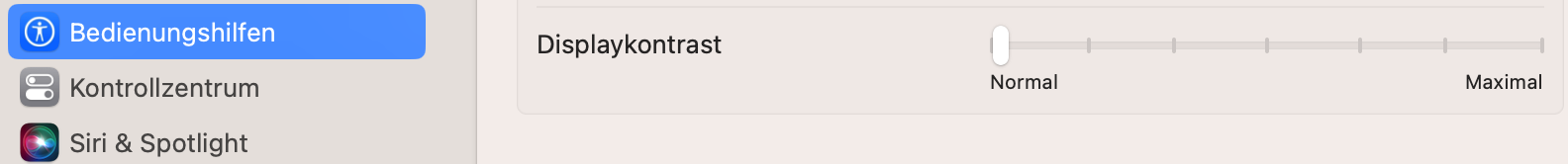

Hi,
this worked for me (Mac Mini M1, ASUS VP28UQGL):
In the Mac OS settings, in "Accessibility" I dragged the "Display contrast" slider just a TINY bit to the right.
The picture shows, how far I dragged the slider, it's barely over the "normal" mark.
Now, with the display contrast active, the problem is gone and the colors aren't altered in a noticeable way.
When using apps, that would normally trigger the flickering / vertical lines instantly,
I can only see the phenomenon develop at a very early stage now, almost not noticeable.
I only discovered this today, after 14 months of fruitless attempts to solve this annoying issue,
so I don't have long-term experience if it will stay this way.
Possibly, it's a solution for people with different monitors as well.
Kind regards,
Chris
EDIT 4th Nov. 2022: A few days later, it turned out, this is only a partial solution.
The vertical lines issue was rather shifted to other apps that didn't induce it before.
I'll use the display contrast function only, when an app is unusable otherwise and turn it back off for most of the time.
I have owned computers since 1998 and never experienced such persistent display issues with any machine I had before.
EDIT 2, 6th Nov. 2022: Activating the "Reduce motion" option not only made the overall experience with the OS
a bit more snappy, it seems to also have a small effect on how often the flickering and lines appear.
Another good advice might be daily power-cycling of the whole setup, i.e. turning off the extension cord with power switch for a few minutes.
The Mac Mini M1 in general is a great computer, I really love to use... when it behaves well without hiccups. 🙂
