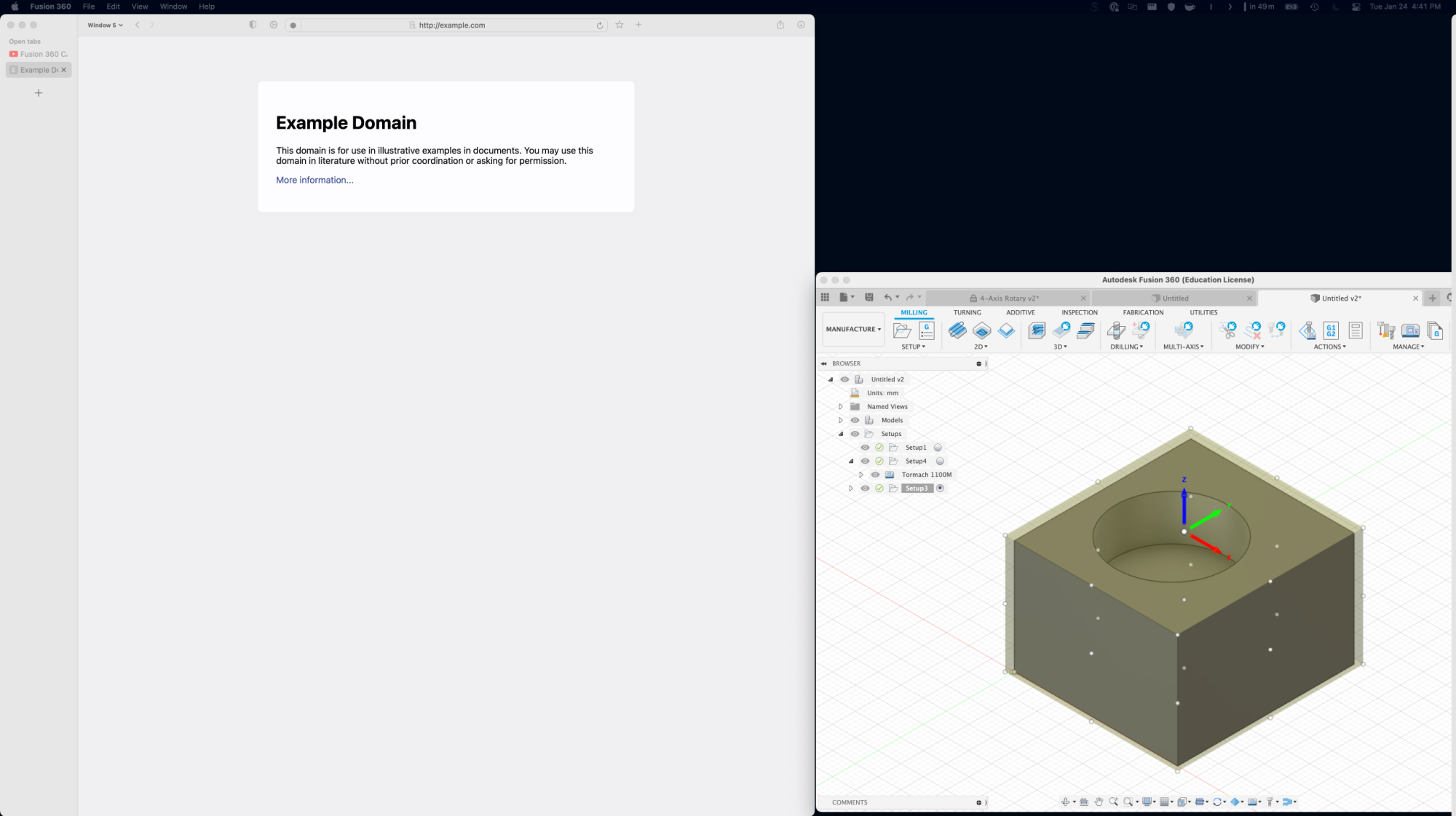

So disabling DDC/CI didn't fix it on my machine, it just reproduced.
Have some further notes:
1. It's 4:40pm, which is late enough in the day that truetone is putting on it's yellow tint.
2. Truetone is enabled and is yellow tinting. Disabling trutone removes the yellow tint and the flicker.
3. Flickering is highly dependent on the location of windows, and somewhat on the content displayed (hard to tell).
See my screenshot and video.
Flickering only reproduces when the fusion360 window is on the bottom right side. And _only_ reproduces when the browser window (orion) is larger than 50% of the screen, and is close to the fusion360 window.
Interestingly on macrumors itself whenever a modal is shown (e.g. dragging the image around this post, or in the upload dialog) the flickering intensifies.
This layout reproduces flickering. And in the video you can see that if I move the windows around flickering gets enabled / disabled.

I can do some more testing tomorrow, hopefully this state reproduces the issue reliably and it'll allow experimentation.
