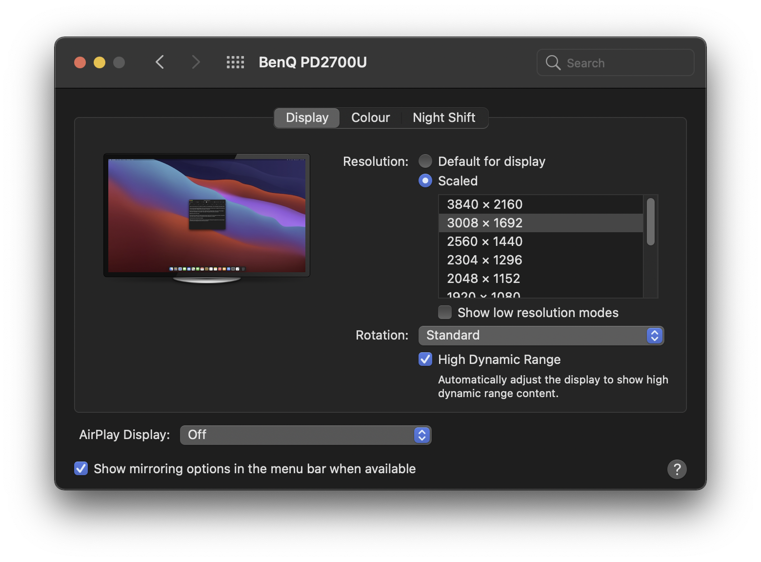

M1 can 'only' upscale to 6016x3384 (and subsequently downscale to max 3008x1692 through USB-C or max 2560x1440 through HDMI), so what you suggest is not an option, I think. Maybe with M2?

I run my MBA on a 32" 4K at 3008x1692 (or whatever it is; not in front of it at the moment) and 2560x1440 with zero issues whatsoever.
How bad fonts look if you run it at 3840x2160 native? I understand fonts get small but I'm interested do they look as fuzzy as in 2k monitor at native resolution in MacOS?
