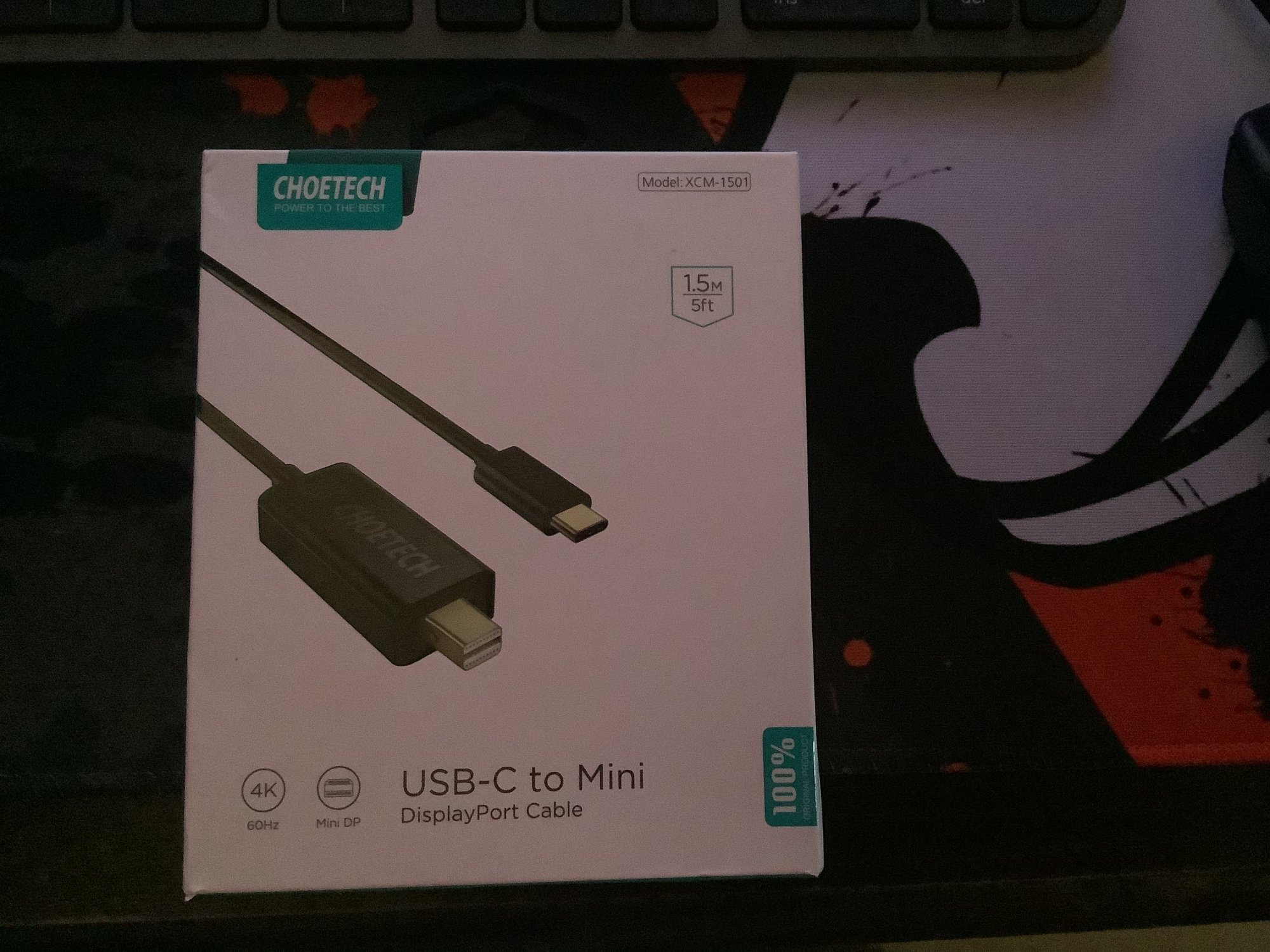

I have similar cable, although its USB-C to mini DisplayPort.
It's not working for me, still outputting YPbPr connecting M1 Mac mini to Dell U2713H.
