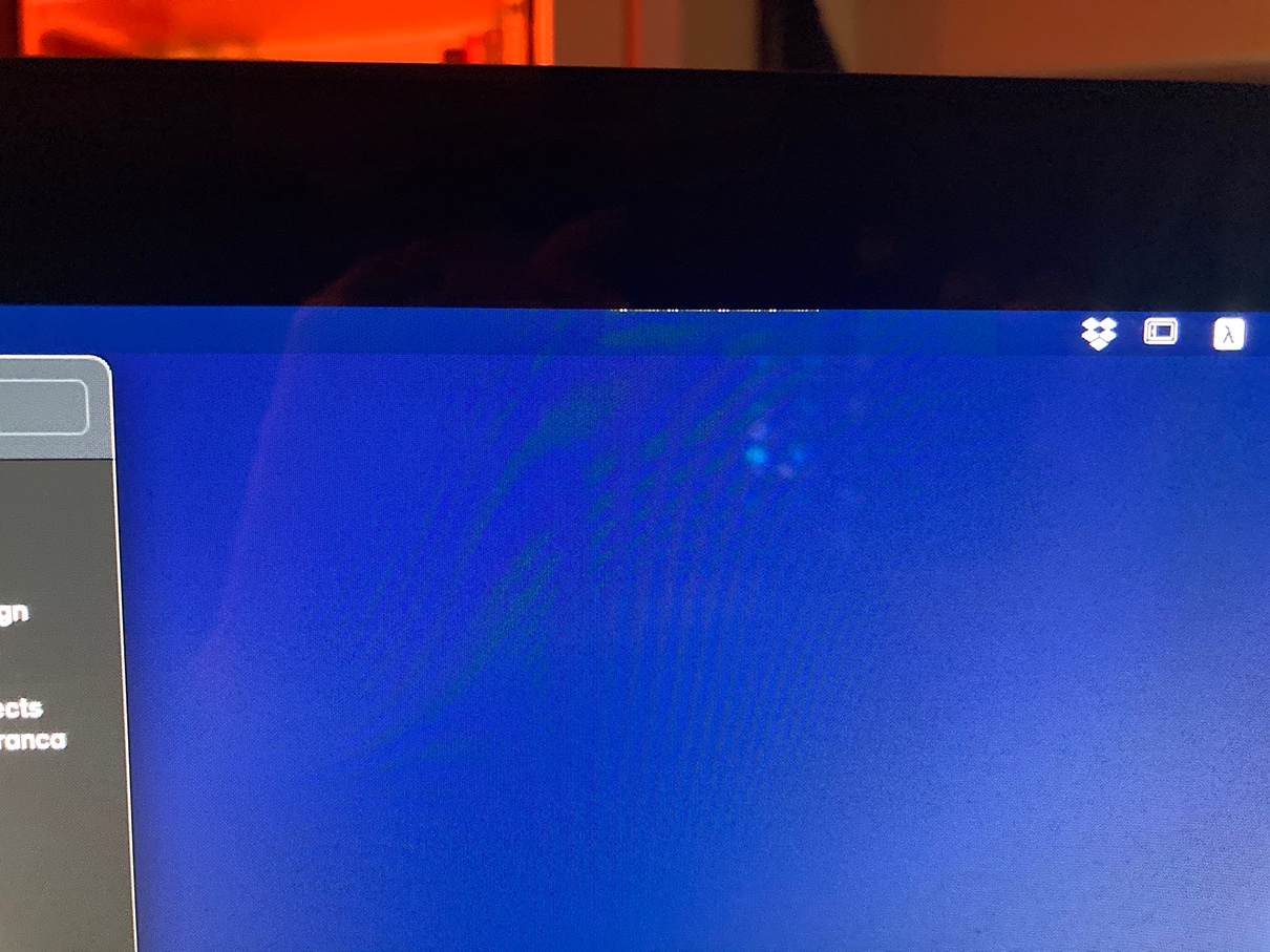

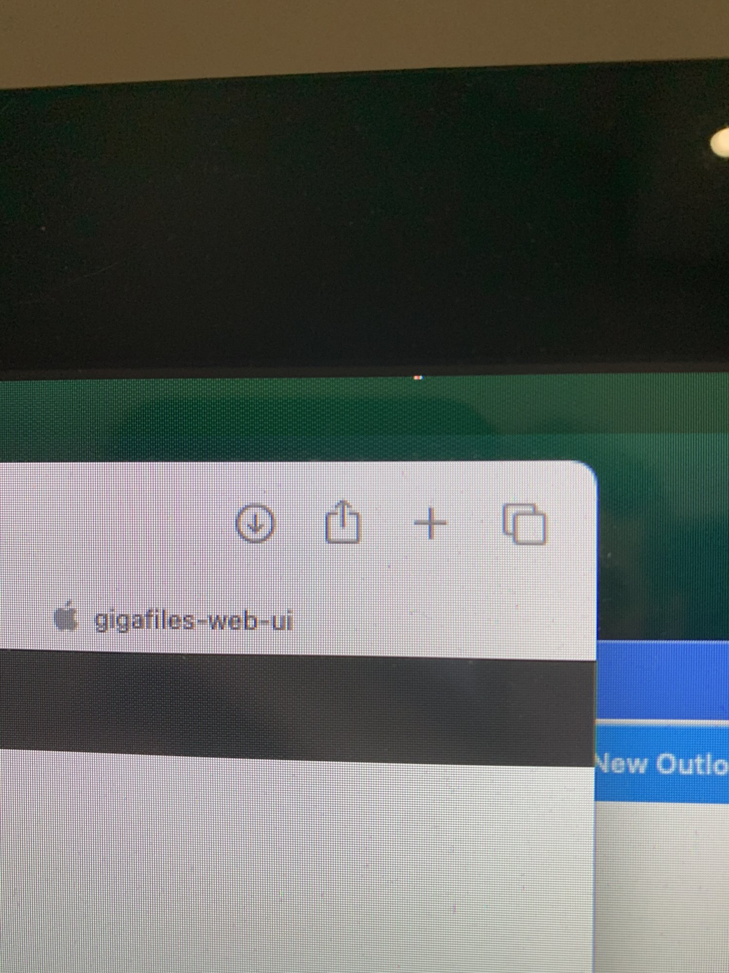

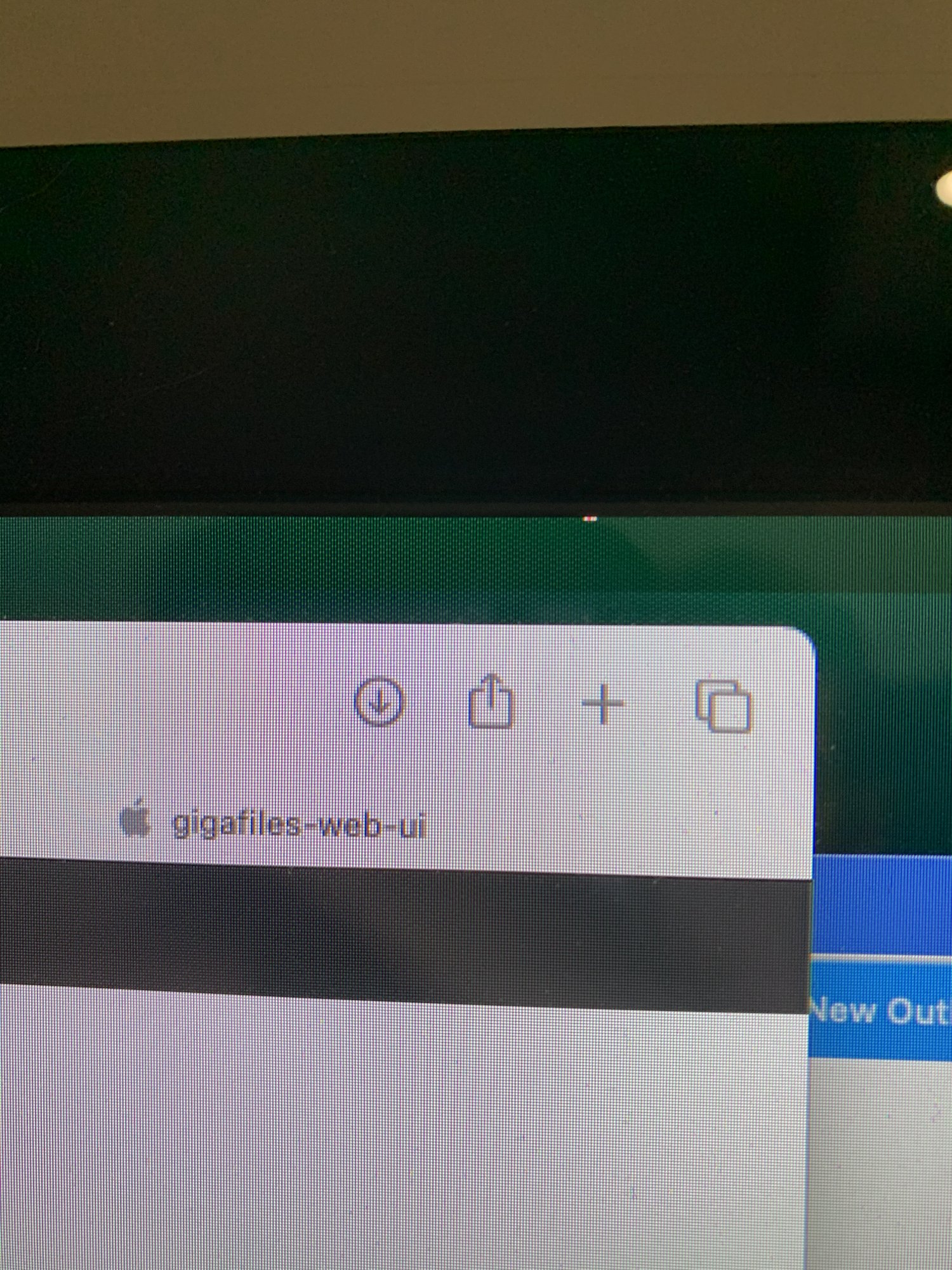

I was just wondering if anyone has any ideas what's going on with my M1 Mac mini. I have the following pixel shifting at the top of my display
(See Attached)
This isn't visible though on my other monitors / tv.
Your probably thinking well it's the thunderbolt then. Well I connected my two other MacBooks to this exact display and they don't have the weird pixels either!
Any advice would be welcome my friends!
Thanks

Try a different Thunderbolt cable. You can actually plug the laptop into the empty TB port on the back of the display and it will work. Internally, the attached Thunderbolt cable and the Thunderbolt port on the back of the display are interchangeable.
If you're using Apple's TB2-TB3 adapter, see if you can borrow another one and try that. Even though you say it works on your other machines, perhaps your new mini is more picky.

The weird thing is everything was fine until recently. It's what kind of makes me think an update has done this or my Mini is faulty!

I've already tried them on my MacPro, on my iMac and on my wife's laptop and the glitch isn't there, this is specific to the Mini M1 it seems. I've also spoken with the monitor technician at my local store who said that misalignment glitches like these are typically monitor firmware or driver problems. We reported it, let's hope Apple is motivated enough to have a look at it.
