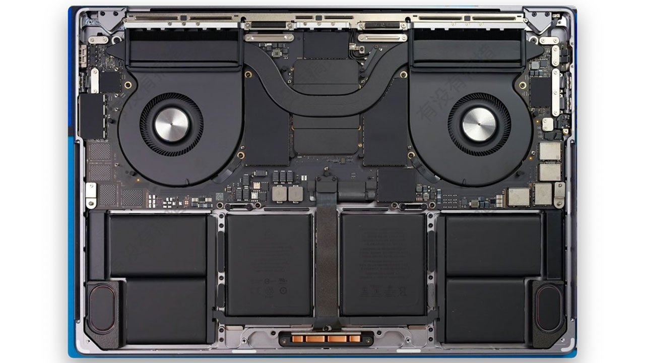

How do you know those are C and not F? I have Macs Fan Control, it reports in F (You can choose C, I presume), and my fans kick on at 150 F and ramp up, temps never get above 165 F
correction, that was the Soc sensor, the performance core stays at 200 F

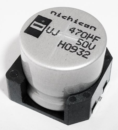

LOL. To an actual engineer (I am one, if that's not clear), that reddit post can be translated from the original naive thusly: "A defective electrolytic cap short circuited itself and did the things you'd expect - made a popping noise, maybe arced a bit, released the magic smoke.

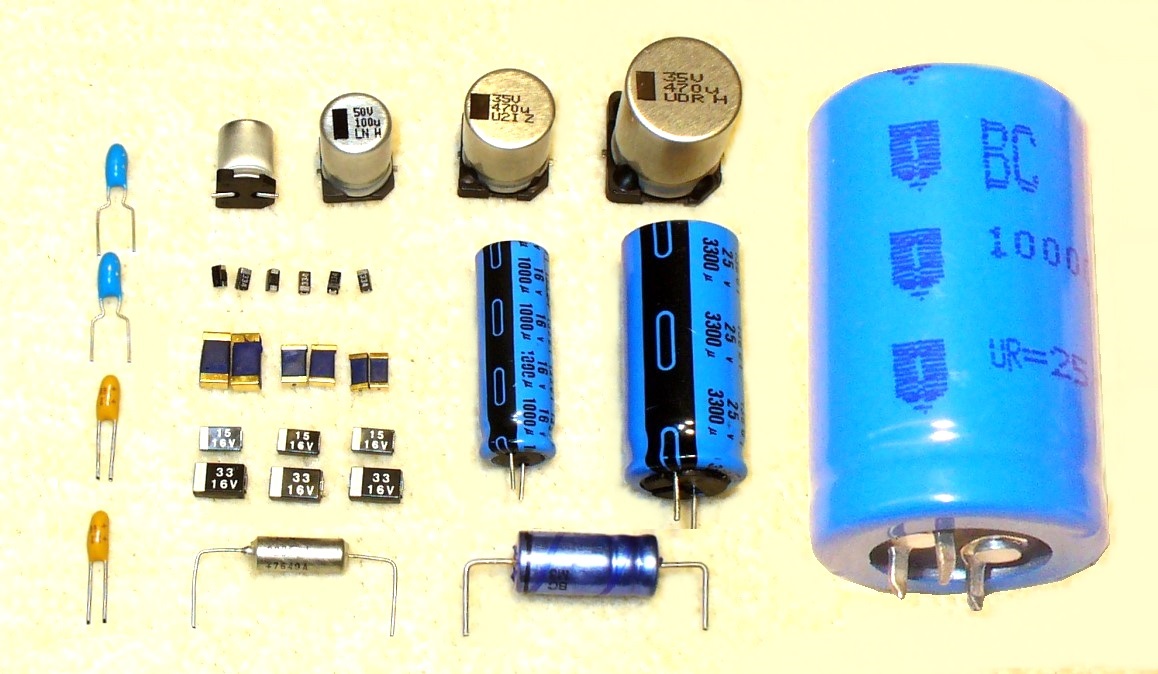

Where do you see electrolytic cap on the motherboard? Even a hobbyist knows the difference between an electrolytic and ceramic/tantalum.
Here's a pic of electrolytic cap to help you.
Oh mi7chy, you never fail at delivering cringeworthy attempted owns.
Cylindrical aluminum electrolytic capacitors are not the only type of electrolytic capacitor. Please go educate yourself on the basics of what "electrolytic" means:
There are several low-profile (probably tantalum) electrolytic capacitors in clear view in the MBP motherboard picture you posted.

Stop with the BS. Through-hole electrolytic hasn't been used on Apple computer motherboards for quite a while since like the Apple II days.
What?! I said nothing about through-hole. You, on the other hand, are in a deep hole that you have dug for yourself, and you should probably stop digging...
