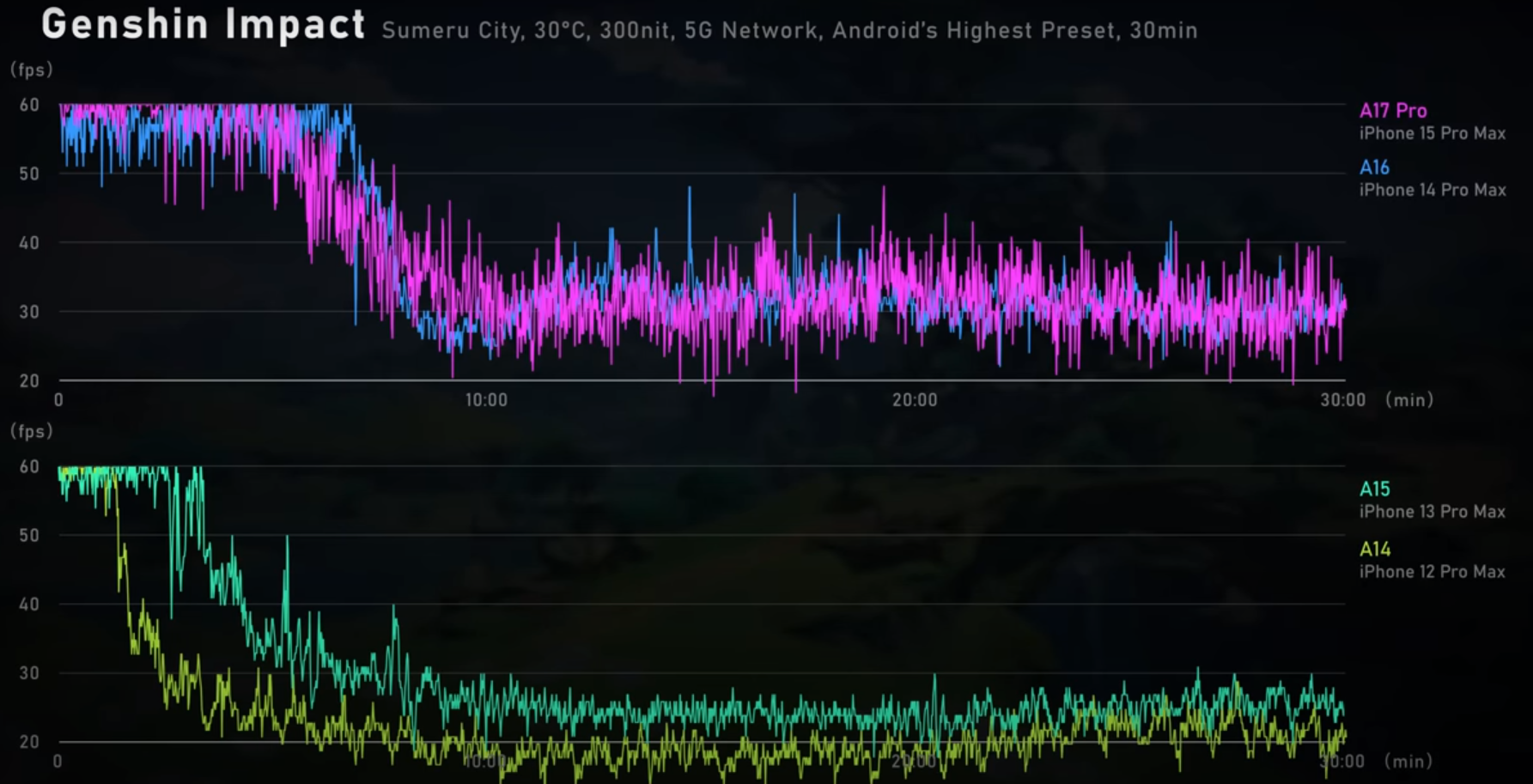

I doubt that having higher heat dissipation is detrimental. What would be the implication of the phone having better heat dissipation? Aren't heat dissipation and SoC consumption orthogonal?
Gamers (especially these sorts of games) are obsessed with the idea that what they lust after represents the entire world. It doesn't even represent the world of GAMING! Look at the real hardware that's most common on Steam.
Apple are willing to play along with this fantasy to the extent that it doesn't get in the way of real customers, but no more than that.
Which means they care a LOT about making sure the A17 works well when playing Candy Crush. But they are not going to increase weight, cost, or anything else, PURELY to make Genshin Impact behave differently. Hell, we all know that the people who truly care about these sorts of games will in fact invest in hardware to prevent this. Either they will mount a cooler on the back of the phone, or they will hook the phone up to a TV and blow a normal fan over it.
The iPhone is a phone FIRST. The fact that it can be used (with some rather minor hassle) as a console is a bonus, not the design point...

The problem is they also opened up a use case mode where getting power delivery from an external display. That whole run it like a console gaming system set up is likely a path to some screwed up phones over time.
The fact the self regulation subsystem doesn't stop things before they get 'horrible high' is a dubious design choice ( if not a defect. ) . If developing this for 'bursty' activity then it should shut down when timeline for a burst should be over. 15-30 minutes is not a 'burst'.
What do you imagine to be the failure mode here?
Presumably Apple stops the phone before it hist danger temperatures AND presumably Apple stops the phone before it hits battery current limits.
So your belief is Apple should throttle the phone just because?

If you can't even explain what you tested and what your "efficiency" score refers to, no-one is going to take you seriously...
Maybe spend some time first reading the room and reading the thread? This is a thread for people who care about engineering, not for d**k-measuring.
We only have a few measurements of power consumption and its from Geekerwan so you dont have to investigate much to know what benchmarks im refering to, my Snapdragon 870 with Android 13 debloated and undervolt on GPU makes 3000 points in Geekbench 5 with 4w power consumption, A17 Pro makes 6200 points geekbench 5 with 14W, it makes about 5600 points too with 9.5W consumption. In GFXBench 1440p aztek vulkan I get 25 fps with 2.8w the A17 Pro does 64 fps with 11.5W.
Its only when you activate low power consumption that it gets better efficiency numbers
This sounds like a wild guess. How do you know your measurements are accurate? How do you know geekerwan’s measurements are accurate?
You can doubt about every benchmark run, I had my doubts too but just by feeling how hot the back of the phone is it makes sense, I thought if its taking the consumption of the soc only, but if i increase the brightness of the screen it increases the consumption, Geekerwan supposedly tears down the phone and simulates with a digital power supply the consumption, but I think that in the 15 PM review he used software telemetry instead.
The thing is this SD870 makes 750 points in multicore GB5 per watt, but the A17 Pro in low power mode makes about 1470 points per watt, about 590 points per watt with 9,5w and about 440 points per watt using 14W
Sorry if I missed it, can you clarify how you are making these measurements?
As for Geekerwan, it seems as though they cooled the phone, allowing the power to hit a level it wouldn’t be able to normally. If you look at other tests, the phone doesn’t hit anywhere near 14 watts.
There is an app that gets you an overlay where you can get performance data, I can get the power consumption of the battery all time. Geekerwan did another measurement without cooling 5600 points and 9.5w, its still less efficient.
Right but we’re talking about the power consumption of the cores, not the battery. Battery consumption will take place as a result of power use by a variety of components within the phone.
And as I told you, its the battery consumption, not SoC, I can increase the power consumption just by increasing the brightness of the screen, or if i get it to the minimun it lowers
I think perhaps there is some miscommunication. I realize you are referring to the battery consumption. That’s the issue. The topic is core power consumption: that is what you should be measuring, otherwise we have no basis for comparison.
But Geekerwans test the battery power consumption, originally he used to remove the battery of the phone and puts a digital power supply and gets the consumption figures from there, but in the 15 PM I think he used software telemetry as I did, If he got core power consumption is even better for me because I get the core consumption + the rest of the phone and It still beats the A17 Pro in efficiency
You can’t speak meaningfully about power consumption if you can’t measure it. It seems like you can’t measure yours, and it remains unclear if and how Geekerwan measures it.
We need to speak about efficiency at a given performance level. You may think you are more efficient because at a lower score you use less power than an A17 at a higher performance level, but you don’t know how much energy the A17 expends to match your performance, and just as importantly, you don’t know how much energy your phone would use to match the A17 if it could!
It doesn’t scale linearly.
I did measure it, and yeah I know that in scenarios with limited performance it will be different, but I would say that that A17 looks like wants to boost a lot to feel very snappy and it will have more consumption in burst loads, yeah it will take my phone double the time to load a webpage or an app but it will consume less than half battery
Here is the heart of the problem. You don't understand what nonlinear means.
The measurement you're describing above - even if you could do it reliably, which you can't - is not a valid comparison of efficiency.
If you want to compare efficiency, you have to compare energy usage while keeping time constant. That is, you'd have to run the A17 slower, so that it takes the same time to complete the job as your phone. Then you'd compare energy used, and that would tell you which is more efficient.
There are some other possibilities, too. You could measure total performance while consuming the same amount of energy per second. That's not quite right, I think, but it's probably close enough.
In fact, measuring both at peak performance might, averaged over a large number of use cases, still favor the iphone (note that I'm not saying A17 here because this is no longer just about the SoC) because, being much faster in the race to idle, it might reduce utilization of other energy consumers in the phone. But then that's not about efficiency any more, or at least not efficiency of the chip.

I know what you saying and there is not much power consumption data of the A17 where i can investigate that, in thinking about something like 3DMark Wild Life extreme stress test, the test last 20 minutes, we can see the score and the battery percentage consumed. Im thinking too of power consumption in Genshin Impact, geekerwan measured performance and power consumption there. But he tests that in a city that you unlock later in the game
