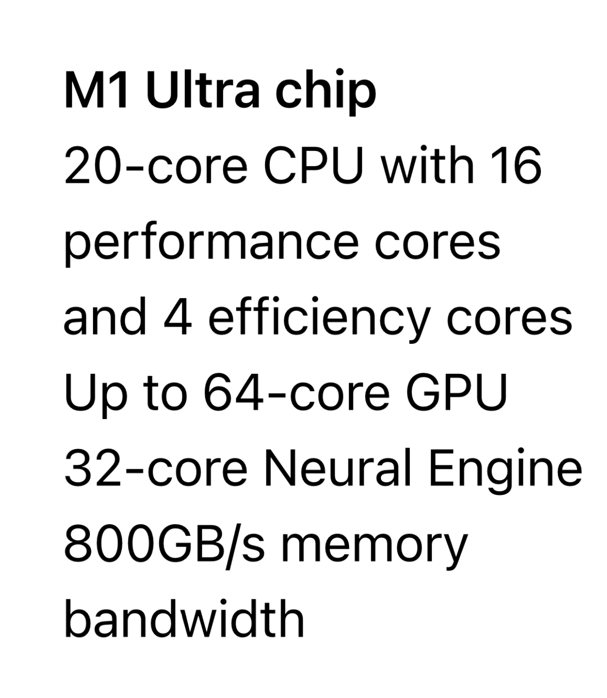

The M1 Ultra had the exact same 20-core CPU with 16P and 4E. My expectation is that Apple will match that same count. M4 Max will not exceed 20-Core CPU. An 18-Core binned version will also be made available.
Your expectation is not meaningful because it's not based on anything relevant. Even if you turn out to be right, it's for the wrong reasons.
The history of the M series shows that Apple is continually playing with core and cluster counts. Even within the same generation - in fact, in *this* generation the M4 and M4Pro have different cluster sizes. So at this point, we have almost no info to go on. If you believe Gurman, the M4 Pro and Max will have the same relationship as the M1 Pro and Max: the Pro will be a mask "chop" of the Max. If that's the case, it is certain that any additional cores on the Max will come in the same cluster size as the Pro. Thus, 15P cores, with an outside chance of 20P. There might be no additional E cores, or there might be another cluster of 4. And of course, there's the possibility that (like the M1 Pro/Max) there will be no additional CPU cores at all, just more GPU, media engines, etc.
