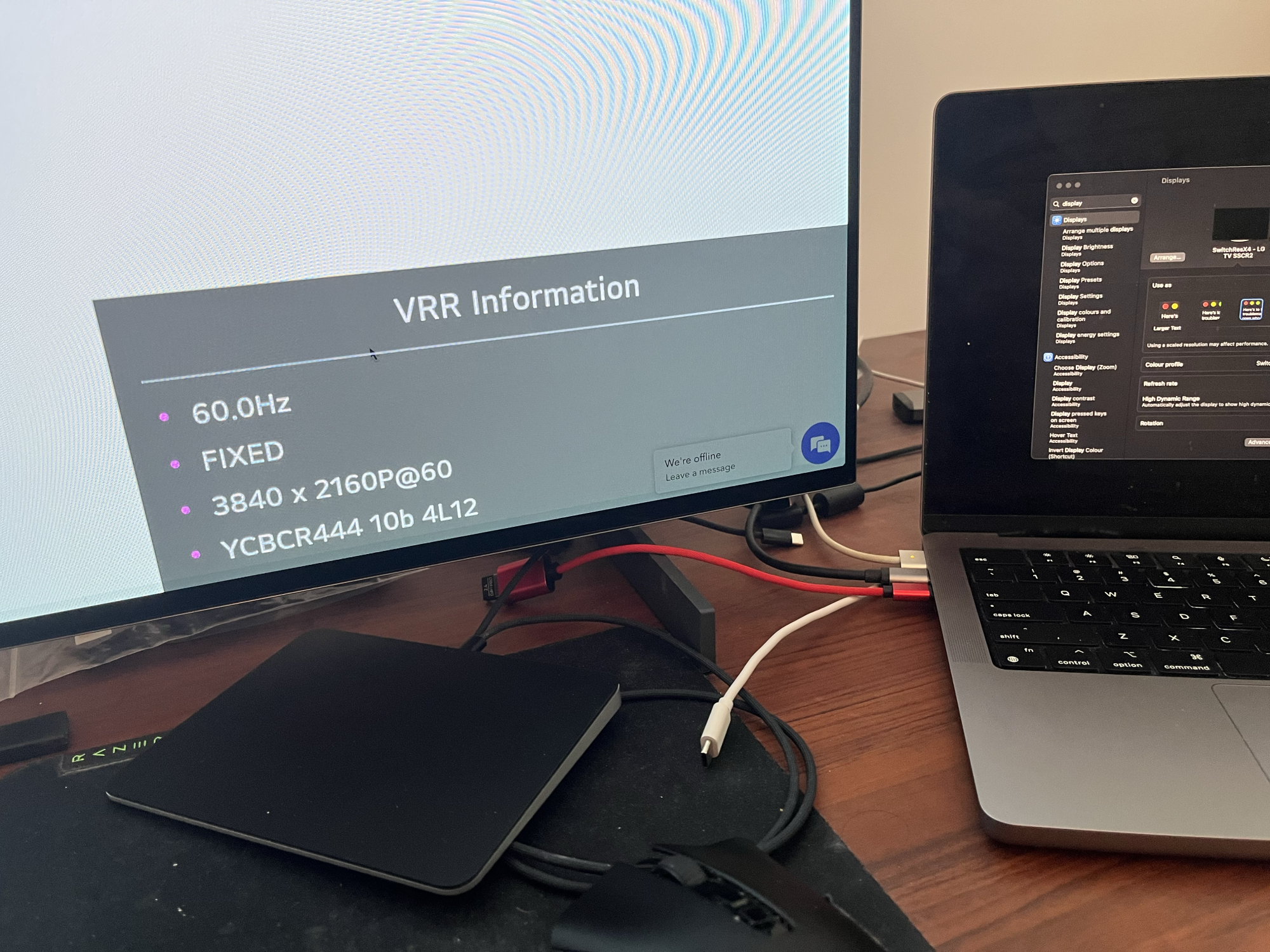

Just bought the new active usb-c alt mode DP to HDMI 2.1 UNITEK V1414A for ~40$
And what do you know, it connects to my tv in FRL6 4lanes 12gbs mode with HDR.
Ventura 13.0
My intention was not to get 120 fps 4k, but to get rid of chroma.
Also, it has support for VRR, but that only works on my windows pc.

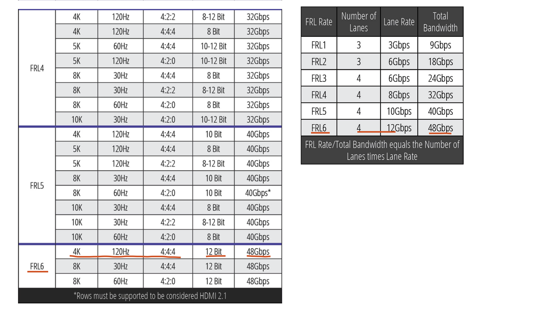

Incidentally, FRL6 is enough bandwidth to support 4k120 10bit 444 (even 12bit)
Realistically though, we can only get the converted DP 1.4a 32gbps, so that is FRL 4 - without any DSC, which I doubt will ever work with these adapters.
Its really interesting that this mode even works, because 4k60 10bit 444 HDR is way out of range of HDMI 2.0 protocol, (~22.28Gbps vs ~18Gbps), which indicates to me that m1 chipset is capable of using the whole DP 1.4a bandwidth even when converted to HDMI 2.1

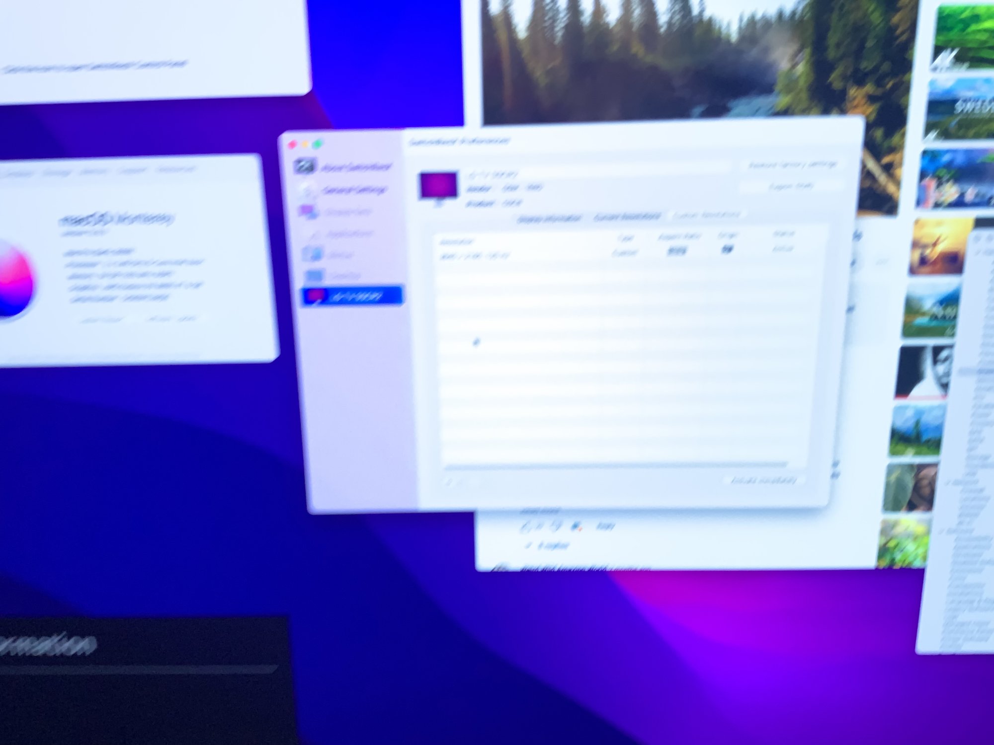

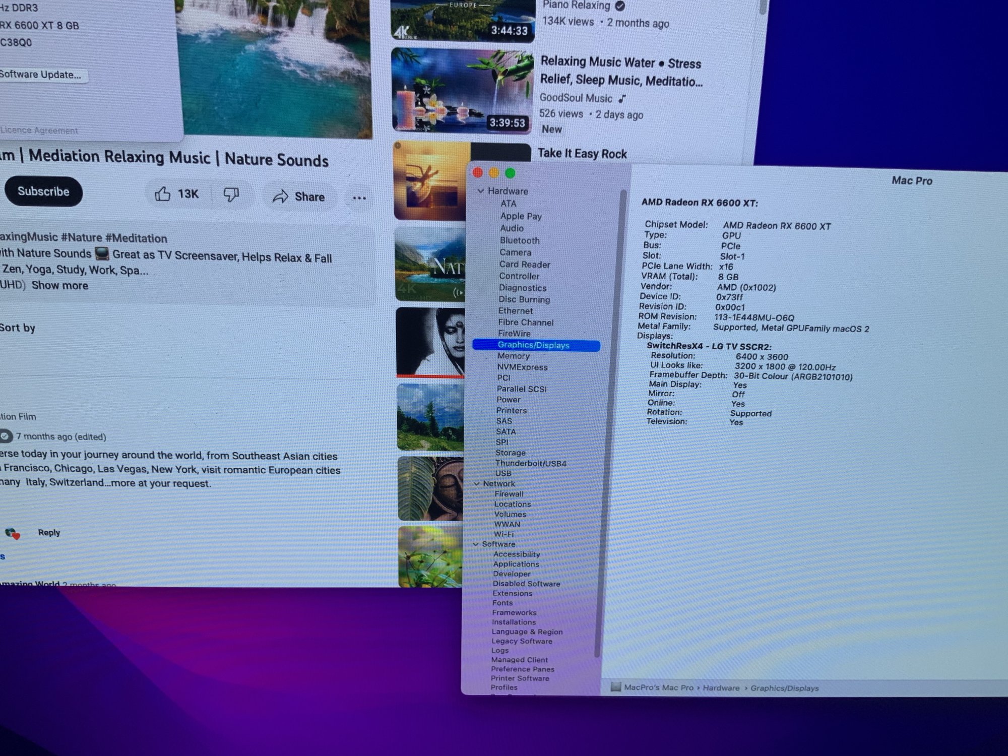

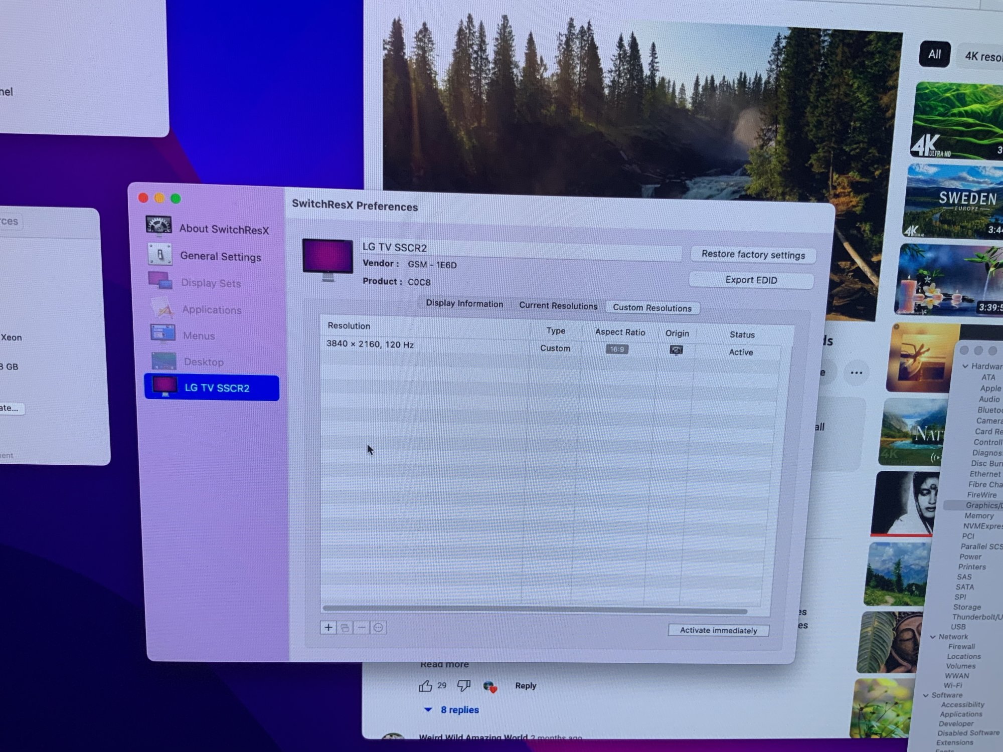

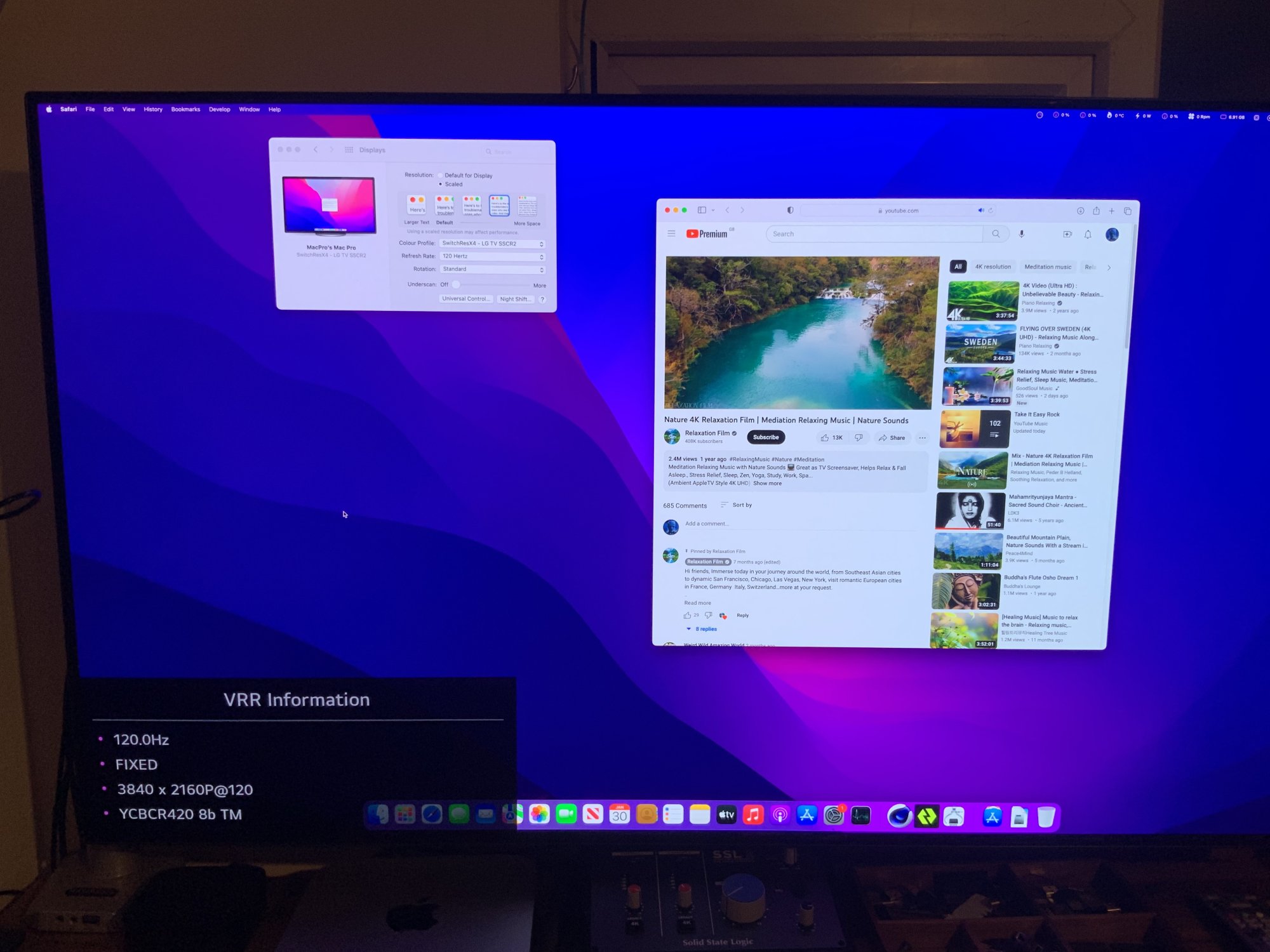

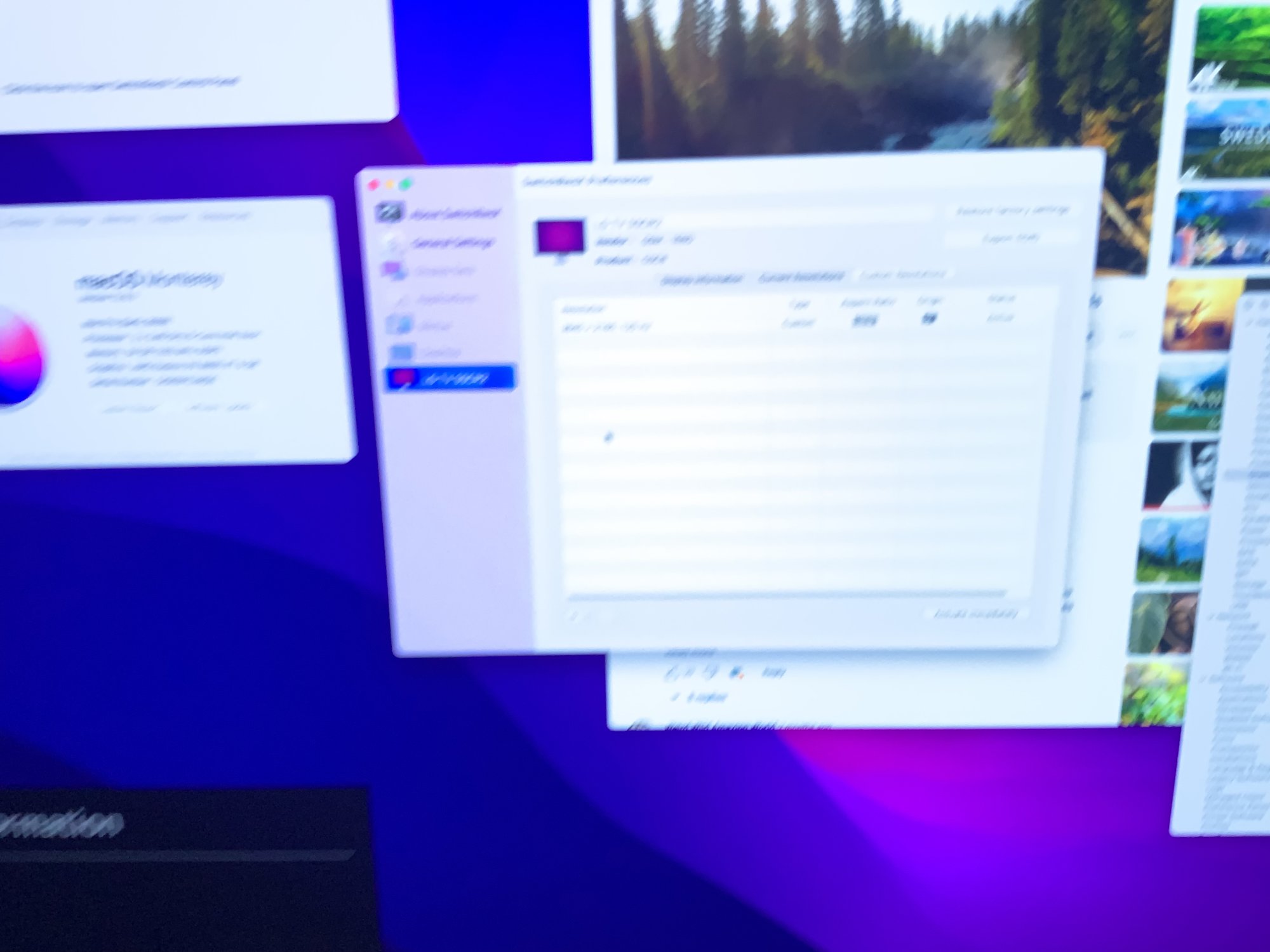

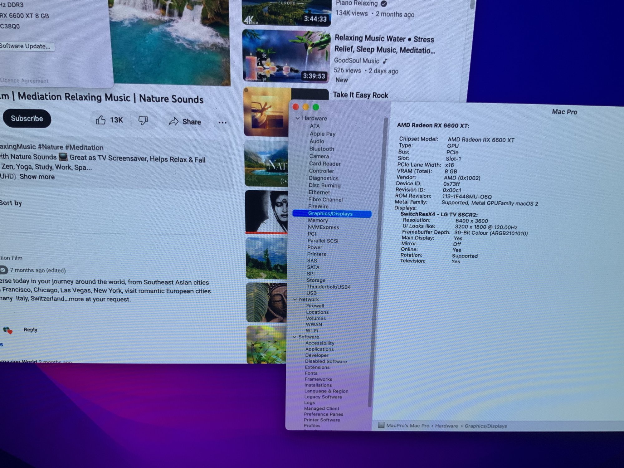

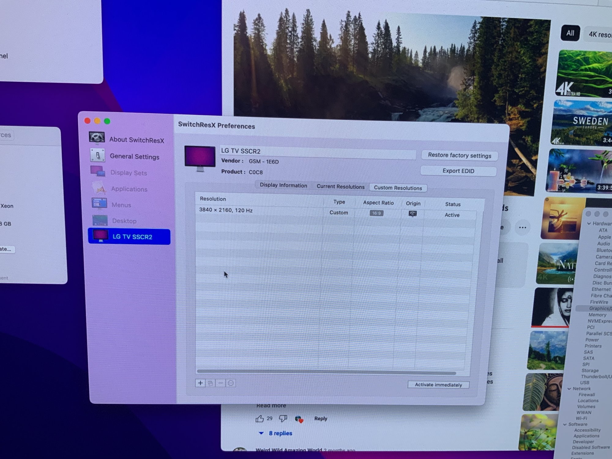

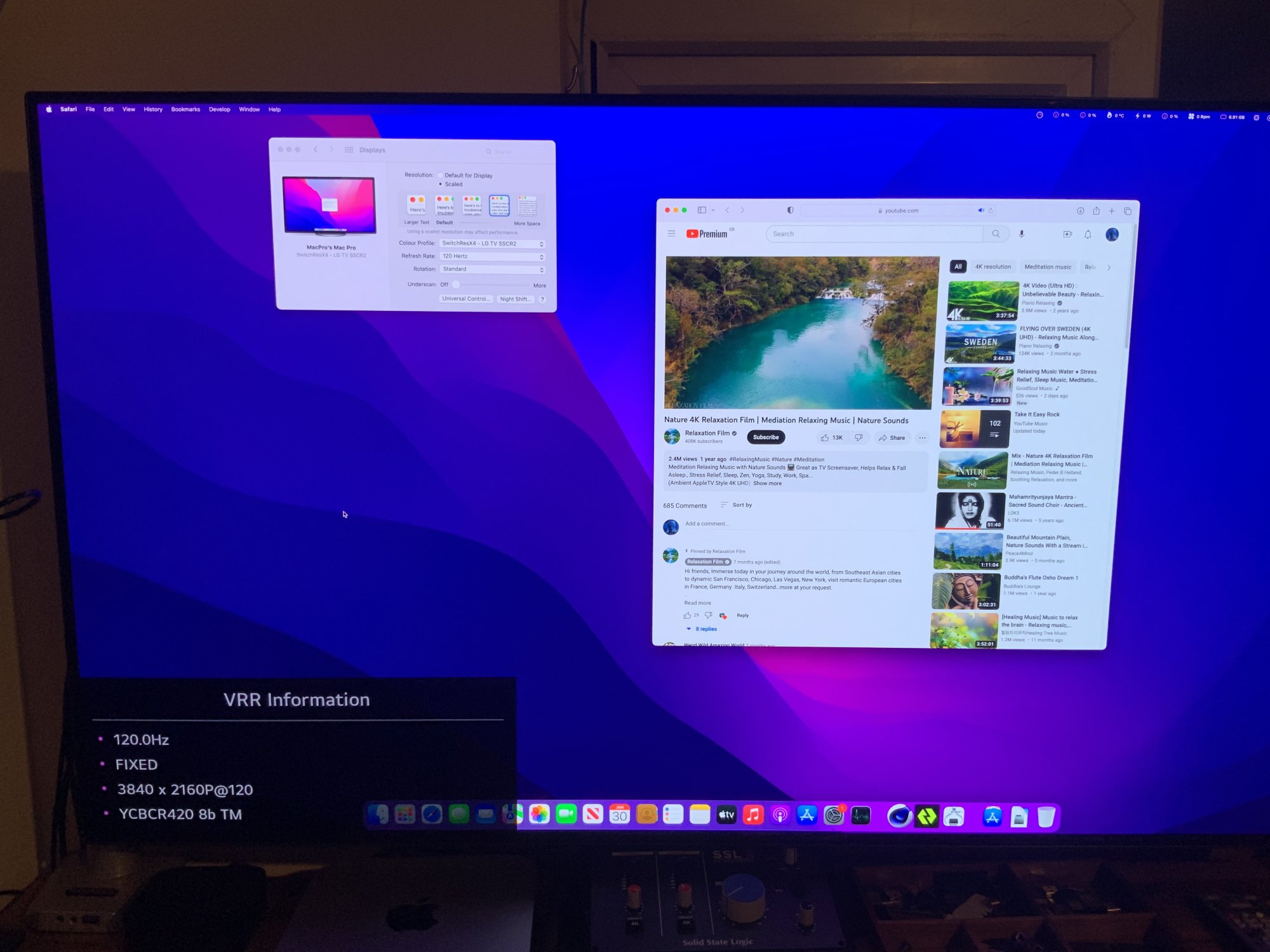

If you have a LG Oled that does 4k and 120hz and you don’t want to buy an new M2 max then I have found a way to get it wiring on Monterey via HDMI 2.1 but you will lose sound …but you can connect a USB audio device as a workaround…the main thing is that you will have 4k120 ….I’ve achieved that from my 2010 MacPro 5,1 with a RX6600xt ….. create custom resolution in switch res x and select simplified settings and choose CVT-RB …not 2 or 3. Save and reboot and activate new resolution!!!! Voila!!!
Ive just fixed the sound by complete chance - I plugged in a an active Club3D display port to HDMI adapter and then removed mu 8k HDMI cable and plugged it into the HDMI 2.1 port on my GPU leaving the Club 3D still plugged in and VOILA! Sound through the TV via HDMI and 4k@120hz on a 2010 MacPro and RX6600XT!!!! FINALLY Tru Motion Scrolling on my 48inch OLED and Mac OS!!!!
Your running on HDMI 2.0 standards with the 4:2:0 8bit 120hz @ 4k
We are seeking 444 120hz @ 4k (HDMI 2.1)
