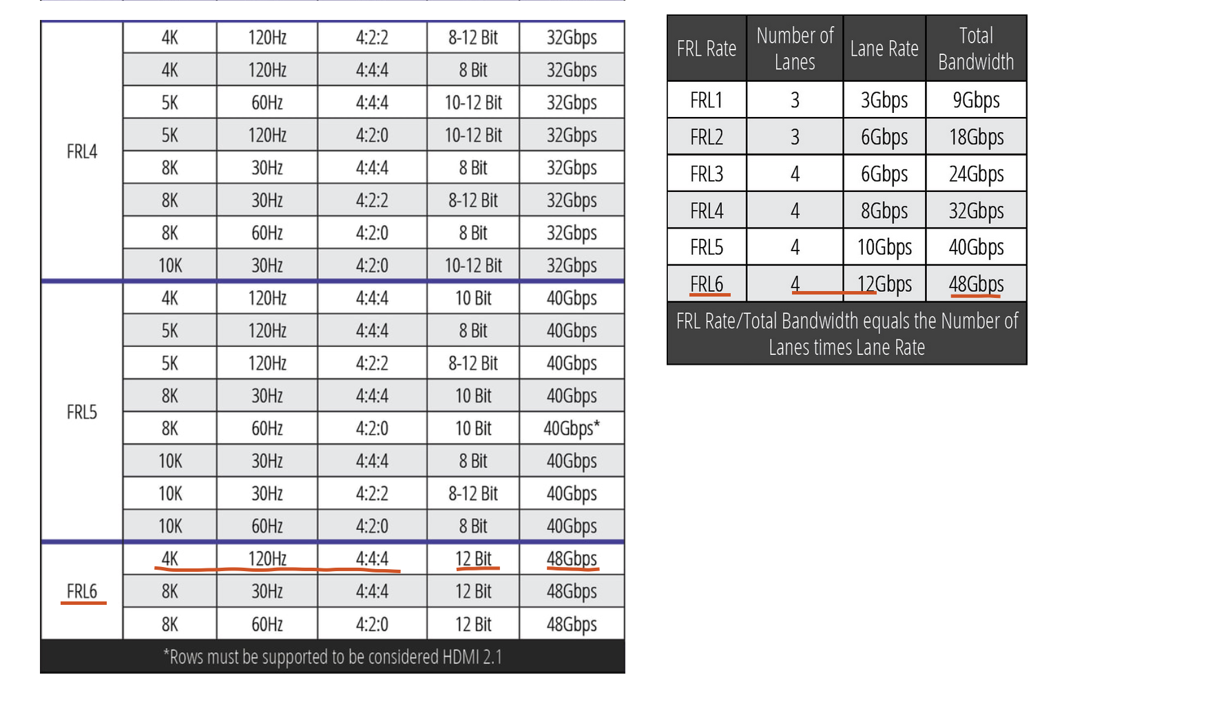

Just bought the new active usb-c alt mode DP to HDMI 2.1 UNITEK V1414A for ~40$
And what do you know, it connects to my tv in FRL6 4lanes 12gbs mode with HDR.
Ventura 13.0
My intention was not to get 120 fps 4k, but to get rid of chroma.
Also, it has support for VRR, but that only works on my windows pc.
Incidentally, FRL6 is enough bandwidth to support 4k120 10bit 444 (even 12bit)
Realistically though, we can only get the converted DP 1.4a 32gbps, so that is FRL 4 - without any DSC, which I doubt will ever work with these adapters.
Its really interesting that this mode even works, because 4k60 10bit 444 HDR is way out of range of HDMI 2.0 protocol, (~22.28Gbps vs ~18Gbps), which indicates to me that m1 chipset is capable of using the whole DP 1.4a bandwidth even when converted to HDMI 2.1

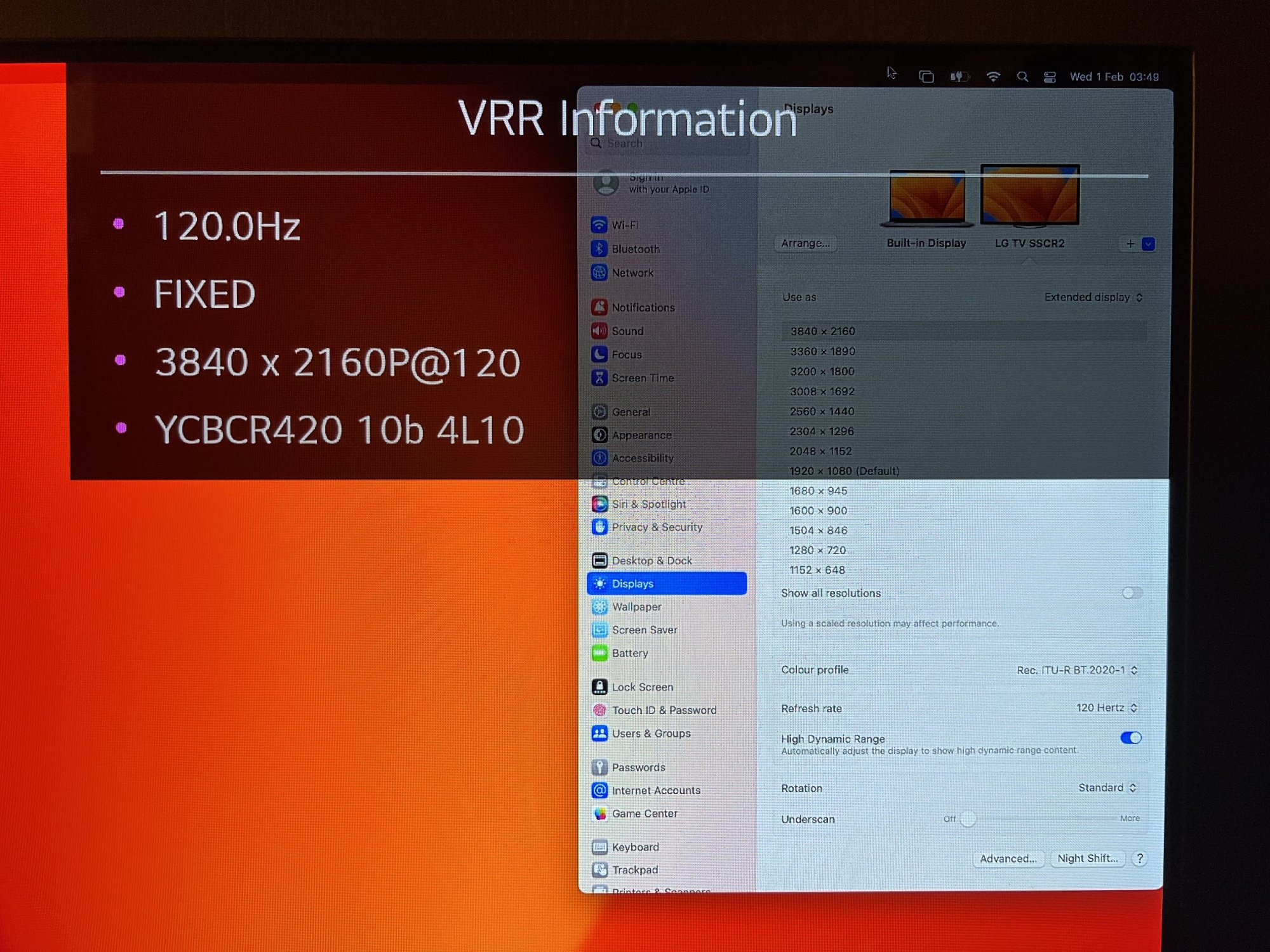

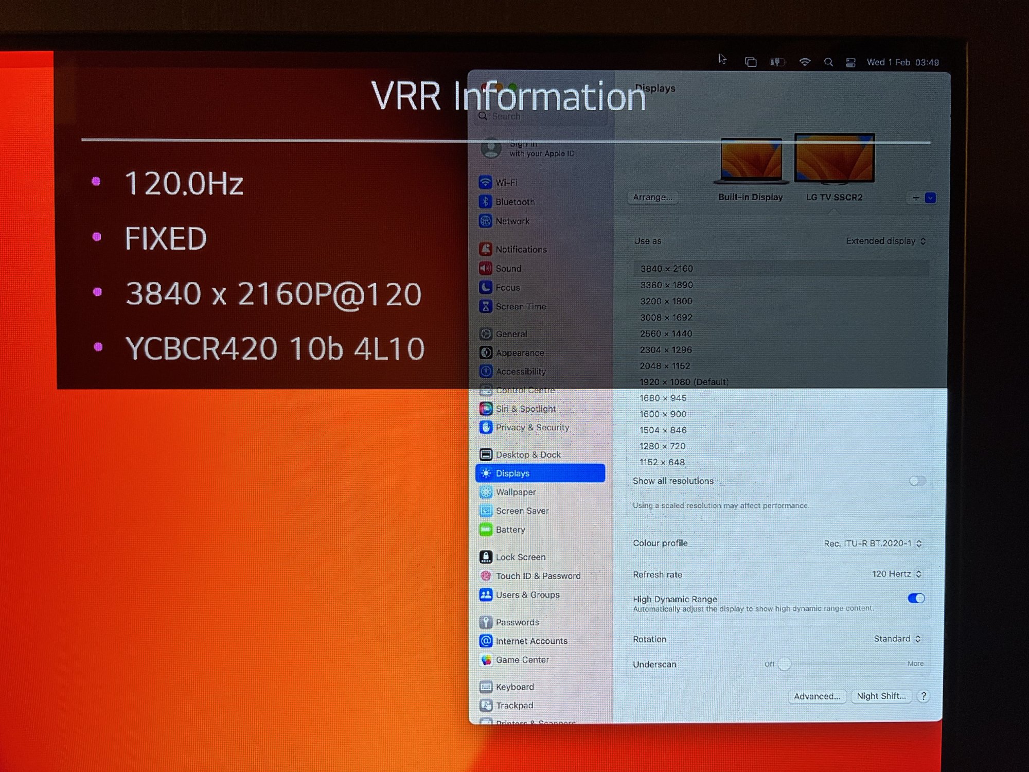

Press the green button on the remote multiple times til you see a little windows pop up on your screen. Note what it says and post it in the thread. :)
Reactions: Chancha

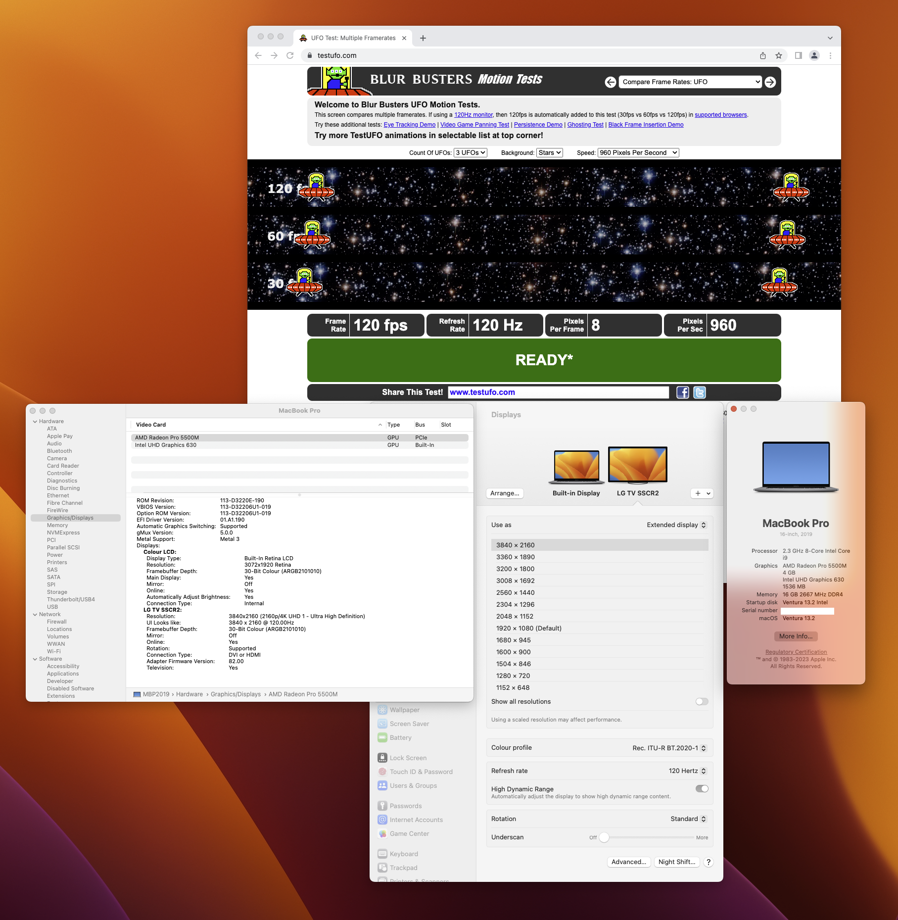

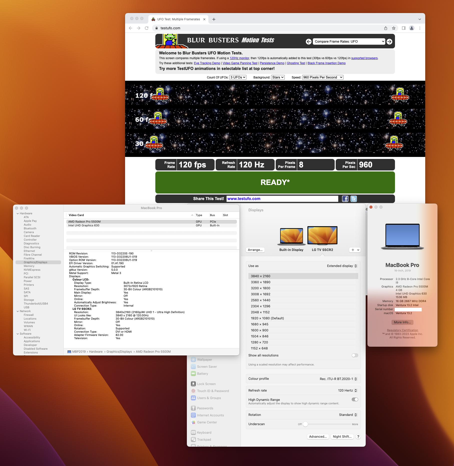

Well. Look like 4:2:0 still. At least 4k120 is now accessible without installing anything in Ventura.
Did those options just pop up for you with that adapter or are you using some other software to get 4k120hz?
It was a fresh Ventura install, nothing else except Chrome (Safari cannot be used to test 120Hz). If you mean the list of resolution then you access these by alt-clicking any of the 5 scaling icons.

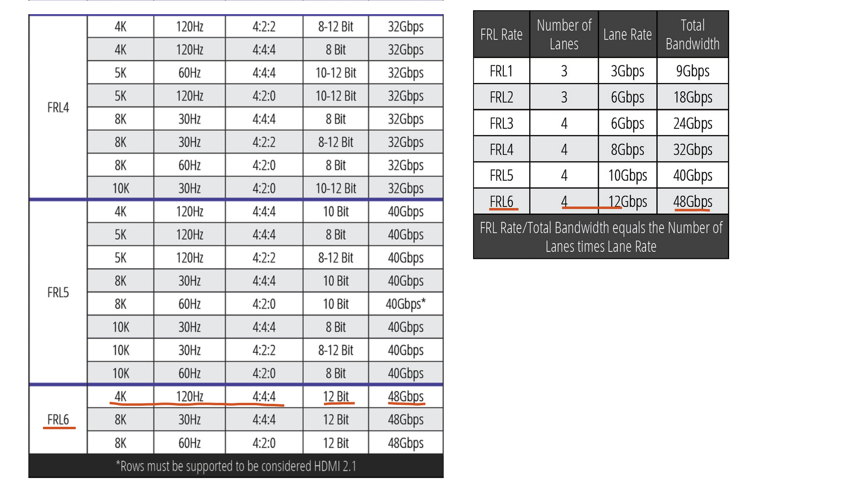

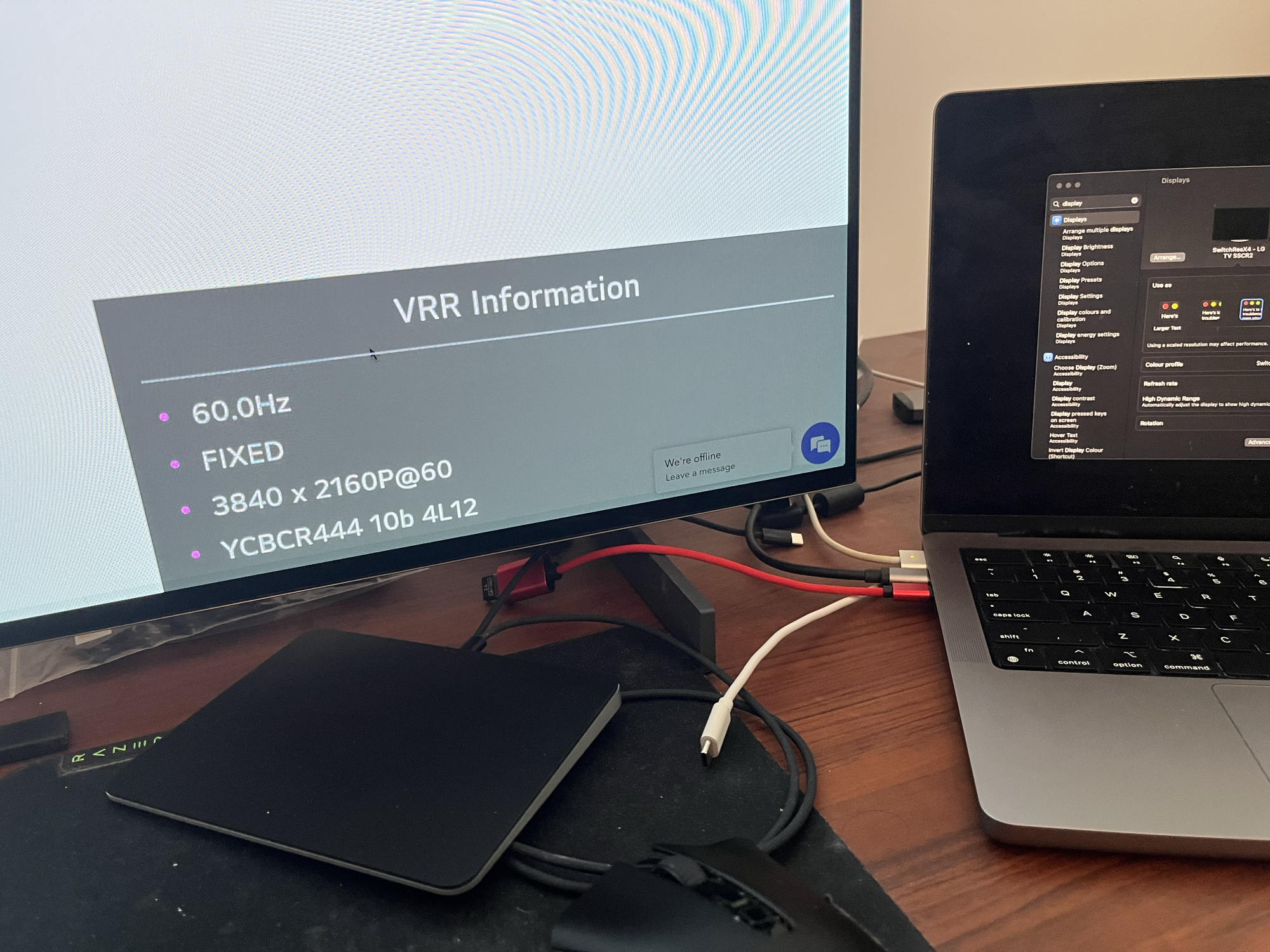

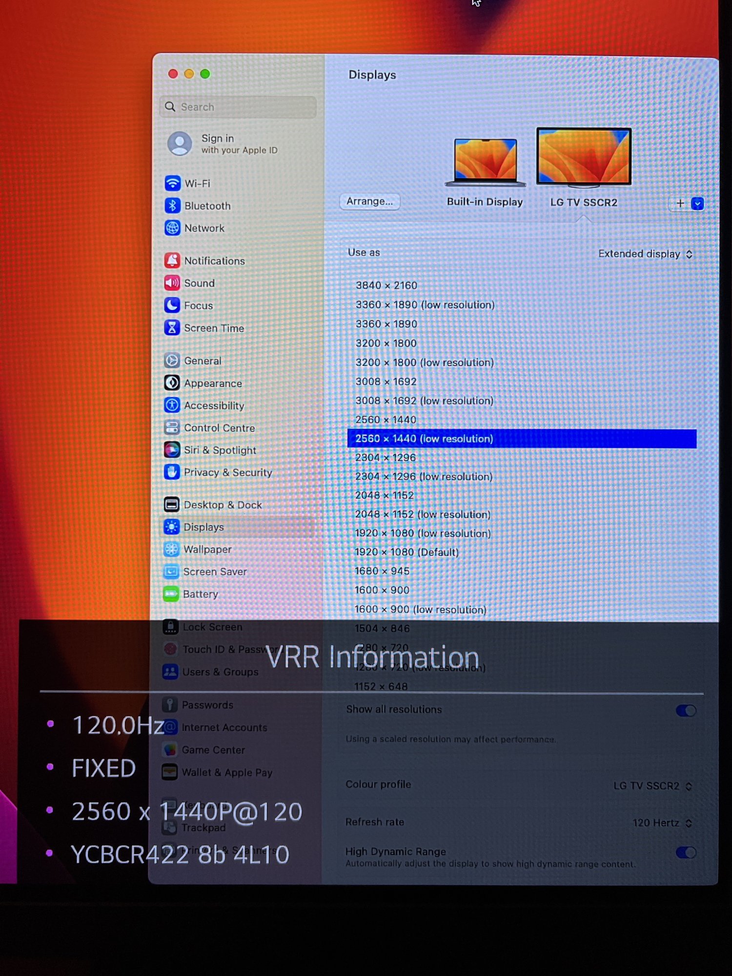

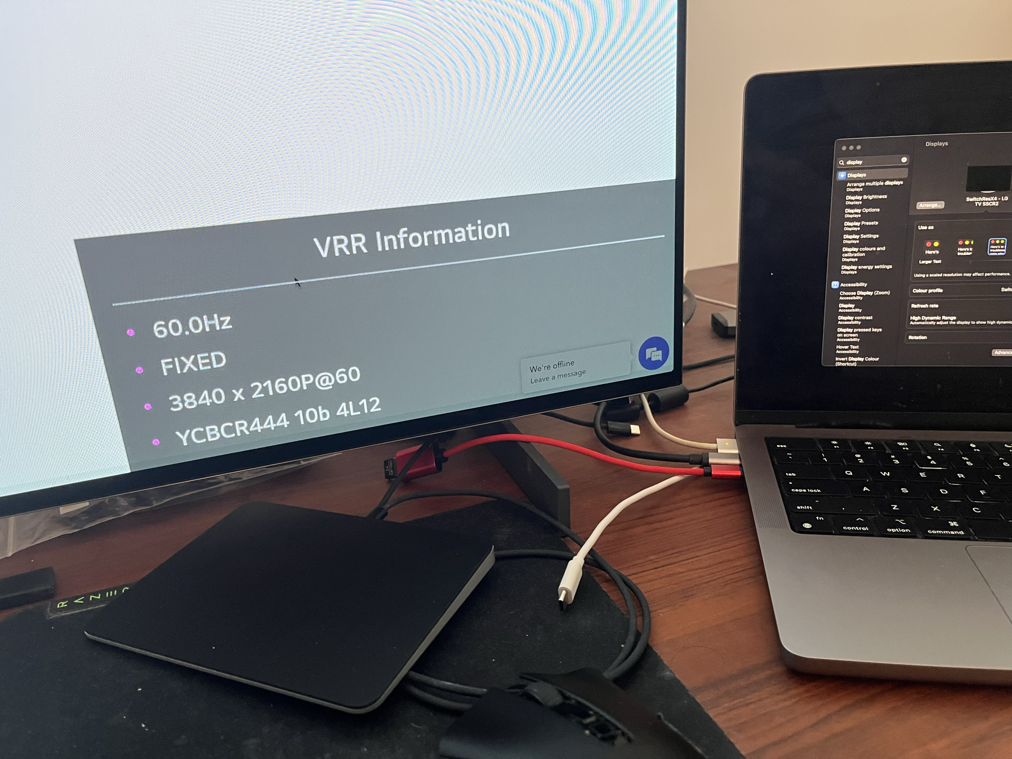

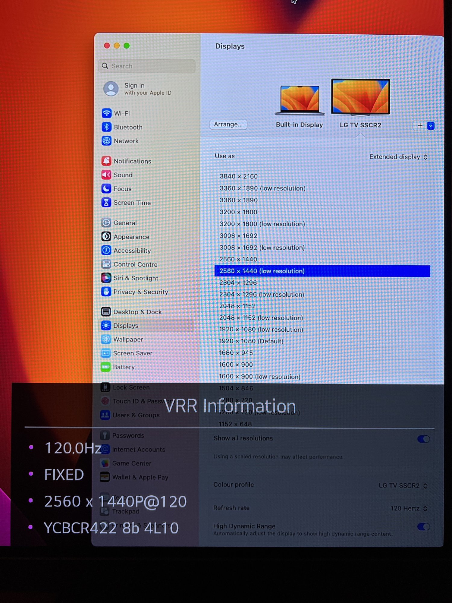

Just to report back with a confirmation:
The exact same setup with a Ventura 13.2 M1 Pro instead:
MBP2021 14" base > UGREEN CM491 (50338) > HDMI 2.1 cable > LG CX 55"
4k at max 60Hz HDR
need to drop down to 1440p to get 120Hz
If I take away the adaptor and plug the HDMI cable directly into the built-in HDMI port of the MBP14", frequency limits remain the same, with the subsampling dropping to 4:2:0.
So yes the Intel MBP2019 16" was an exception for whatever reason, where a 4k120 4:2:0 is possible somehow.

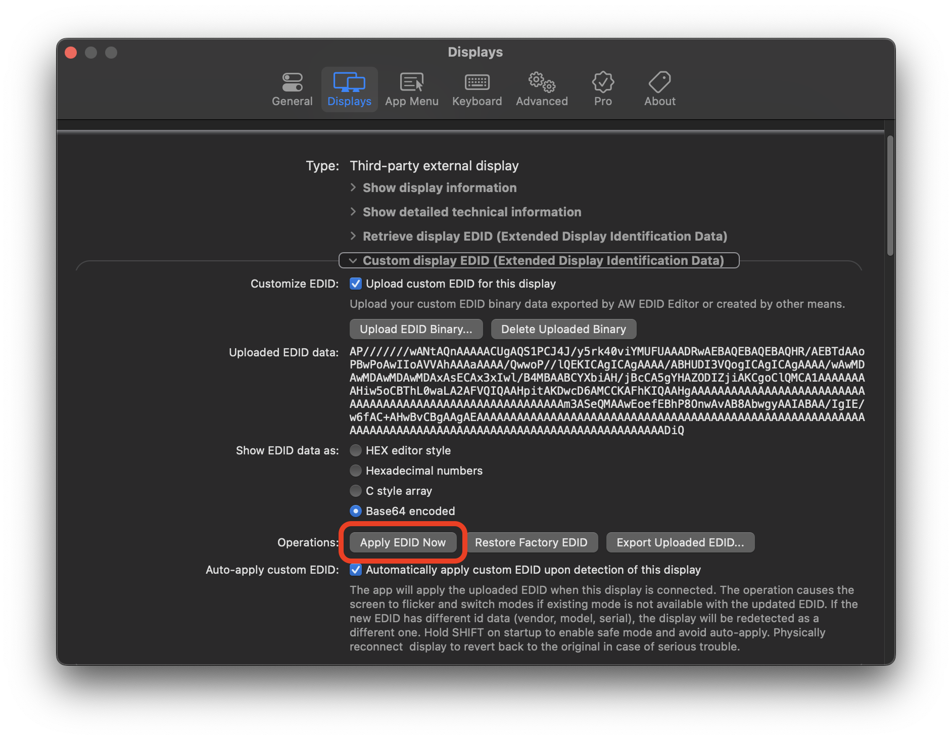

EDID is what describes the display's capabilities. By changing the EDID you can create custom timings (resolutions, frequencies) and also a lot of other aspects of how the display behaves (color encodings, capabilities, identifiers etc). So far it was not possible to use a custom EDID with Apple Silicon (Intel macs had this), but now there is a way to do this.
This will not solve the 120Hz issue on the Mac but might be an useful tool as it is now possible to experiment with various timings and see what works and what doesn't, what factors trigger limitations and what doesn't.
I am yet to test this with HDMI, works well with USB-C/DisplayPort.

No, it's entirely different. You can use the BetterDisplay app to download the EDID file, alter its contents via AW EDID Editor and then use BetterDisplay to apply the new EDID. You have to upload it here (see below) and click `Apply EDID Now` which will briefly disconnect the display and reconnect it with the updated EDID:
