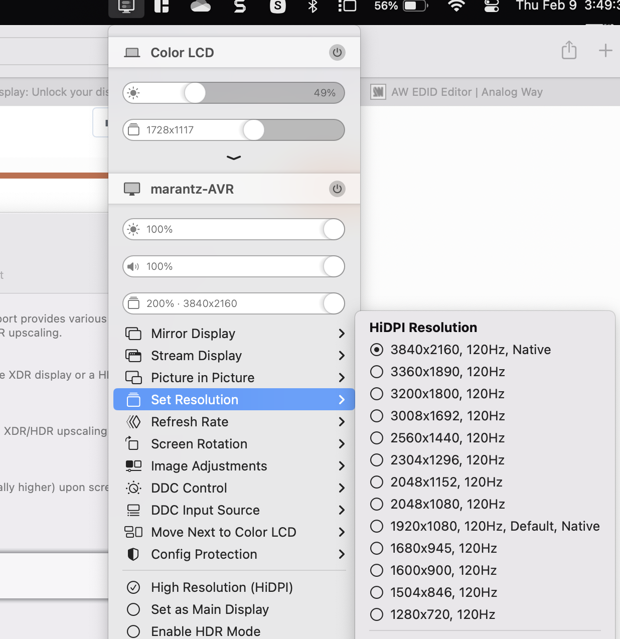

I updated the firmware on the cable matters adapter and I now have 4K120 on my LG C2 with my M1 MaxMBP. I'm going to try it with my M1 MBA next. I was just about ready to click buy on the M2max MBP 16 to get 4K120, but now I got around Apple's fake limitation I'm happy enough to not upgrade at this time. I'm only getting 4:2:0 and not 4:4:4 though. Has anyone been able to get the better chroma?

@stevemr123 Thanks! With a modified EDID (as in your guide) I am now getting 4K@120Hz (non-HDR, have not tried HDR) without subsampling (The menu says YCBCR444 8b 4L8) on a M1 Pro MBP 14 connected to an LG C1 48" via a cheap RSHTECH hub. The hub uses a VMM6100 that I updated with the firmware from Cable Matters (lol).
