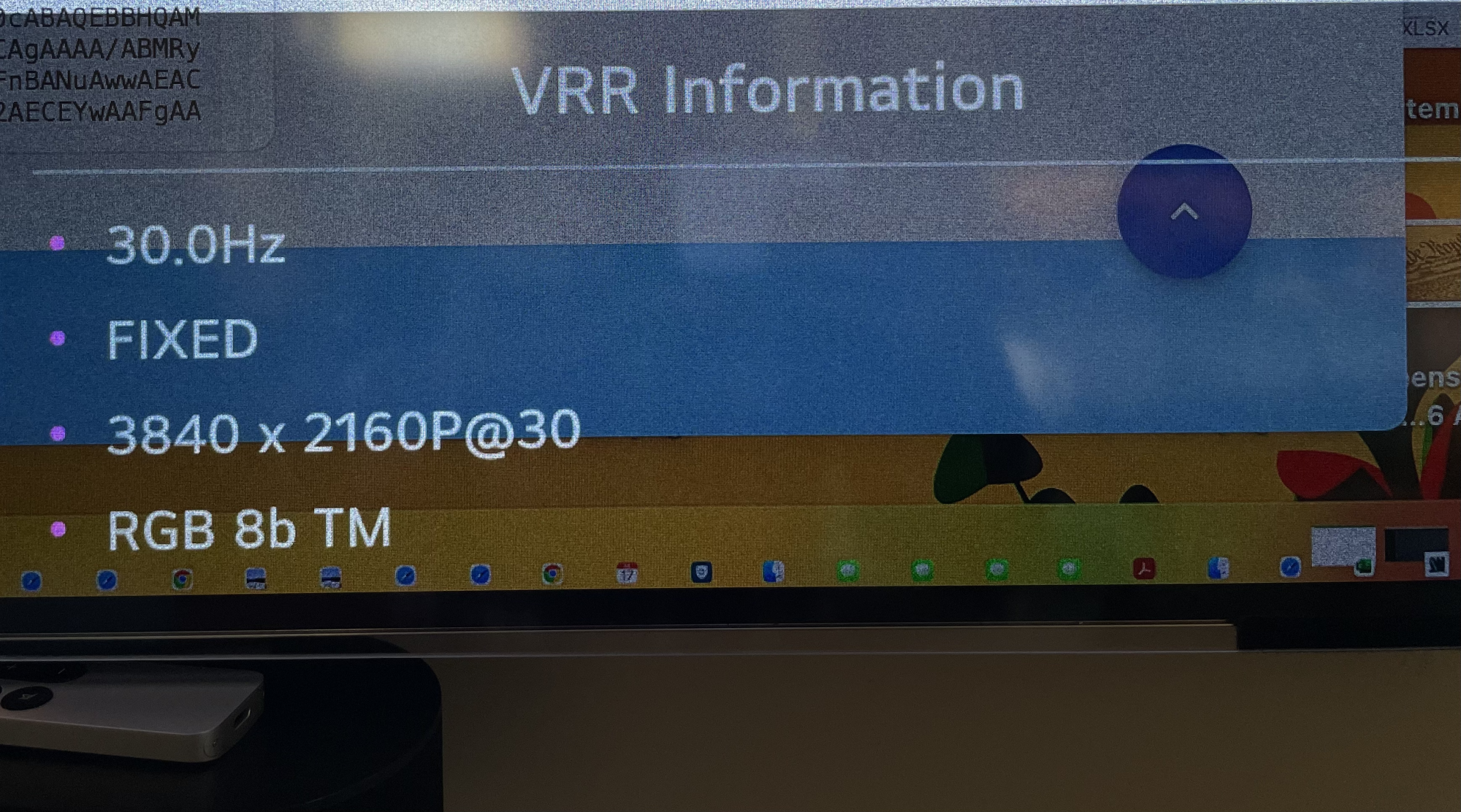

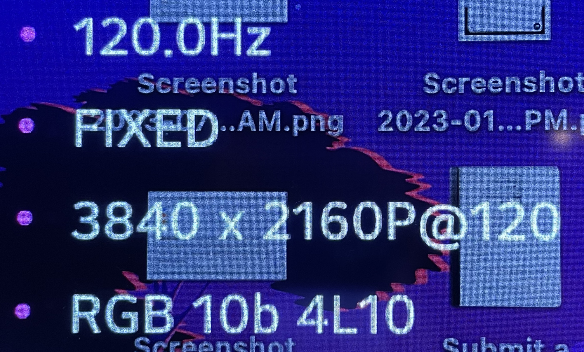

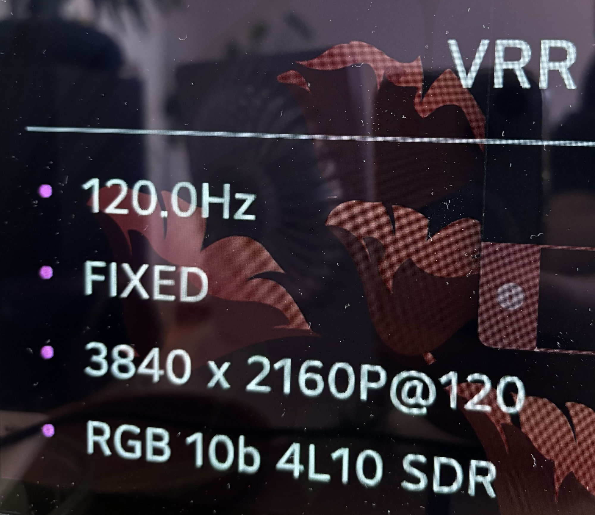

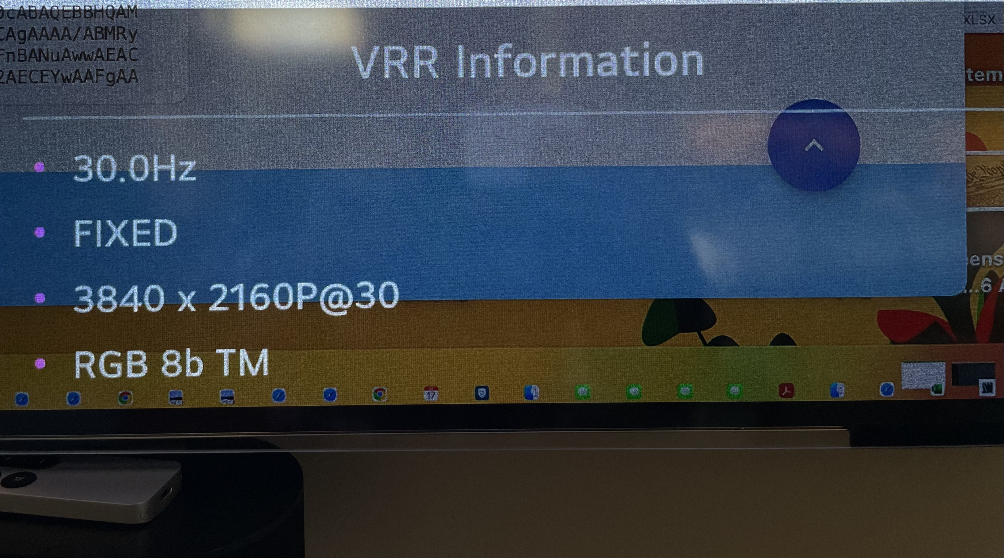

4k30 for me :(
LG G2 55" OLED
MacBook Pro M1 Pro 16" 2021
Anker 518 adapter
Flashed it per the instructions.
Getting 30Hz before and after flashing. Perhaps get a better and shorter cable to test?
****UPDATE**** I did something then my OLED TV asked if I wanted HDMI Deep Color on the input, I said yes, then my MacBook showed between 30-120Hz as an option. I selected 120Hz and the screen was trying but I think my craptastic 30 ft HDMI cable wasn't quite up to snuff. I ordered an Anker 2.1 cable with 5 star reviews at 6.6 (2m) length. It arrives tomorrow (Sun Jul 9th).
If there's a better cable, let me know. I'll report back tomorrow.
Update #2 #itsthecablestupid!
New cable fixed the flashing/connection issue:

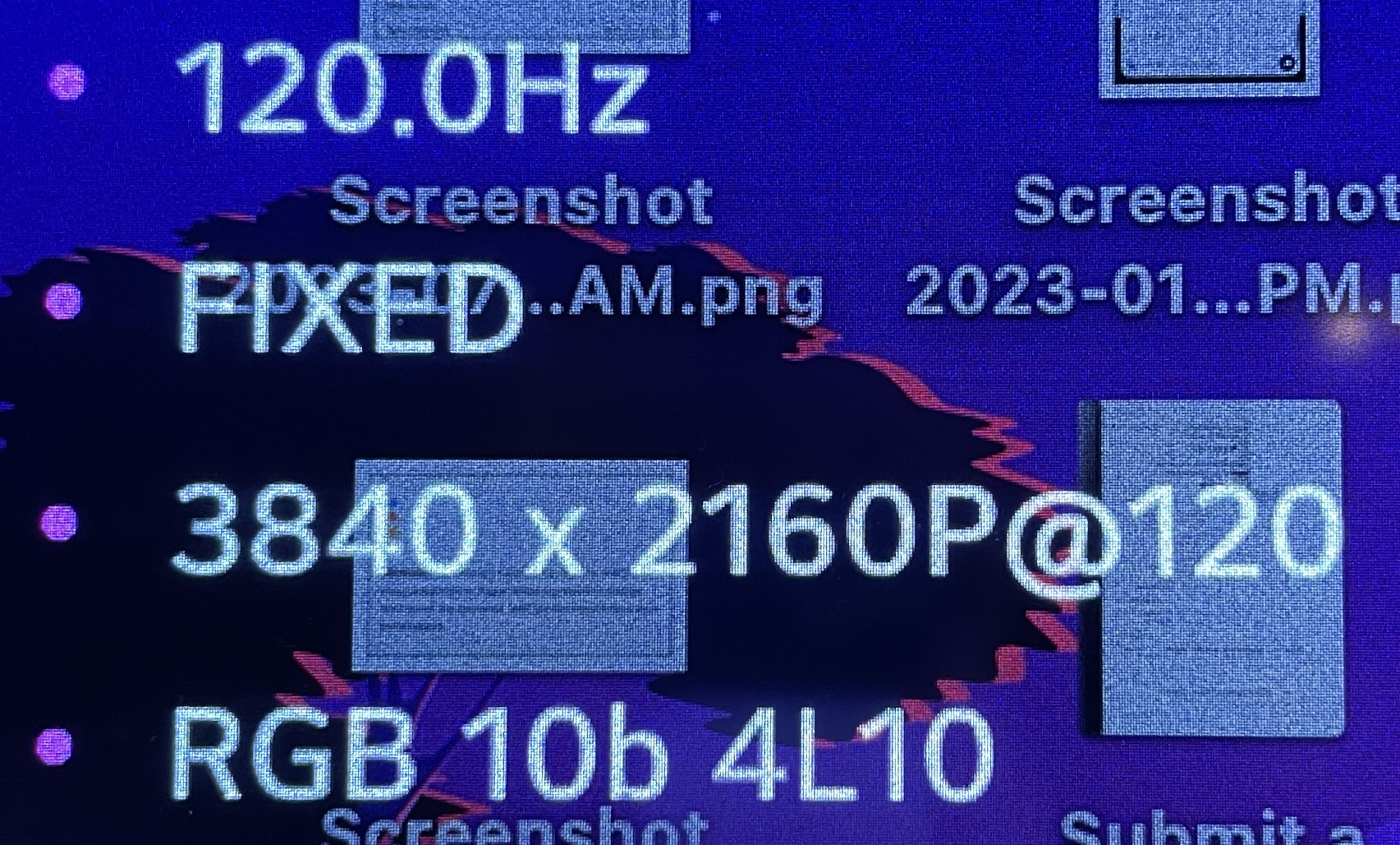

Am I seeing this right?
You have 4k 120Hz 4:4:4 10bit working!? I thought the most could get from their M1 Max was 4k 120Hz 4:4:4 8bit?
Is this only possible with the Anker 518 DP adapter and not with USB-C > HDMI?
Looks like we’re late to the party…10 bit indeed, though I don’t think it’s only with the Anker 518….
Can someone else confirm?
Yes, 4K 120 Hz RGB 10-bit works fine with the VM7100 adapters and custom firmware on the M1. It works with the VM6100 adapters as well but needs both custom firmware and EDID override. There is no solution for Intel Macs, though the hardware is capable.

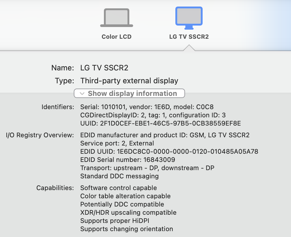

A quick tutorial:
STEP 1. Download the display's EDID binary using BetterDisplay. Go to Settings (gear icon in the App menubar extra menu) - > Displays > Retrieve display EDID and click Retrieve EDID Data and when the EDID appears, click Export EDID Binary...
STEP 2. You need to open the exported EDID binary up in AW EDID Editor (free). This is the only simple thing you need to change in AW EDID Editor.
If this option not there, then you simply need to change the EDID format to V1.4 under Version&Revision (the Revision bit should be changed from 3 to 4).
STEP 3. You can upload the EDID Binary with the Upload EDID Binary... button and then apply the EDID here with BetterDisplay under Settings (gear icon) - > Displays > Custom display EDID. When you hit Apply EDID Now, the display should disconnect and reconnect with the new EDID in effect. You can try setting the resolution to 4K@120Hz using the app's Set Resolution menu. You can set the EDID to auto-apply as well with the right checkbox whenever the app is started at launch and the display is detected.
You can of course make all kinds of other hacks by modifying the EDID to your liking. Share your experiences!

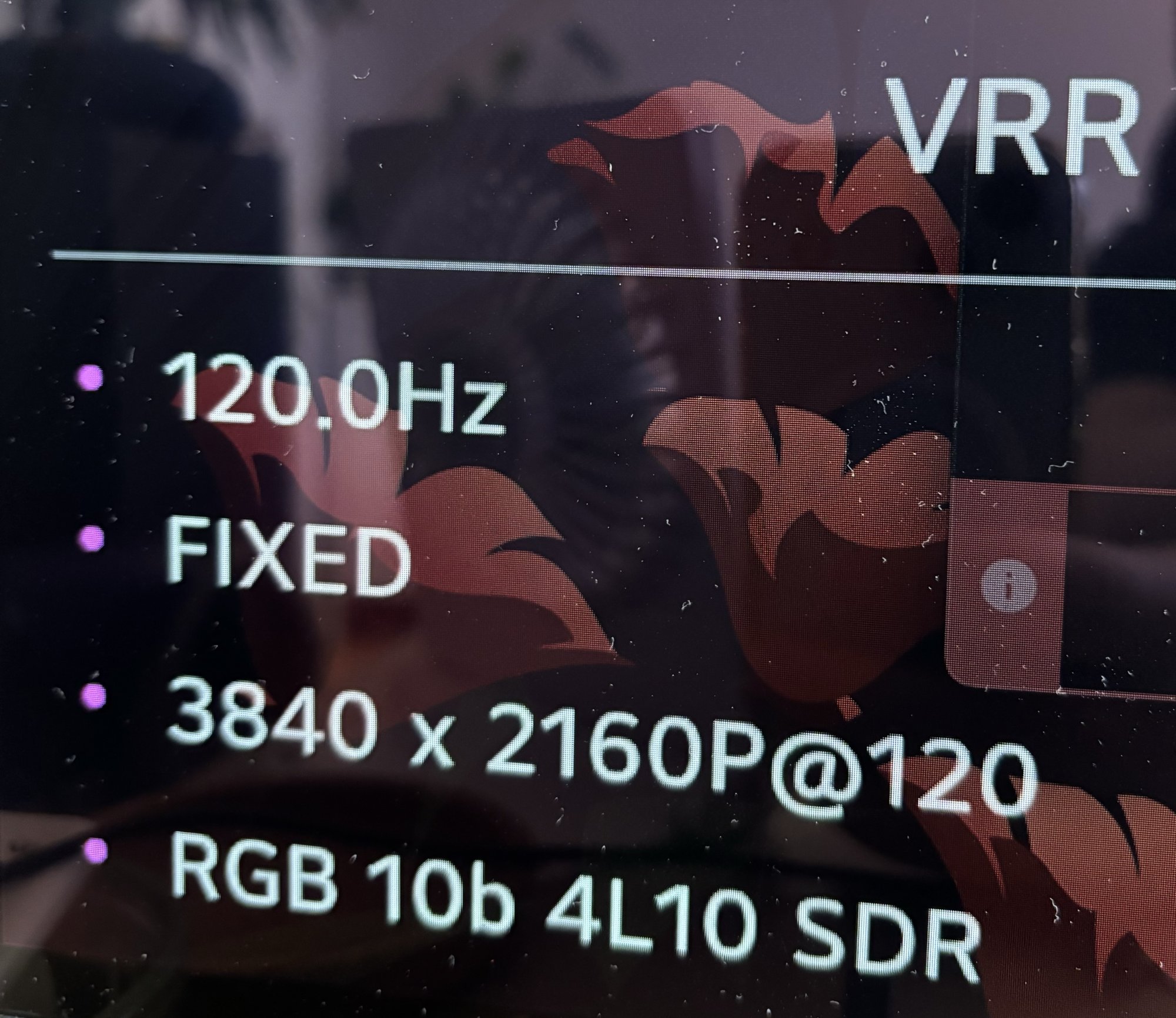

Hello, I currently reach 4k@120hz 10bit, but HDR can not be enabled. I wish someone can help me check my problems.
My hardware: Mac mini M1 chip, LG C2 42, with a usb c to HDMI 2.1 cable. https://www.amazon.com/dp/B0CJLC72MG?ref=ppx_yo2ov_dt_b_product_details&th=1
My first problem is that why I cannot enable HDR? Since the bandwidth seems not to be a problem, I do not know why it fails. Is this because I use a direct cable from usb c(DP protocol actually) instead of an adapter? But I see @nandakke also used a cable, and I do can edit the EDID and load it back.
My second problem is that BetterDisplay is not stable after I edit the color depth to 10 bits explicitly. After rebooting, my tv will go black and reconnect multiple times. Sometimes it works normal finally, but sometimes the screen is always black.
I appreciate all potential help!

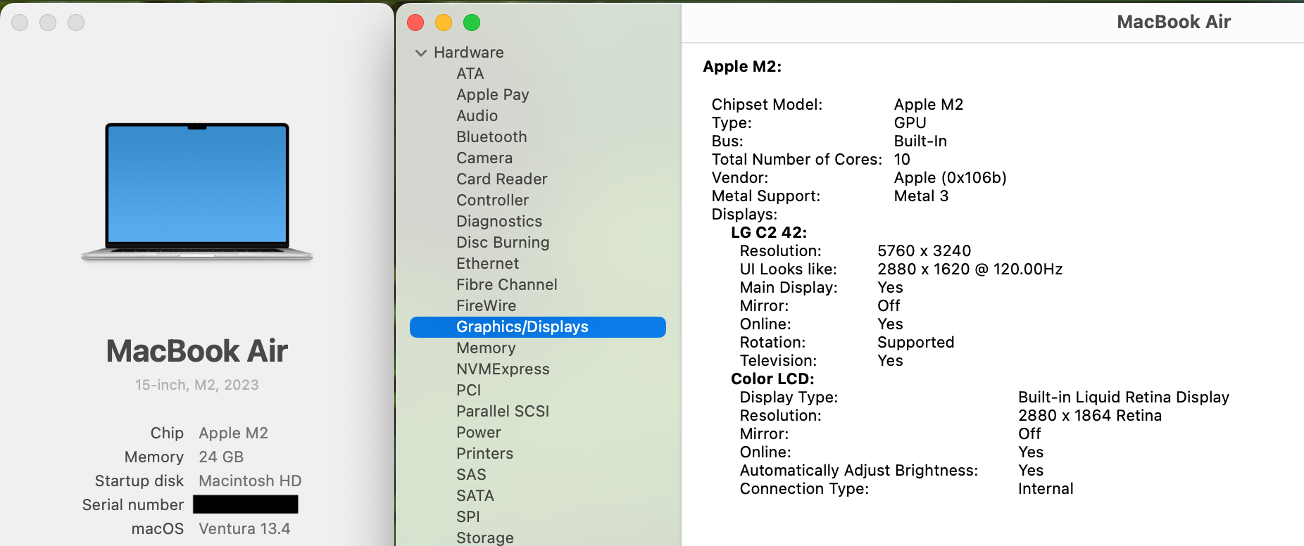

I tested Cablematters today with intel MBP 2019 16 inch with radeon graphics. I got it to work 4k 120Hz on my Samsung 65QN900B(I think tv is limited to 120Hz). Also HDR worked.
I couldn't output 8k at any refresh rate. Maximum resolution I got was 4096x2160... I will get M1 Max MBP in next couple of days so hopefully it works there...
Few weeks back support told me that in theory it should work because bandwidth is the same as 4k@120Hz

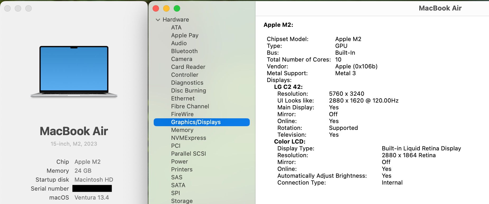

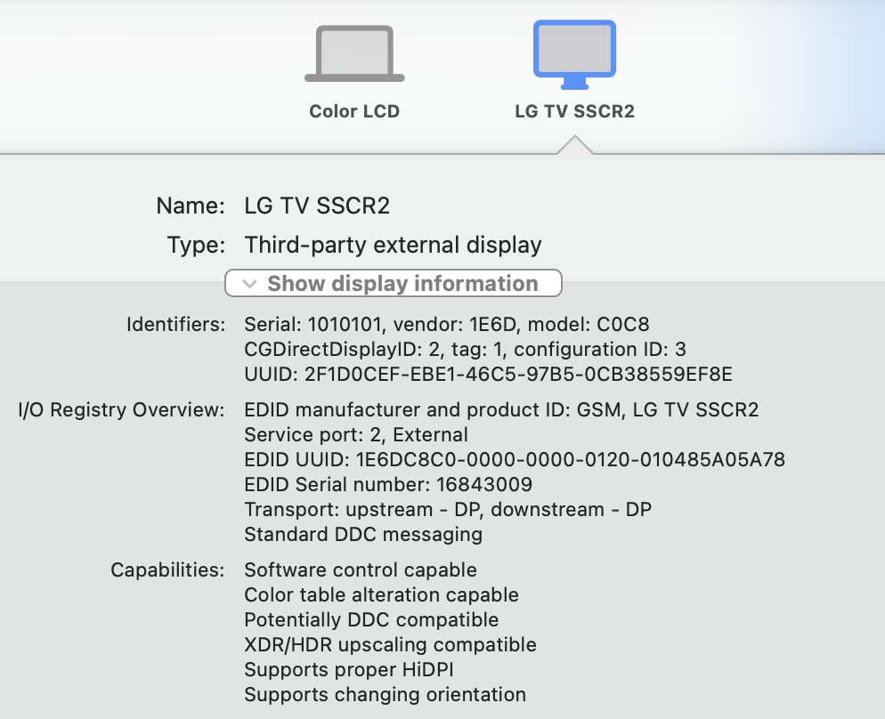

Hi everyone!
Thanks to you all, I also succeeded in getting 4K 120hz 10bit. I have M1 Max Macbook Pro and I've been using cable matters foldable usb-c to hdmi 2.1 adapter(probably 6100) with my LG C2 42''. I can turn on the HDR on display settings without an issue as well, but stay in SDR mode most of the time.
This is the adapter:
Anyway, my question is about updating the Mac OS. I am currently using 13.6 Ventura and thinking of updating the system nowadays. Did anyone experience any issues related to display settings that we kind of "built" for these oled tvs and macbooks after a Mac OS update?
FYI, I did update my TV software each time and it's up to date at the moment.
Thanks!

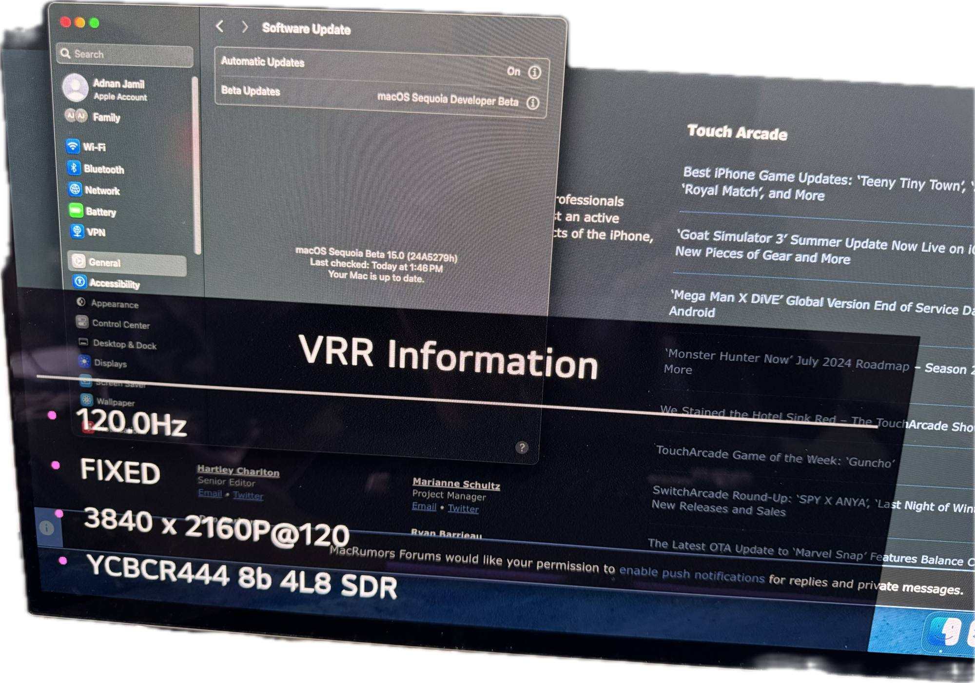

This was working flawlessly until I upgraded to macOS Sequoia Developer Beta. The display went from RGB 10b to YCBCR444 8b. Is there a fix for this?
