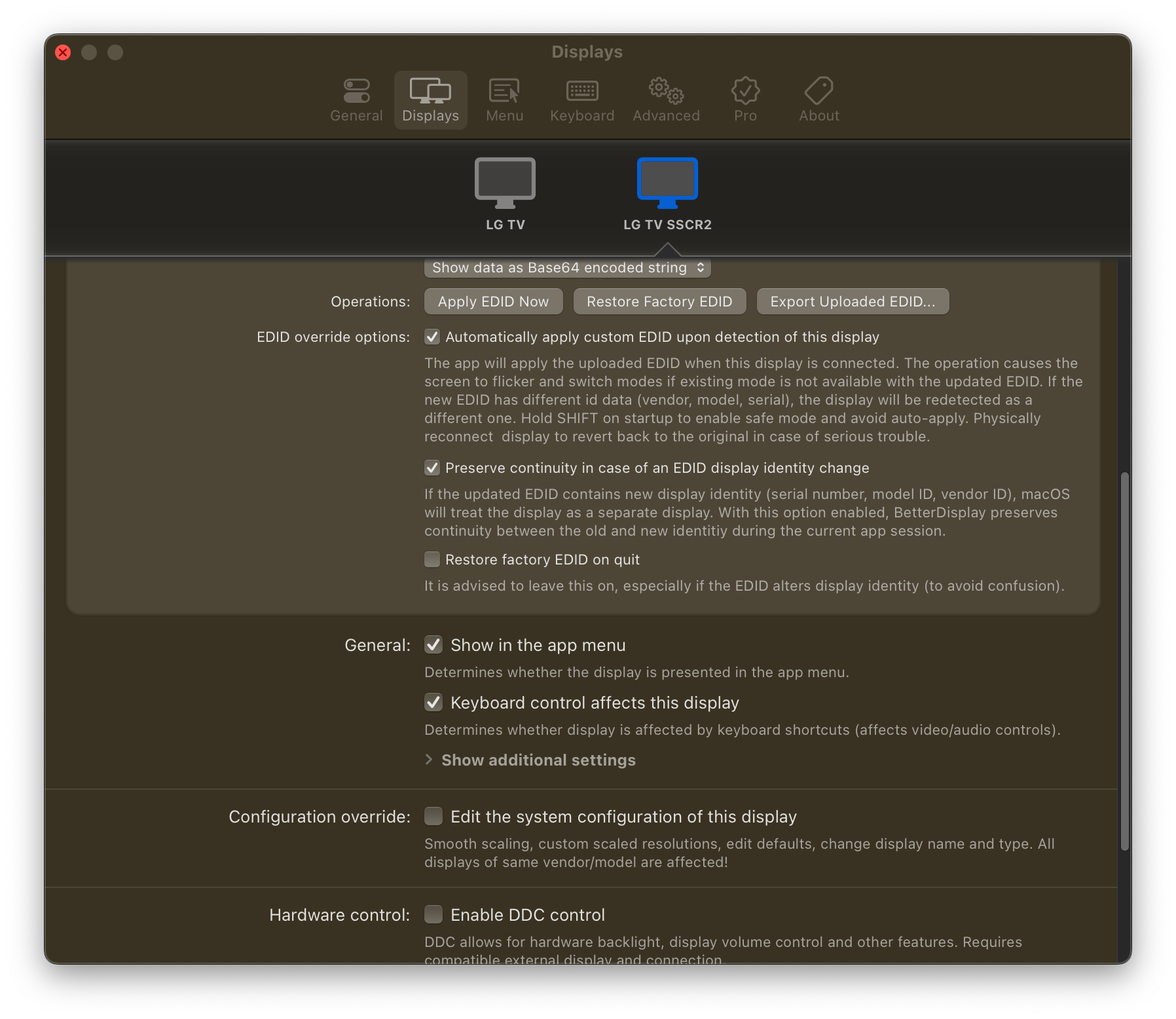

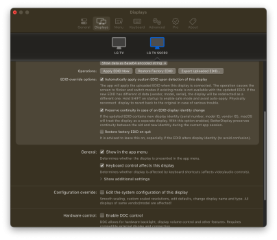

I uncheck the bottom option in edid, like in the image I'd post, and now don't have problem exiting sleep. I use too Amphetamine. For make it is better configure the edid options after setting reset on BetterDisplay. Everything with Mac mini and two lg tv.

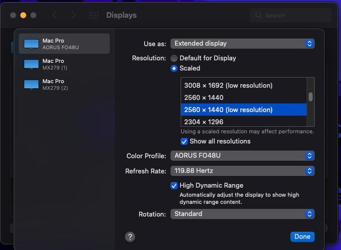

Update... I can only get 1440p 119.88 low res. I tried both SwitchresX and BetterDisplay but no 4k120. With SwitchX I was able to create a 4k 120 res but it says it's not loaded. What is 1440 (low resolution) 120Hz compared to regular 1440 60Hz?
2560x1440 low resolution is 2560x1440 scaled up to 4K.
2560x1440 is the HiDPI retina mode which is 5120x2880 scaled down to 4K.
I'm only guessing it's scaling to 4K since the AURUS F048U is a 4K display. You need to look at the modes in SwitchResX to tell for sure if they're scaled and what they are scaling to. AllRez can also list the info for all the available modes.

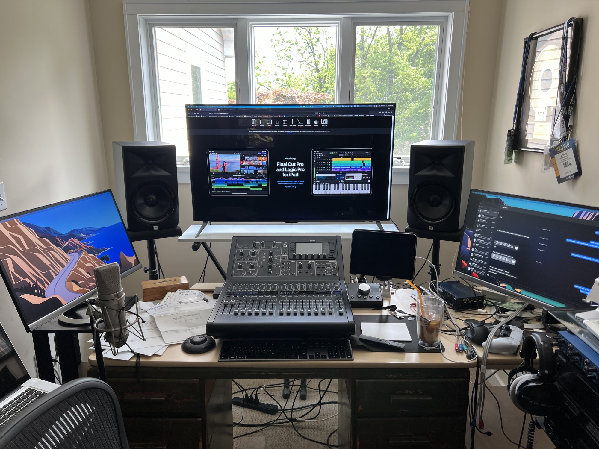

Ah thanks makes sense. I payed for SwitchResX today, must have installed it a few years back so it was past demo mode that’s why it wasnt Working but it didn’t give me the past demo error until I reinstalled it. Now I have 120Hz at 4K and 2k And with hdmi 2.1. sweet! I wonder if there is any advantage to using displayport over hdmi 2.1

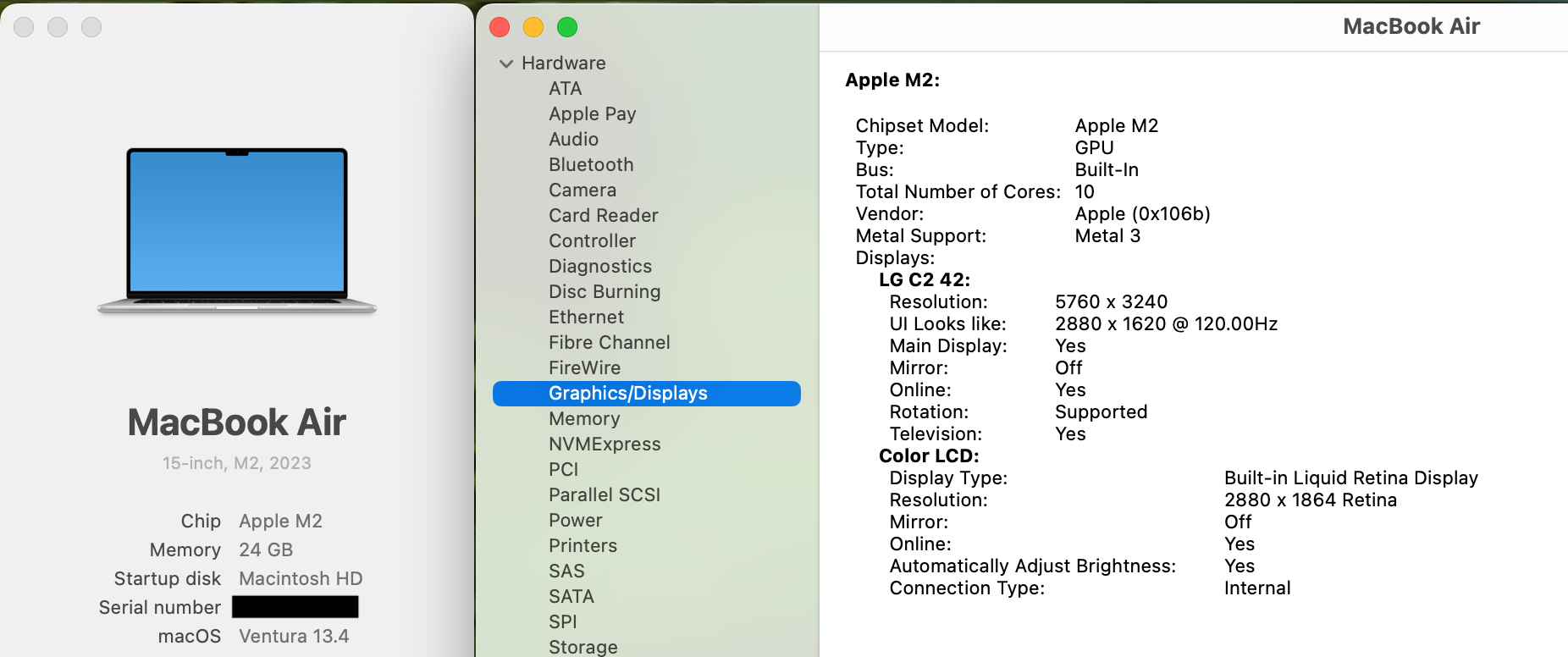

Happy to report new MacBook Air 15 works! Since I can only have one display without DisplayLink, might as well make that display OLED and 120Hz.
Reactions: dabotsonline
