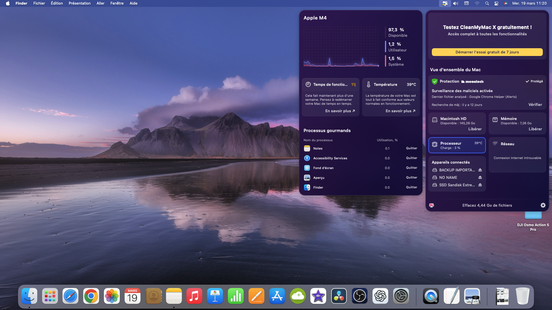

I recommend downloading CleanMyMacX (free version) and checking if your CPU temperature exceeds 50 degrees Celsius while idle. If so, there may indeed be a problem.
Here's the temperature of my M4 mini (base model) while idle.
OP already knows the temps
They have no need of extra software

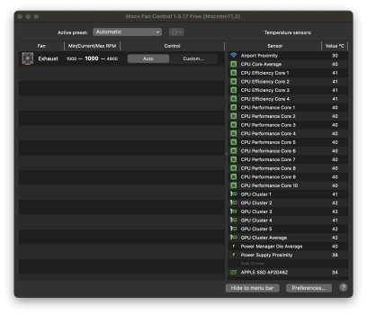

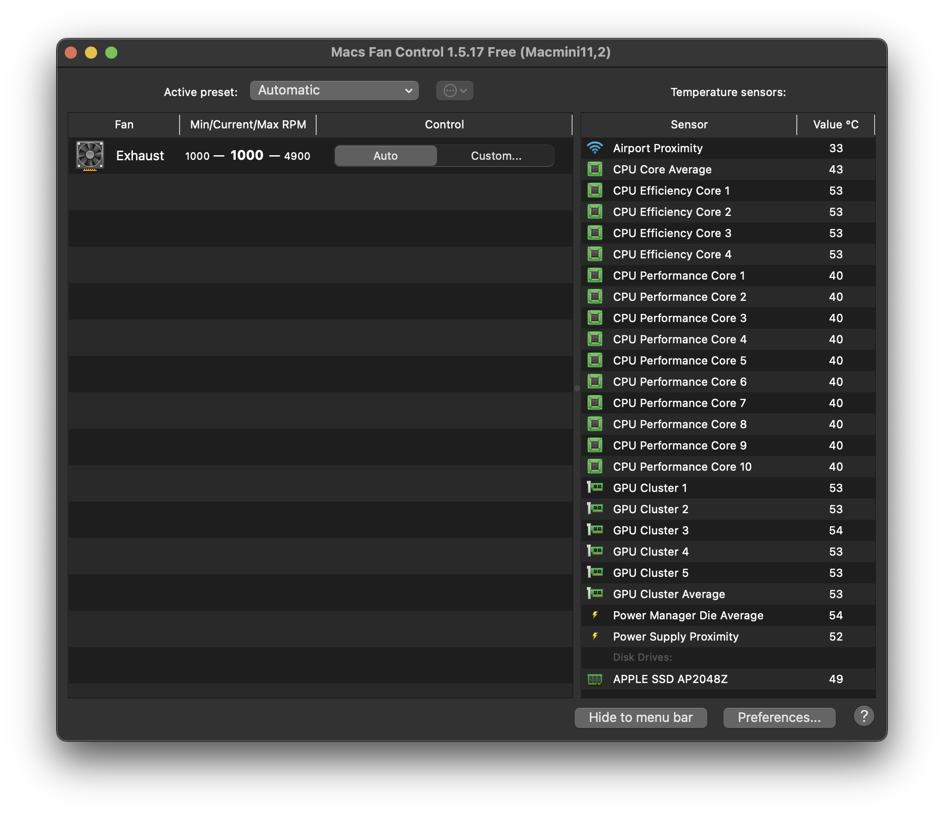

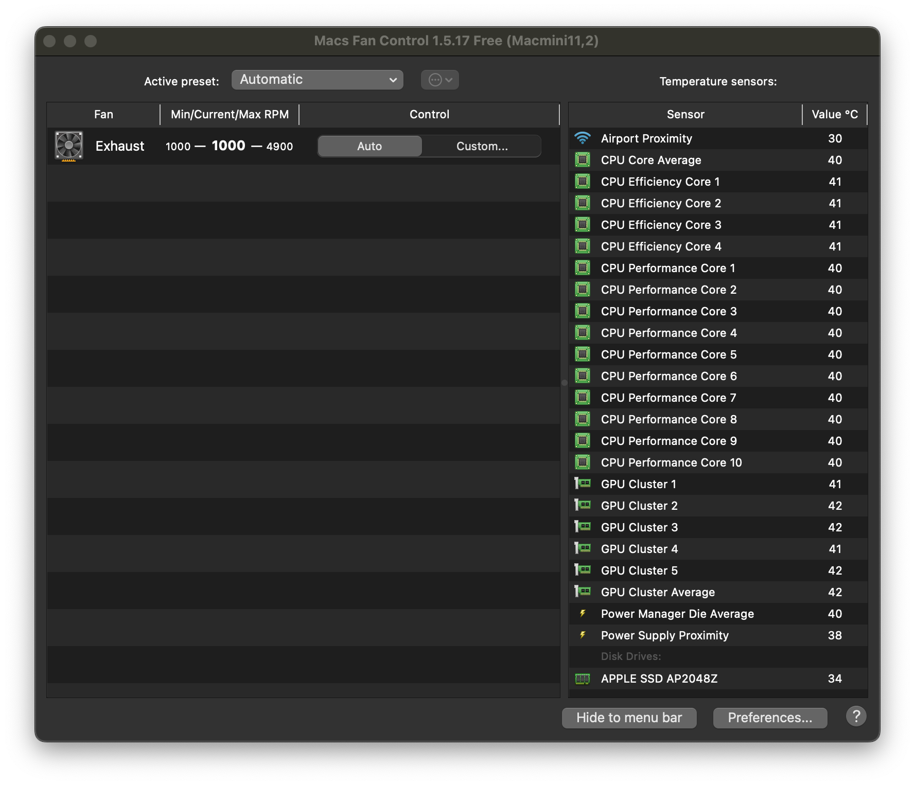

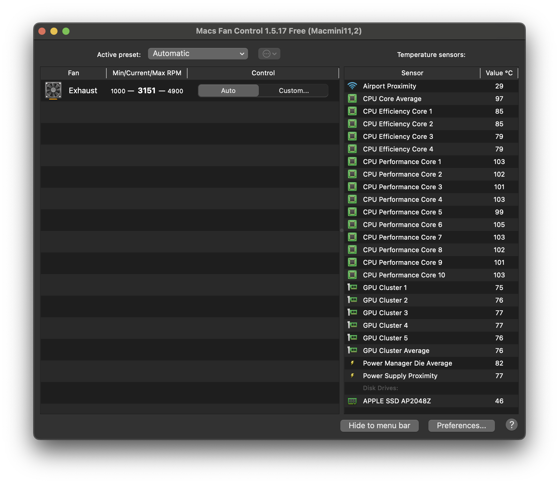

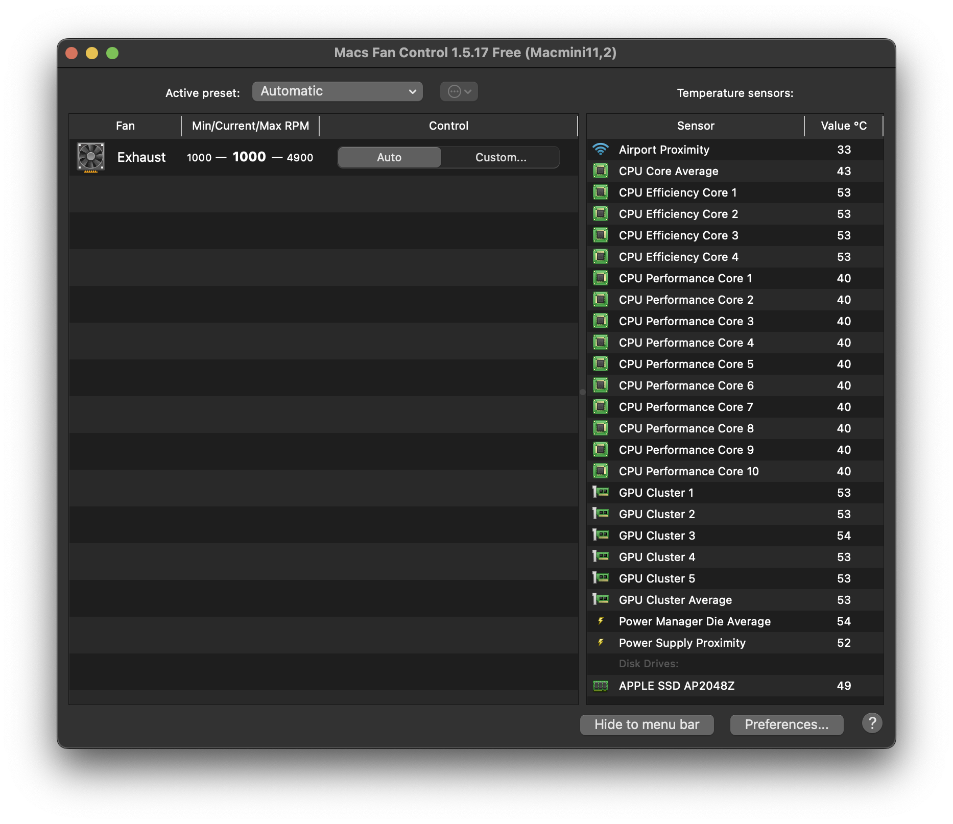

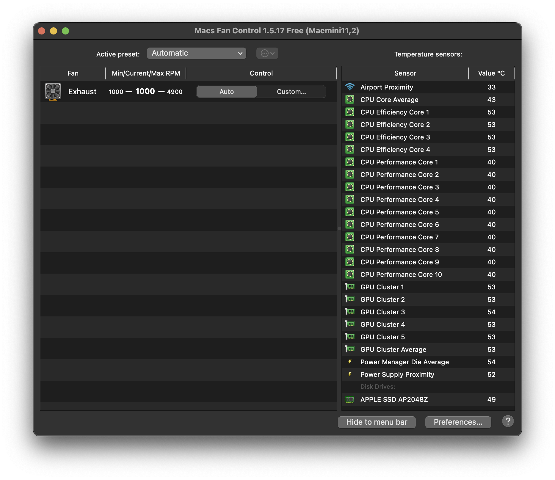

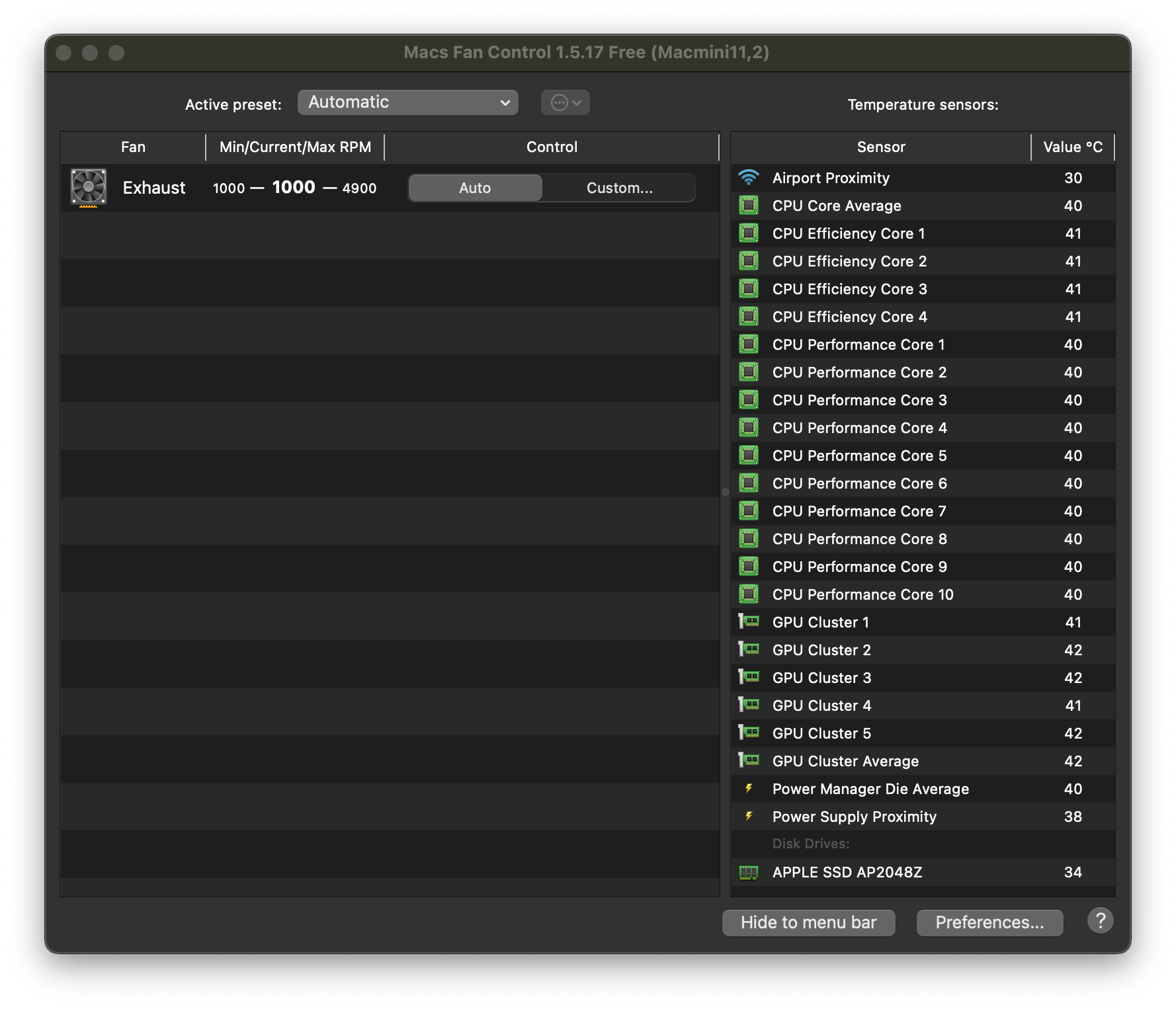

My own samples:
Room/ambient: ~23.5ºC / ~74ºF
First up: Messages, Mail, Safari (MacRumors Forums)
I did a shut down, allowed the mini to cool down for at least 30 minutes, booted and logged into my “Test Bench” account (in practicality a ‘fresh’ account), and let the mini sit idle for about 10 minutes with a display sleep after 2 minutes.
As for enclosure temp… I didn’t measure it with any tool. During the Web browsing usage, I would describe the case as warm. Following the cold boot into an idle, fresh account, I’d say it was very slightly warm.

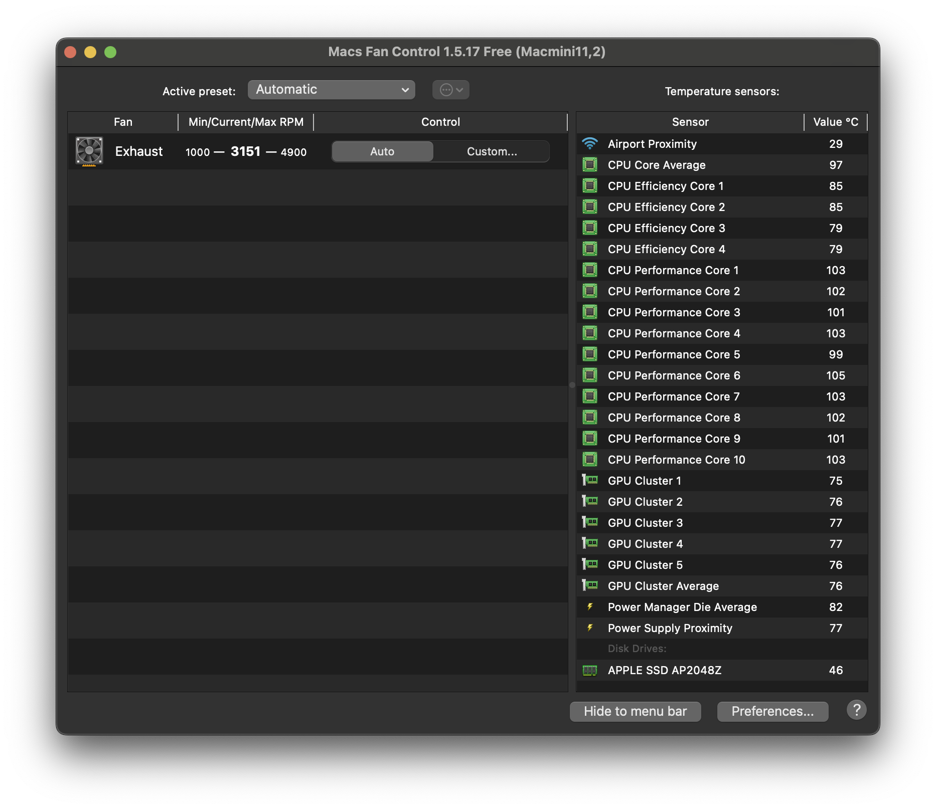

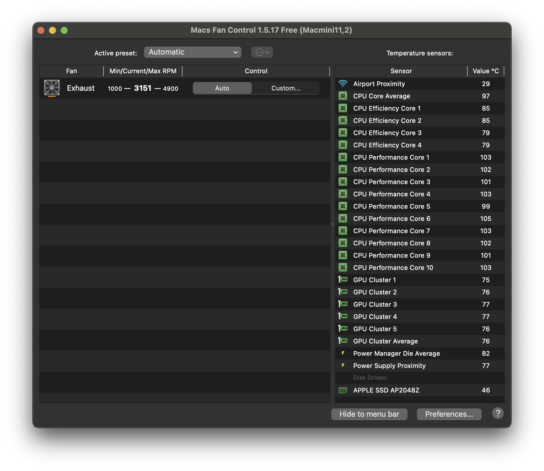

P.S. The case has felt hot but that’s only under high/heavy load tasks.
ADD: Handbrake transcode
