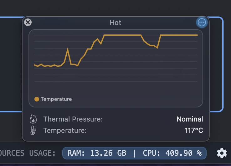

Reference point: running LLMs in LM Studio
Because the app screenshot includes it, I want to highlight thermal state (“Thermal Pressure”).
Nominal
The device's temperature-related conditions (thermals) are at an acceptable level. There is no noticeable negative impact to the user.
Fair
Thermals are minimally elevated. On devices with fans, those fans may become active, audible, and distracting to the user. Energy usage is elevated, potentially reducing battery life.
Serious
Thermals are highly elevated. Fans are active, running at maximum speed, audible, and distracting to the user. System performance may also be impacted as the system begins enacting countermeasures to reduce thermals to a more acceptable level.
Critical
Thermals are significantly elevated. The device needs to cool down.
Just like yours, on my M4 Pro mini, even heavy workloads don’t push the system beyond Apple’s thermal guidelines (i.e., “Nominal”).
