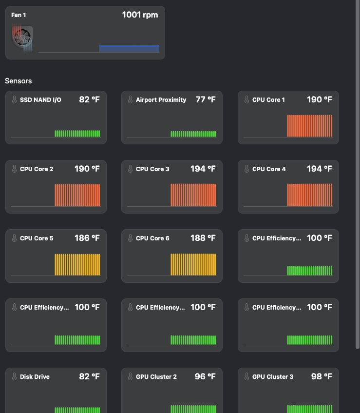

Hello, my mac mini m4 It's getting too hot even when it's idle without any programs running. The only way to stop it from heating up is to log off the user. I've already taken it to an authorized Apple technical support center and they said everything is ok. Does anyone else have this problem? I've tried leaving it in 'low power' mode but the problem persists.
I am having same issue, I also am running MacOs 26 public beta on my Mac Mini M4. I am running one monitor and activity monitor is showing nothing out of the ordinary, this is new unit, just rived last week.
the image you sent reports temperatures that are in normal operating range. i know they may seem higher than you’re used to but it’s nothing to be alarmed about.
If I had just restarted an M4 and let it sit idle 10 minutes doing nothing (and it has been a whole day since installing beta of 26 so re-indexing and media analysis are complete) then those temperatures might be perplexing but still not a malfunction.
What exactly was the state of the machine when you took that reading in the image, and what do you typically do with a machine that would stress it enough to raise the fan speeds?
