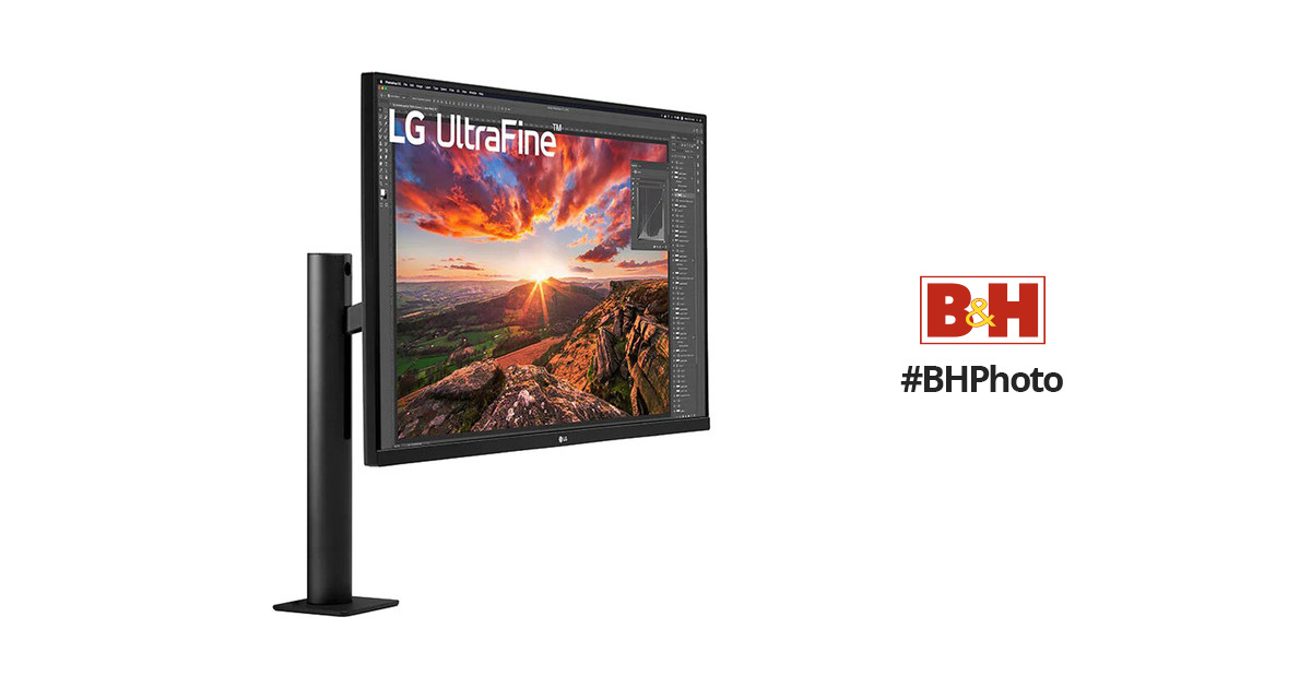

Yup... the UN880-B, here's the link to B&H:I looked up the specs and compared your LG32UN880 to my LG32UL950. I couldn’t locate your description above of LG2UN800, but found UN880, right? Very similar displays — difference being the Thunderbolt 3 technology for the most part.

				I will clarify my connection. I am running USB-C to USB-C (Thunderbolt 3) cable (supplied from LG) from the M1 to the LG. The DisplayPort 1.4 to 1.2 is a setting on the monitor itself. The connection is only stable when I change this setting on the monitor from 1.4 to 1.2. I tried several different cables that support up to 40 GBPs — I can tell when I run 1.4 setting the display and M1 function very FAST — but I have the sleep/wake and restart issues. So perhaps someone can explain more to me as well on what I’m really getting until Apple creates a fix “so they say they’re working on”?Yup... the UN880-B, here's the link to B&H:
Very similar monitors, you're correct TB3 being one of the primary differences.
LG UltraFine Display Ergo 32UN880-B 31.5" 16:9 4K HDR FreeSync IPS Monitor
Buy LG UltraFine Display Ergo 32UN880-B 31.5" 16:9 4K HDR FreeSync IPS Monitor featuring In-Plane Switching (IPS) Panel, HDMI | USB Type-C | DisplayPort Inputs, 3840 x 2160 4K UHD Resolution, 1000:1 Static Contrast Ratio, 350 cd/m² Brightness, 178°/178° Viewing Angles, 5 ms Response Time (GtG)...www.bhphotovideo.com
So it randomly restarts with DP 1.4? Interesting... that was going to be my second option had the HDMI not worked. Curious.... since you have a really nice Thunderbolt Display, why aren't you using the 40 Gbps Thunderbolt to Thunderbolt connection? I guess DP 1.4's 38 Gbps is almost the same.
