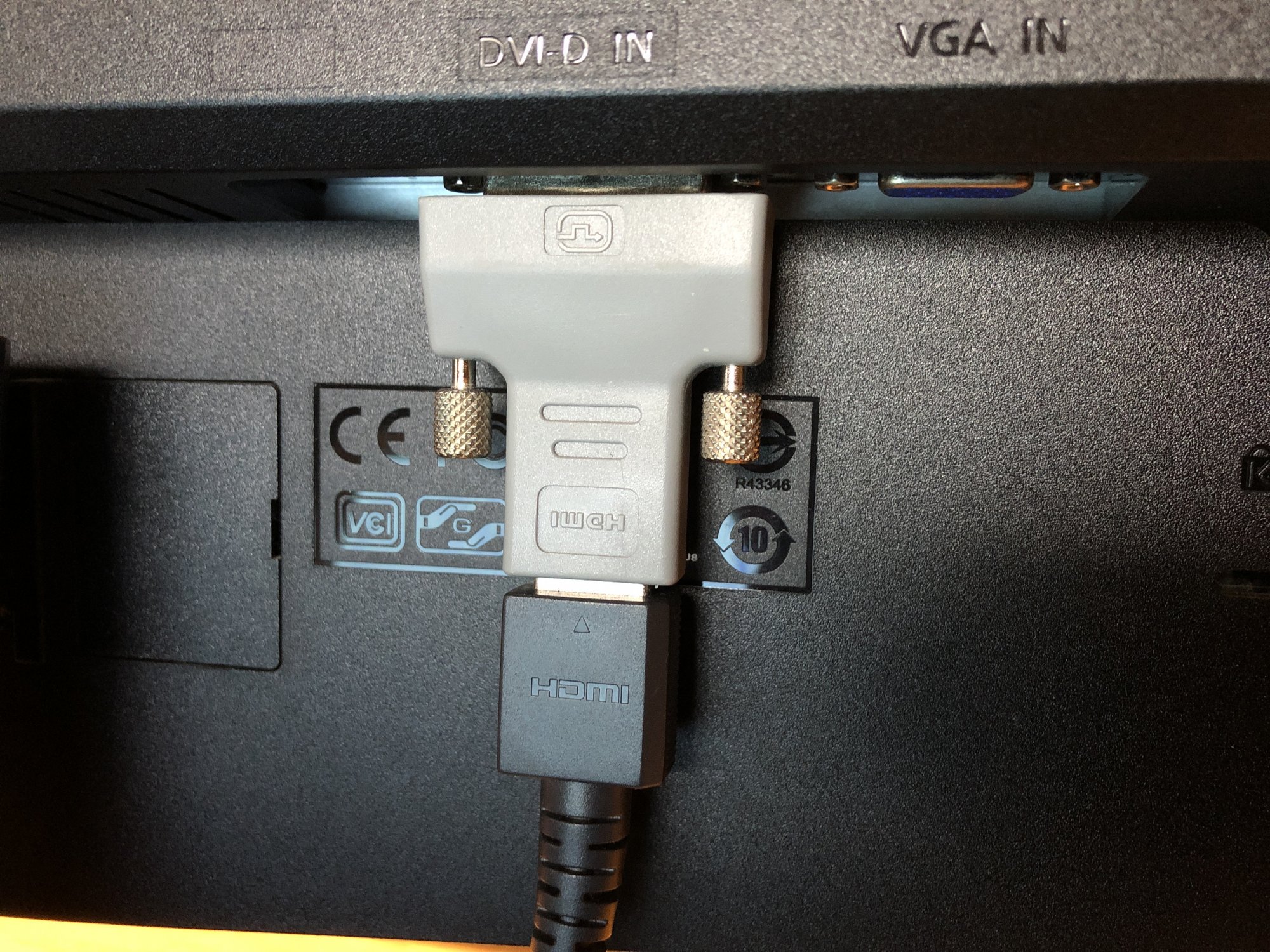

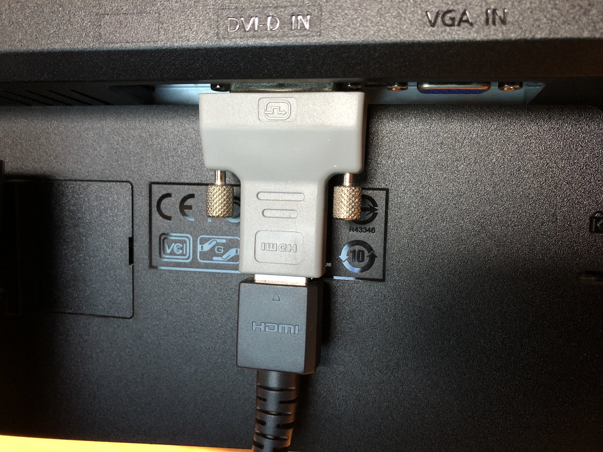

Anyone else having an issue connecting the HDMI port on their M1 mini to a monitor with only a DVI port?
The monitor in question is an Acer G235H (1080p) and I’m connecting with an HDMI to DVI adapter attached to the monitor. The monitor knows there is a connection (blue light), but all I get is a black screen.
The same cable and adapter works great with my MacBook Pro 2015 via HDMI port.
