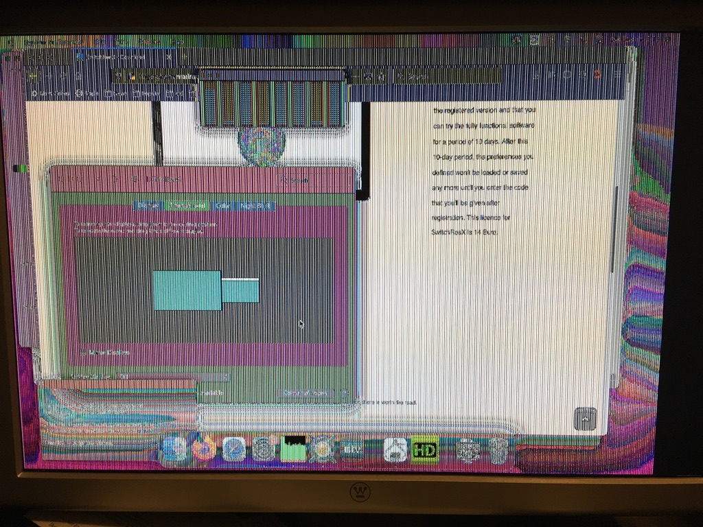

I've got an old Westinghouse 1440x900 19" and this is what I get with HDMI->DVI-D on my M1. Works fine on my old Mac. Works fine with a USB-C to DVI-D adapter. Tried different resolutions and same thing.
@saulinpa : This is exactly what I see on one of the two HP display, the other one just stays plain black.
