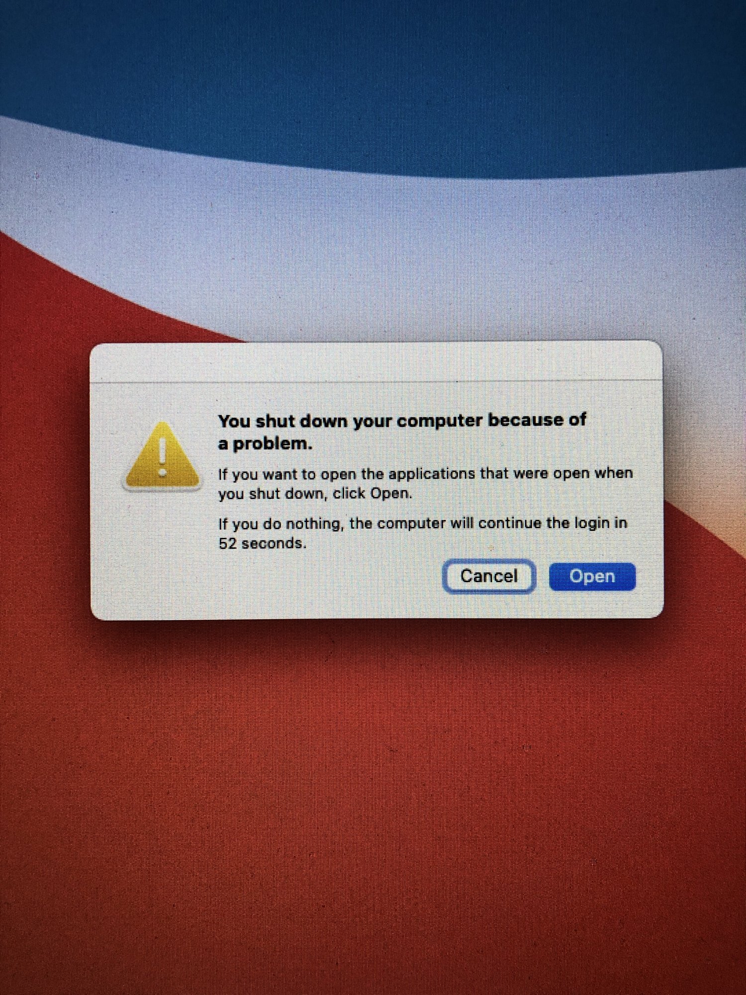

In my case, I can successfully restart many times, without any issues (I'm presented every time with the "you shut down your computer because of a problem." error). As soon as I do a regular shut down, I'm stuck at the Proress Bar only once and after a forced shut down, I can start my Mac as usual.

I tried 10 reboots so far, every time I'm welcomed by the "you shut down your computer because of a problem." error upon login. If I do a regular shutdown, I'm stuck on frozen Progress Bar and the cycle repeats again.

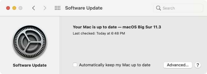

From 11.2.3, I updated to 11.3 with Software Update. It got stuck once at the progress bar (see below why) forcing me to manually shutdown from the power button. After power-up, it went through installation process rebooting twice and I was presented with the 11.3 setup screen.

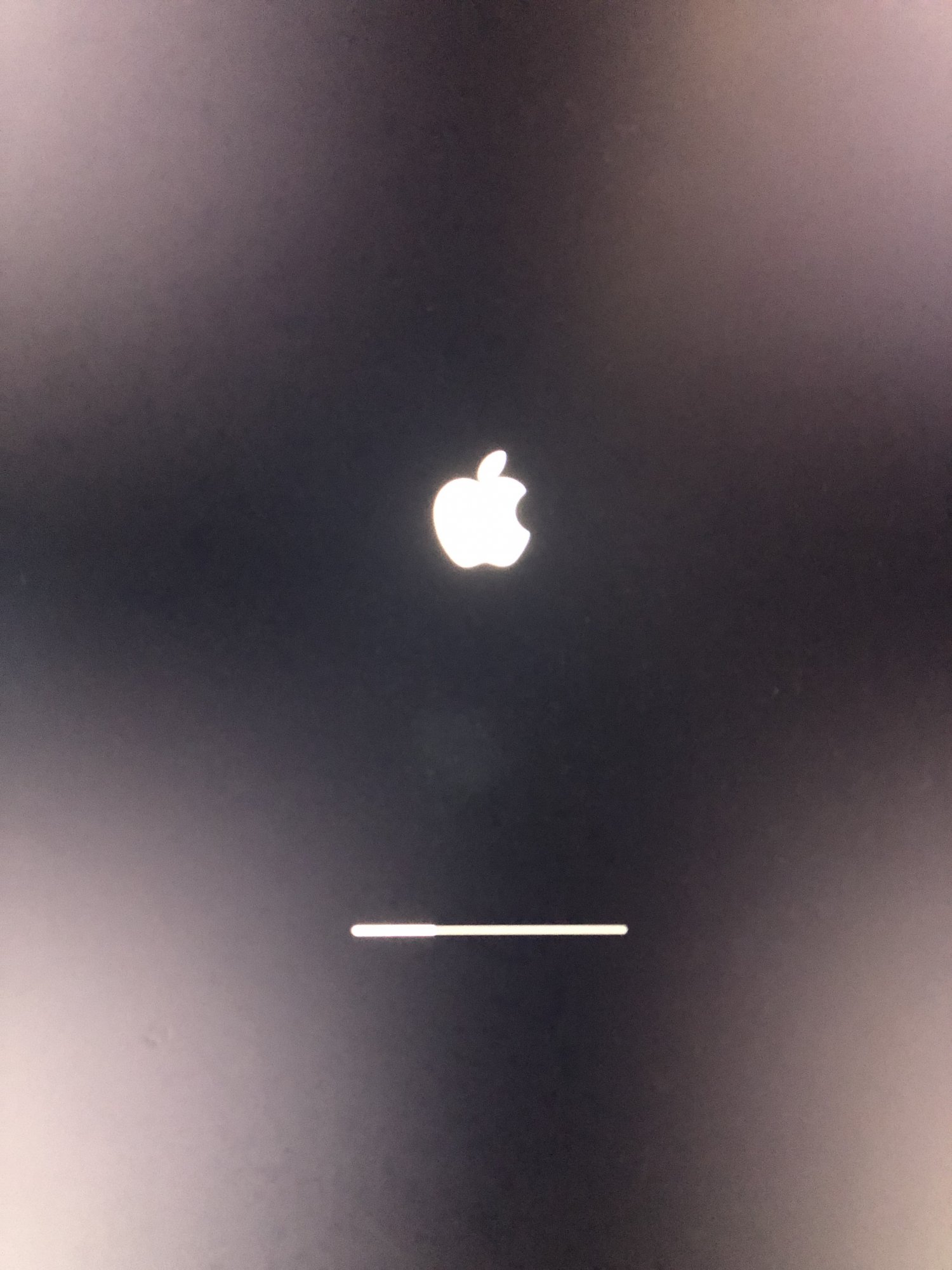

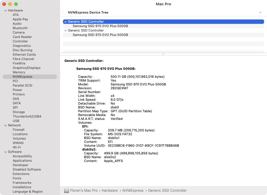

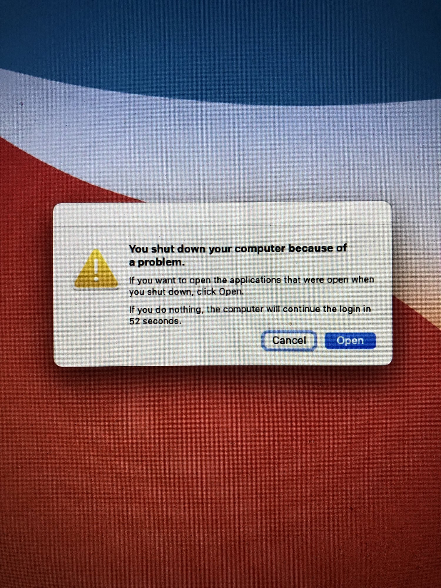

After installation, I determined the following pattern: If there are no computer problems previously detected, the reboot will get stuck at Progress Bar, no matter what. (that explains why upon initial upgrade, Progress Bar got stuck). In other words, everything works if I'm welcomed by the "you shut down your computer because of a problem." error. Once I'm logged in 11.3 and I try to shutdown the Mac (which in 11.2.3 would fix this error message), I'm stuck at Progress Bar boot screen. As long as I don't shutdown, which will reset the shut down error, I can reboot fine many times. I also have a BootROM reconstructed by @tsialex, which I refreshed one month ago.

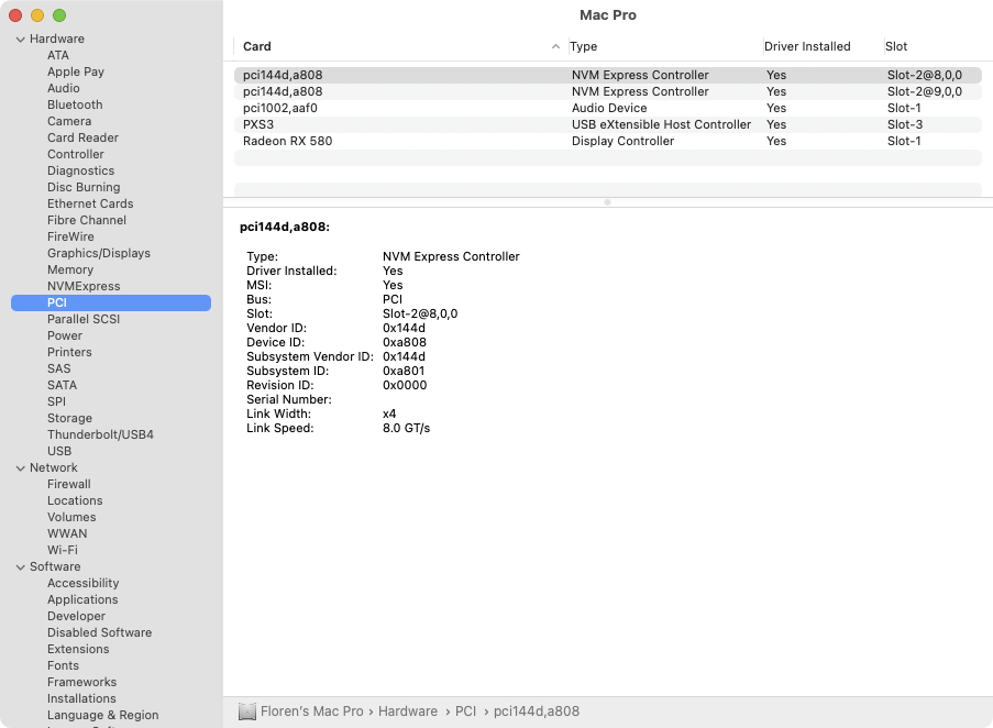

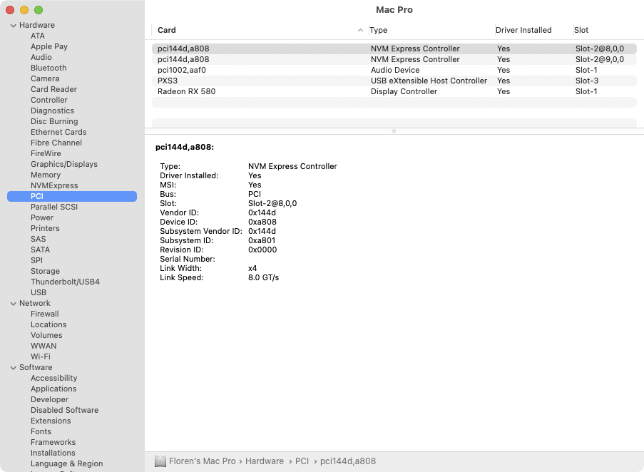

In my case, I might have better success than others because the chip used into Syba SI-PEX40129, which is the same as HighPoint 7101A and reported to have proper NVMe functionality.
I'm able to constantly repeat this exact pattern every time. Anything else is functional in 11.3, I'm able to login with with my Apple Watch, perform AirDrop, Wifi, Bluetooth, etc.

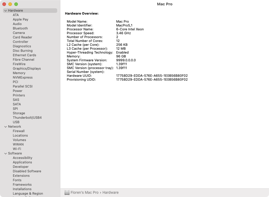

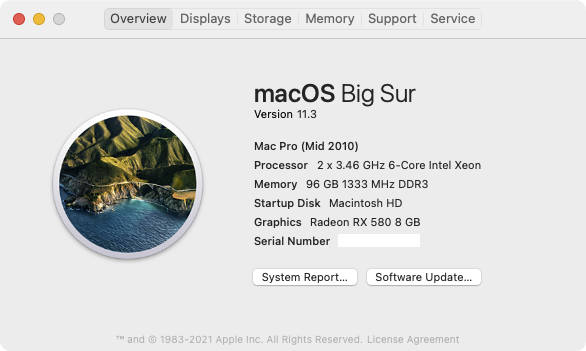

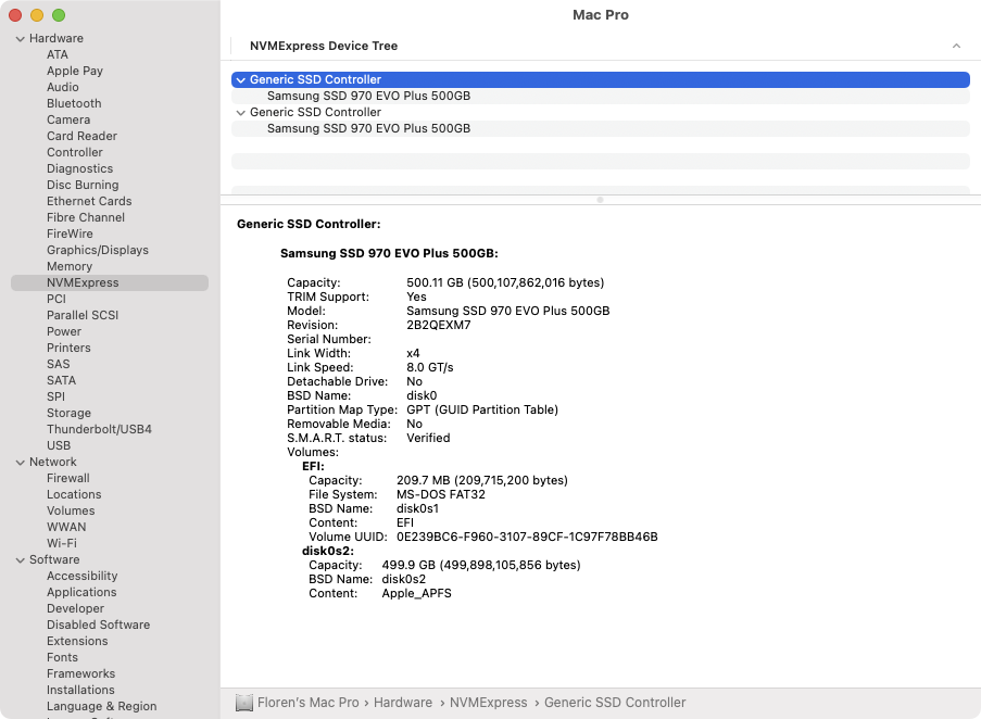

View attachment 1764557View attachment 1764560

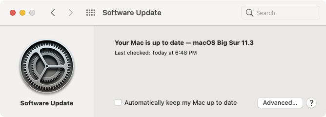

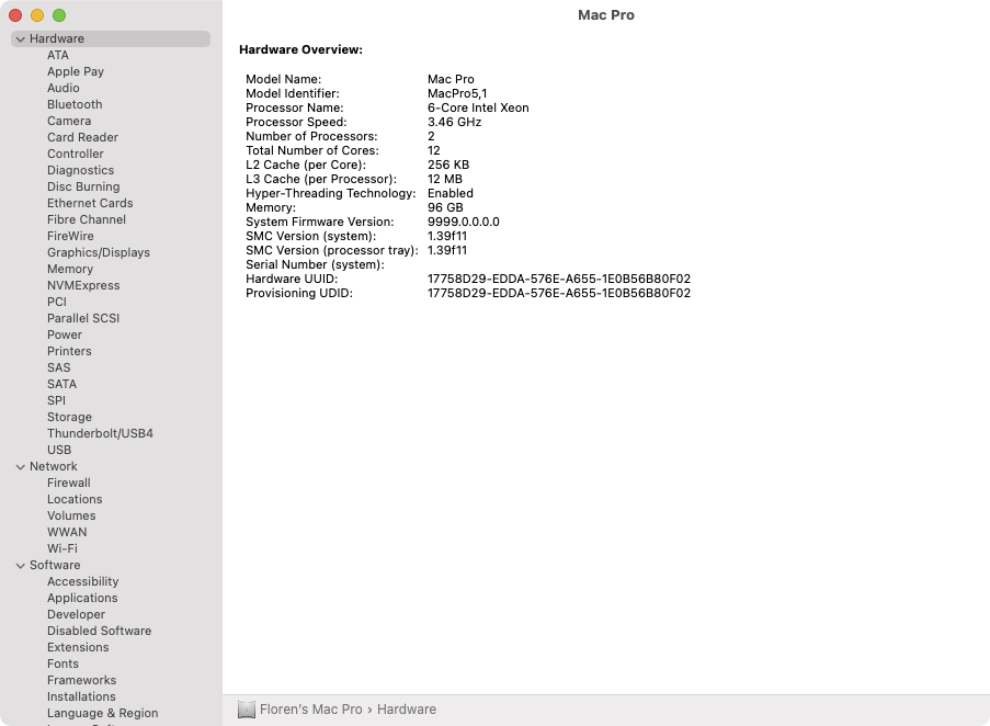

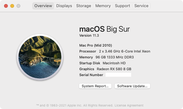

Posting now from 11.3, these screenshots:
Does anyone have any additional info about the "You shut down your computer because of a problem" issue? The fact that it's also linked to whether or not updates work without stalling - apparently, good research @TECK ! - makes it sound definitely worth addressing - within OC or wherever - if possible.
I can confirm that I get the same error a lot on a MacBookPro10,2 (so it's definitely not just a MacPro issue).
I'm not 100% sure if the error is caused by OC or not (e.g. my MBP can boot and run BS just fine without OC, just with NVRAM "boot-args=-no_compat_check"; it just won't fetch or install updates without OC), but I haven't tested enough to be sure if the error happens anyway without OC.
I also don't currently know where the error condition is stored (by Apple; is it NVRAM?), nor what (more exactly) normally triggers it to be stored - if anyone can help with any additional info on that?
