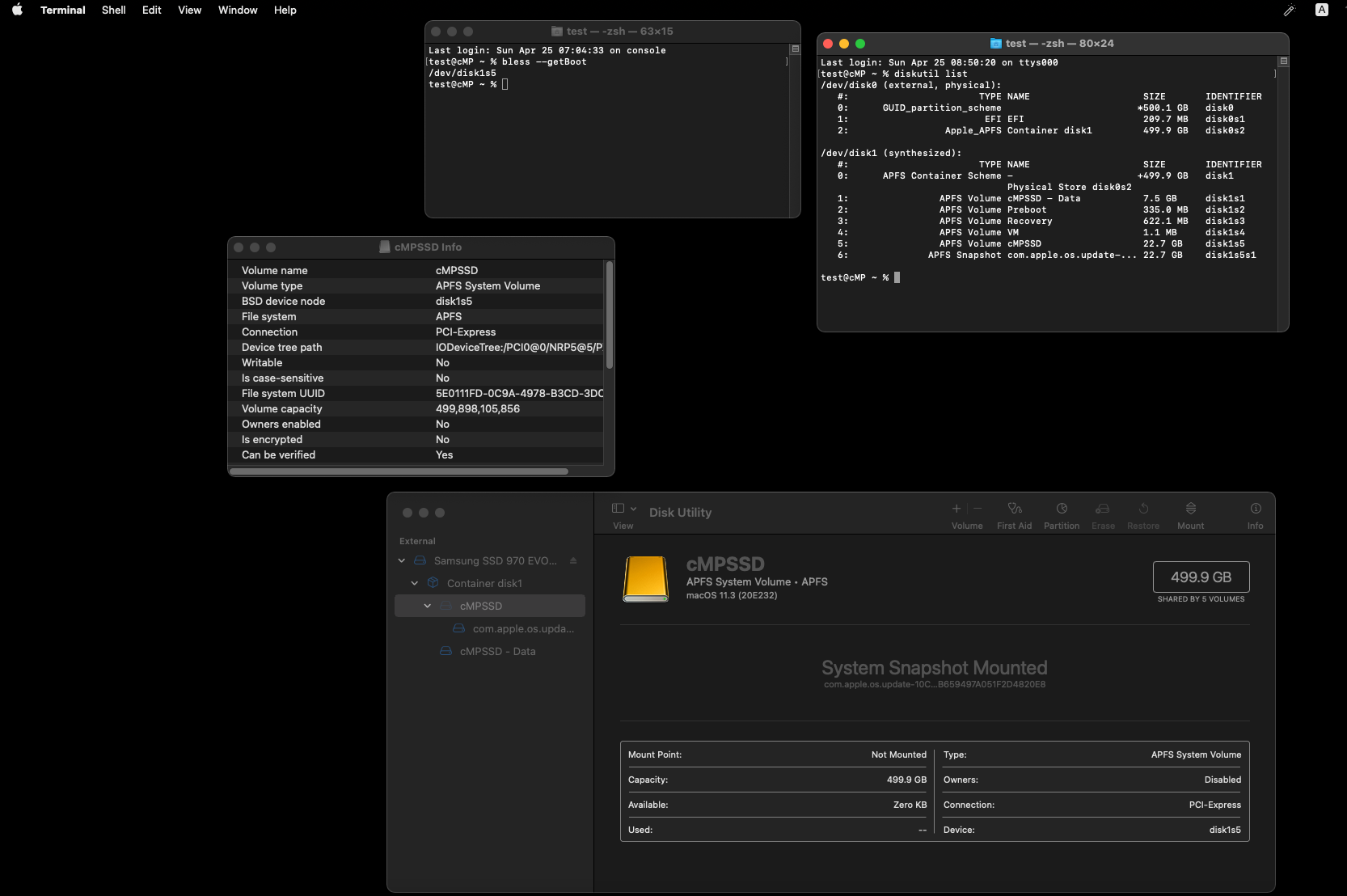

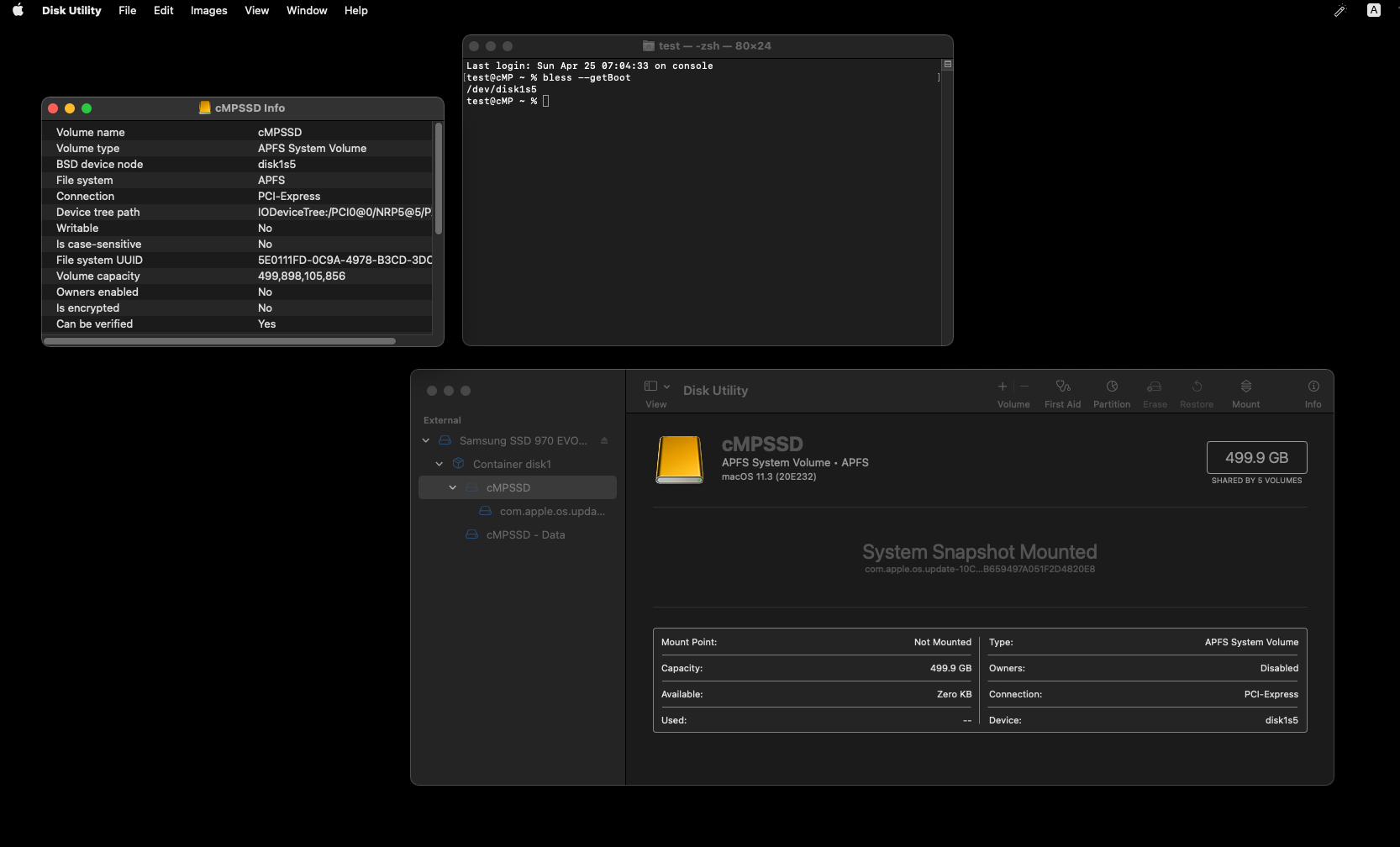

Btw, it's not just NVMe. Let's be crystal clear on this. Anything connected to a PCIe controller is not booting 11.3/11.4b1 reliably.
Whether "dubious" or not here's proof. 11.3 RC is booting reliably using HighPoint 7101A-1.
The issue being discussed here is MP5,1 and PCIe drives with 11.3/11.4b1, from your signature you are showing a MP3,1, no? I'm failing to see why this exactly helps us since the MP3,1 platform is completely different, the NVMe crash is a consequence, not a cause, and we already have multiple reports of other types of PCIe drives also not working with a MP5,1 and 11.3/11.4b1.
I think so. In the following linked post he is a bit more specific about the used system and wrote clearly about his 3,1… So it’s just another dubious proof, because it’s created on a wrong machine.
https://forums.macrumors.com/thread...unsupported-macs-thread.2242172/post-29807829
There is a misunderstanding—I am NOT and have NEVER claimed this works on a 5,1. As I SEVERAL TIMES clearly posted as well as described in the signature, this is a cMP 3,1.

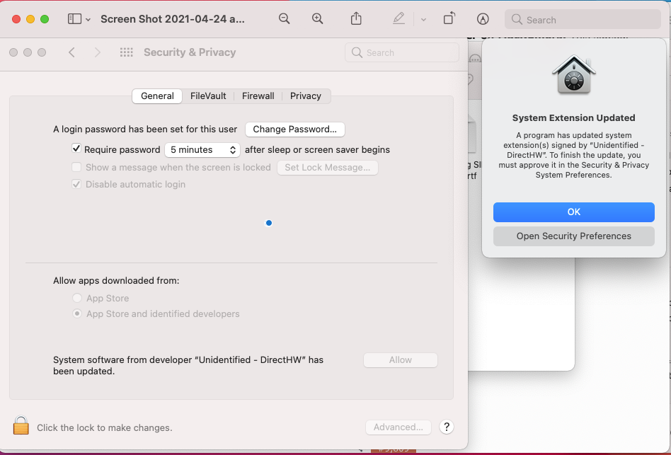

I can get you a bootrom dump and have offered to do so for startergo in another thread. The problem is that the three available tools for dumping the bootrom (ROMtool, Darwin Dumper and Macshrauber) all use the DirectHW.kext, which is no longer supported by 11.3 RC and if an attempt is made to use these tools, the installed kext prevents the Mac booting at the next restart. I suppose the solution is to install another boot disk with High Sierra or Mojave and run ROMtool, etc., from there. If you REALLY DO need this bootrom code to solve the problem, I'll do this in the coming week, but I first have to get another NVMe SSD and build a High Sierra or Mojave USB installer, etc. Let me know.

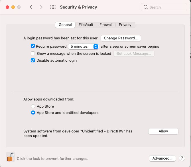

The ROMTool is working in BS11.4. You have to reboot once after you allow extension. SIP must be disabled as always with the ROMtool.
Sorry but not with mine—yes, I have seen those screens too but reboot stalls. This OCLP 0.0.0.22 install is with SIP disabled but after I allow ROMtool extension install in Sys Prefs—Security & Privacy and reboot, the boot stalls about 1/2 way and the cMP3,1 is "stuck". I then have to use rm -ref in Safe Boot mode to remove the kext and then I can boot again.

For those in this thread who have "trust issues" with what other members write about PCIe booting (on a cMP 3,1):

it depends also on the kext you use. I included a kext what run on Big Sur if approved. Also this kext got Dosdude's Romtool to work in BS if copied into ROMTool Application Support folder. This kext is also included into my package.
  • DirectHW.kext.zip
Unfortunately even after replacing both kexts I still have ionvme panic if my expansion board with the OWC PCIE is attached. Also it hangs if ethernet is connected. This tells me that Ionvme is just a red Herring. It needs to be tested by more people though.
