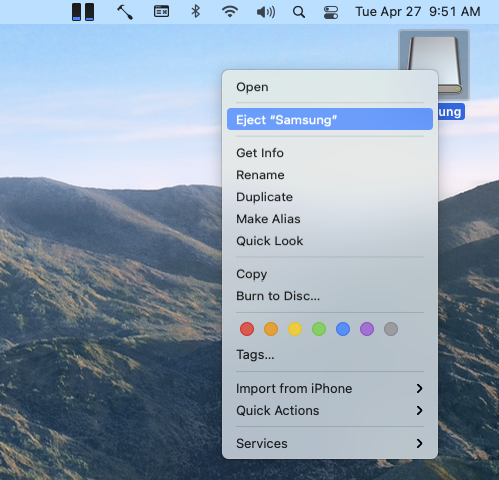

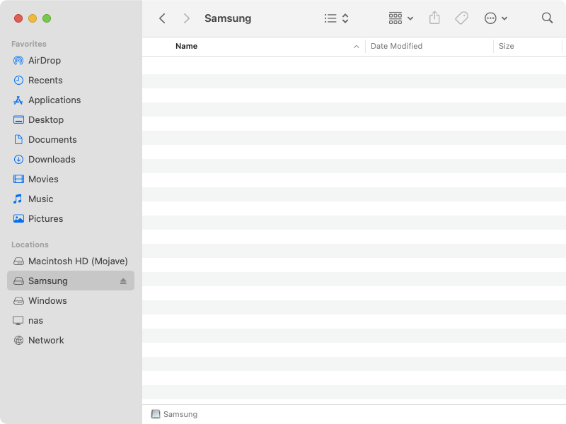

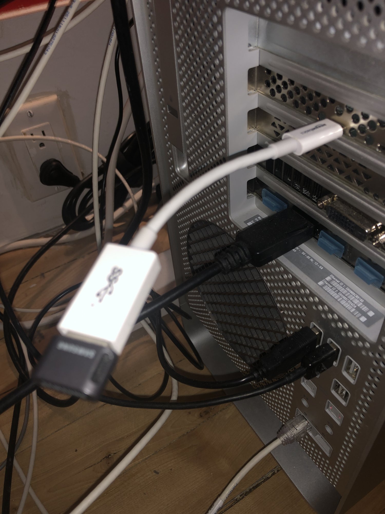

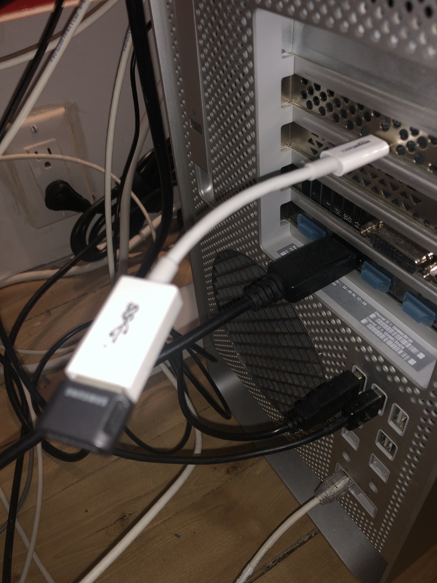

Updated from 11.2.3 to 11.3 successfully only after clearing slots 3 and 4 (Slot 3 was already empty but slot 4 had a Sonnet USB-C 2-port card).
I have a Sonnet Allegro USB3C-2PM-E fully functional in Slot 3. Sapphire Pulse RX 580 in Slot 1, Syba SI-PEX40129 with 2 Samsung 970 EVO Plus in Slot 2, Slot 4 empty. I never removed or changed any hardware components during 11.3 upgrade.
I attached a USB3 stick to it and it immediately showed on my desktop:
