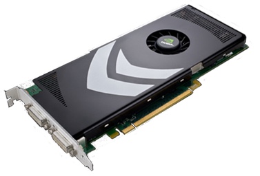

This is the 8800GT Mac version. It only has Nvidia branding. The 8800 GT is an ok card for general use but it is noisy and runs hot. ImageUploadedByTapatalk1414169429.167262.jpg
I don't know about the Sapphire 7950.
Dell servers used nearly identical 8800gts, down to same EEPROM chip.
Easiest way to know real Apple part is lack of S-Video port. All 8800gts are ticking time bombs at this point.

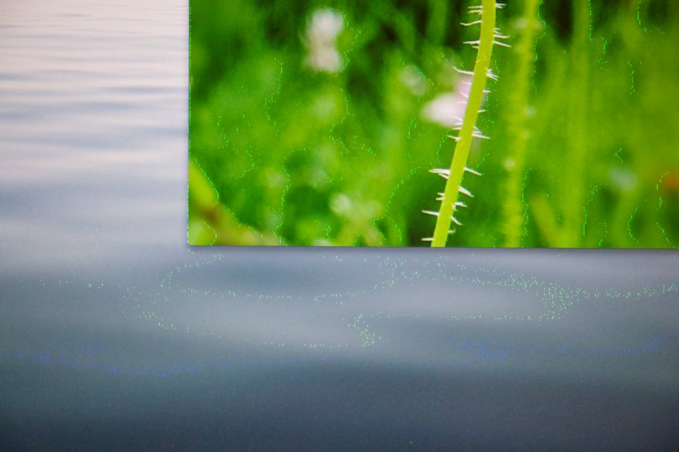

Hi All
First post here, but I've tried to search this forum and the internet for a solution to my problem
History : Upgraded my Mac Pro 1,1 to Mavericks through the help of (Tiamo thank you ) and installed Nvidia 8800t graphics card, (bought from ebay), here is what I'm seeing, green dots everywhere, its intermittent though
Any help would be welcome, please

This is most likely a problem with the cable or the port on the card. Have you tried the other port?
Hi Hennesie2000
I've tried the other port, no joy, tried another cable no joy, tried another card as well, still same problem .

I think I solved the problem, tried my cable from the Radeon 1900 xt, it seems to be working OK .
Two faulty cables from ebay, not good enough
