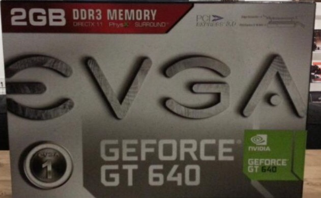

Found a EVGA GeForce GT 640 locally, if I install mavericks or yosemite this should work no problem? No Apple logo but other then that fully compatible?

10.7.5 added native support for the NVIDIA 600 series.

A 640 is a 640. I am using a 600 series with Yosemite 10.10.1.

I got a PC version (unflashed) of an ASUS NVIDIA GeForce GT 640 2048 MB for $99 at Fry's and it worked in Mavericks and Yosemite no problems, other than no boot screen. I "fixed" that by getting a SSD, so now it boots in 17 seconds, which makes the lack of a boot screen much more bearable
