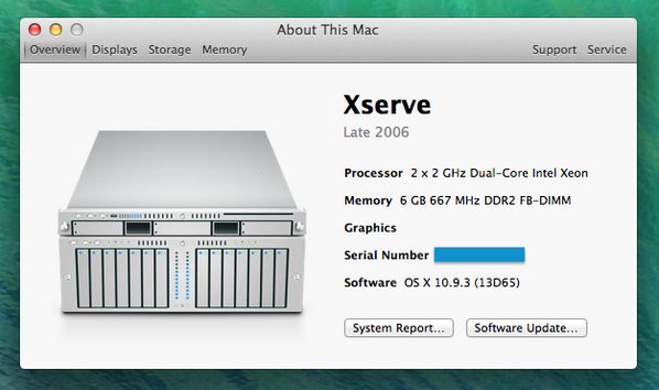

Just another success story, this time on an Xserve1,1. This one doesn't have a graphics card of any kind, but Mavericks works perfectly well. No errors in the Console whatsoever, all of the hardware recognised and running.
Oh, except for the CPU usage lights on the front panel - I'll need to add hwmond back into the system from a Lion install for that to come back to life. But that's the same for the Xserve3,1 which is officially supported.

Wow thats cool! What do you use the Xserve for?

It was originally our MCX (desktop management) and file server, but when Mavericks came out, the clients wouldn't listen to the MCX info coming from Snow Leopard Server, while the same coming from a Mavericks install on a Mac mini worked fine. So it got demoted, and then we had authentication issues with it and Active Directory, so it lost it's file serving job too.
I've been running Mavericks Server on another system with this bootloader for some time and it's been perfect, so I'm considering rolling services back onto the Xserve again. The Mac mini is not a great solution as a server, though it can handle light jobs just fine.
I wish Apple would bring the Xserve back, but then so much of what the Server software does is so lightweight (profiles) or better handled by a dedicated Linux box (file serving) that I can't see it happening. Mac minis and Mac Pros are just not the right tools for the job.
Having to quote myself here, but hwmond no longer functions under Mavericks. It relies on having access to the CoreRAID framework for monitoring RAID volumes and flashing the appropriate warning LEDs when the array is degraded. CoreRAID (along with everything else) was changed to 64-bit only in Mavericks, so the 32-bit hwmond binary can't play with it any more. :(

Sad times. Those indicators still work for boot selection, but when the OS is up and running they're now dark.

No arguments there - this Xserve is still trucking along. Set up a few of the Server services, including File Sharing and Caching Server and it's proving itself to be an excellent piece of kit again.
It was specced with an extra four gigabit network ports, which are now configured for link aggregation again, so its throughput for data-heavy network services is marvellous. :)
