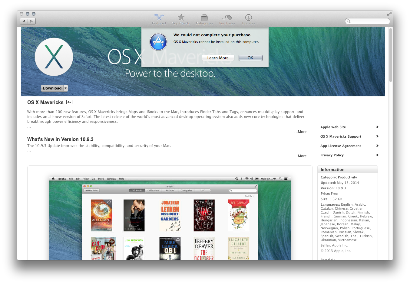

That's what I ended up doing - I had 10.9.2 installed on my MacPro1,1 (ATI HD 4870) using the Tiamo boot.efi in mid-April. (I had a ton of trouble using a USB flash drive to do the install, but eventually used a spare hard disk and it worked perfectly on my system).
So I downloaded the 10.9.3 delta update and installed that. No problem.
Now, I can't seem to get the App Store application to rescan my system and remove the upgrade indicator!! This is slightly annoying, so if anyone knows how to get this removed.... I need to trick it to re-scan, or, remove the queued upgrade, or somehow get it to see that I'm not a MacPro1,1.
