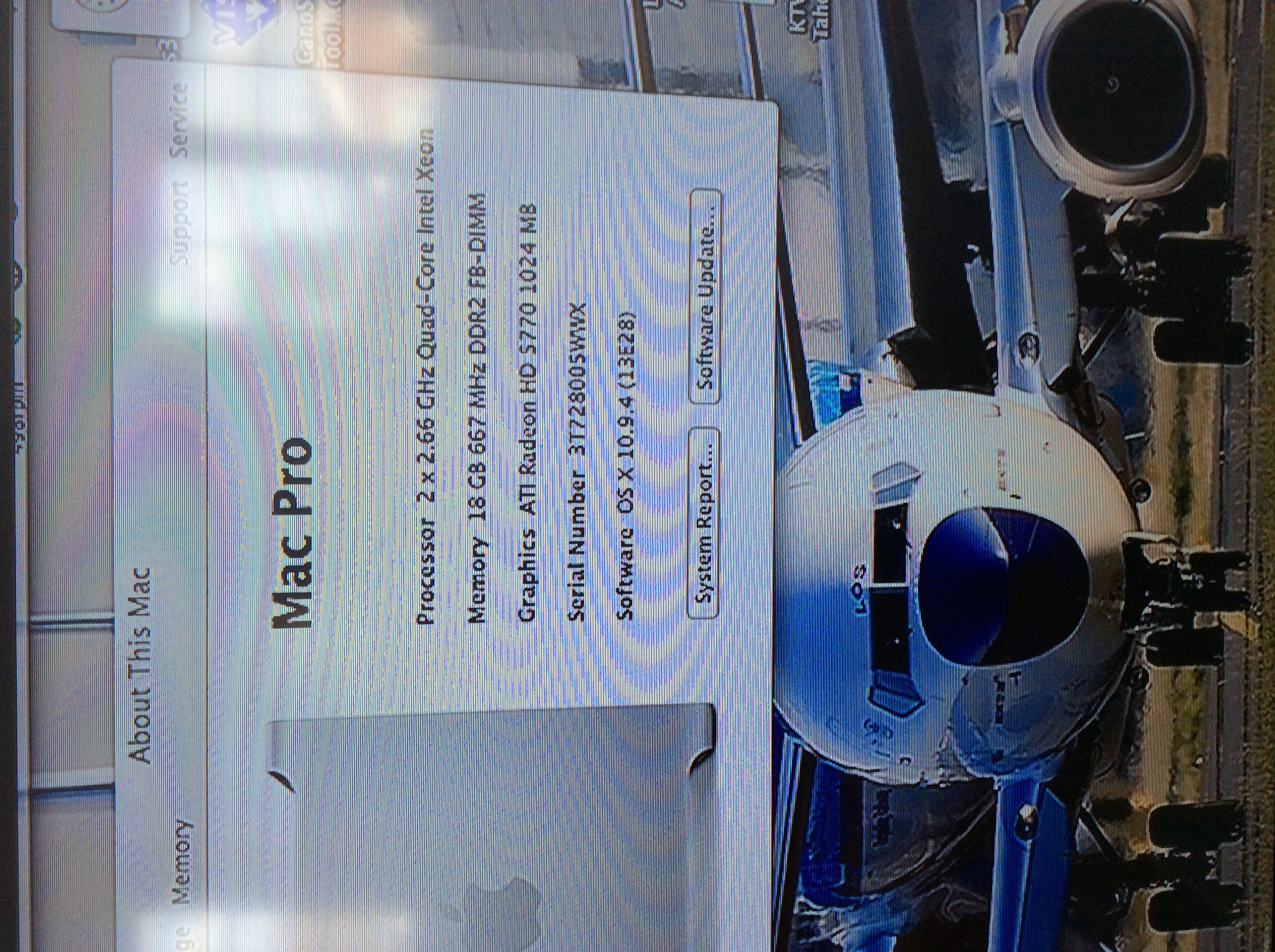

Blow me down.
Used ( as a last resort) the SFOTT app, and it worked. I officially have 10.9.4 mavericks on my Mac Pro 2.1 ( was a 1.1 but applied the upgrade). Not sure why it worked, but it did, so another star for Tiamo and the SFOTT team
