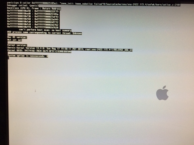

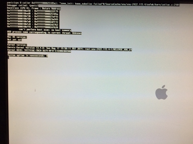

Success ! but now getting KP when upgrading RAM
After reading so many success stories I thought I'd take the plunge and add my experience with you guys.
My base build prior to the challenge was a macpro1,1 with 2 x 3GHz Dual Core Xeon running on 250GB Sata HDD with 10.6.8, Geforce 7300GT, 4GB Ram (8x512MB).
Now have successfully upgraded to MacPro2,1 with 2 x 2.66Ghz Quad Core Xeon running on a Samsung Evo 840 250GB SSD 10.9.5, 250GB Sata HDD 10.6.8, XFX ATI HD6870 Black Edition, 4GB Ram (8x512MB)
Now trying to get my ram upgrade working without success - it's 6 x 2GB Kingston Ram (KTA-MP667AK2/4G) which boots into 10.6.8 fine no problems but does not all work in 10.9.5 - just getting KP every single time I boot with the attached KP errors.
Since trying to play around with the different ram configurations the most amount of ram that works with 10.9.5 is 7GB which is 2 x 2GB and 6 x 512MB Ram.
Not sure if anyone has come across this before but I'm at a lost to why it works fine in OSX 10.6.8 and not mavericks!
Have not reset the PRAM so will do this later today when I get back from work!

^It's not the Mavericks fault. Drivers didn't even get loaded. It's more like hardware issue (loose connection, cable or so, short-out etc). It doesn't look like RAM problem either. You'd get a different KP log in such case. Check all possible connections first.
Thanks for the advice 666sheep - I'll recheck everything again - maybe it might be that I'm running my sata bluray drive and ssd through one molex to split sata power cable, or maybe running both geforce and ati display cards are causing the issue - not sure but I'll remove as much as possible before trying again.
Well spent several hrs trying to get these ram working with my build without success, I've literarily taken everything back to my original base build without replacing the cpu's but still not able to install any more than 4gb ram - I'm leaning towards a faulty ram but I ask myself why does it boot in 10.6.8 fine even put in some 4gb Hp ram in there with the 12gb Kingston ram and it still picks up 16gb, even went and did a fresh install of 10.9.4 but same kp. Pram zapped it several times and it seems to boot into 10.9.5 with 2x2gb and 6x512mb but even with this the system was unstable I.e applications would hang, random reboots, fans going wild, etc... Now back with my 8x512mb original ram and system is working again - never had an issue before with ram behaving so badly...##
Well it looks like I've found out the solution to this and was a school boy error. The boot.efi used was somehow restricted to a max 4gb replaced the two files and now able to boot with 16gb!
