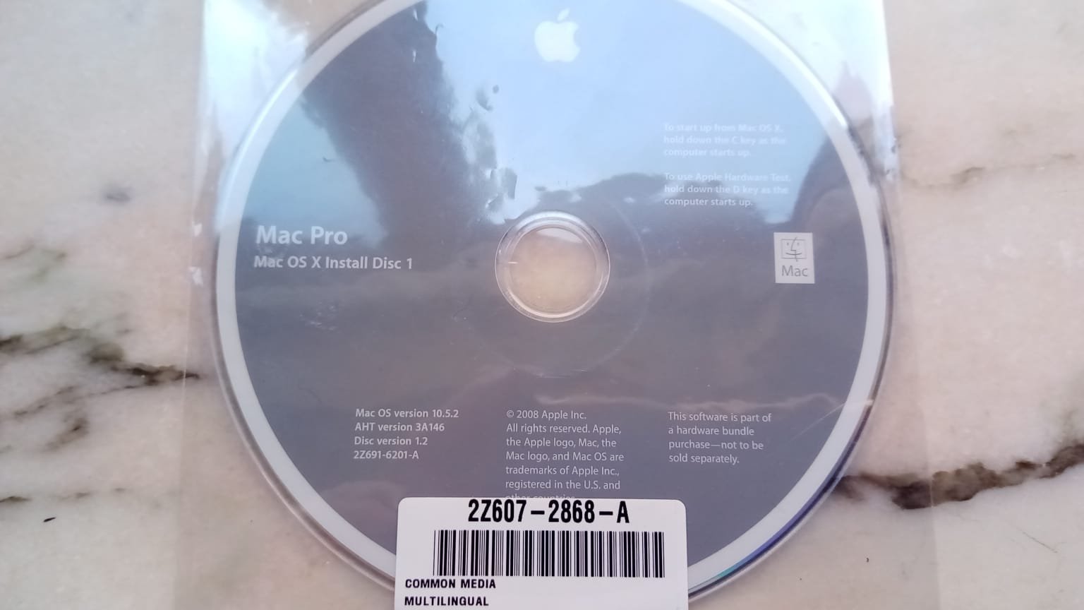

So I removed the gtx 960 and also the ssd with windows 7 installed.
I installed the original gt120 arrived yesterday x mac pro 3.1, connected the gt120 cable to the monitor and put a blank ssd, inserted the original installation dvd 1 mac pro 3.1 and started the mac pro.
Nothing to do black screen and nothing can be seen, the DVD can be heard spinning for a few minutes and then stops, I also tried to change the DVD player instead of the integrated one on the mac pro I connected an external one, nothing changes.
After restarting with DVD inserted I clicked ALT then I tried with C and then I tried to restart without clicking anything but always black screen, then either the gt120 does not work or it is not his or what else could it be ???
I'm going crazy!

Another possibility is that the DVD installer is previous to 10.5.6 .
The GT120 (if OEM) should work with OS 10.5.6 up to 10.13.6

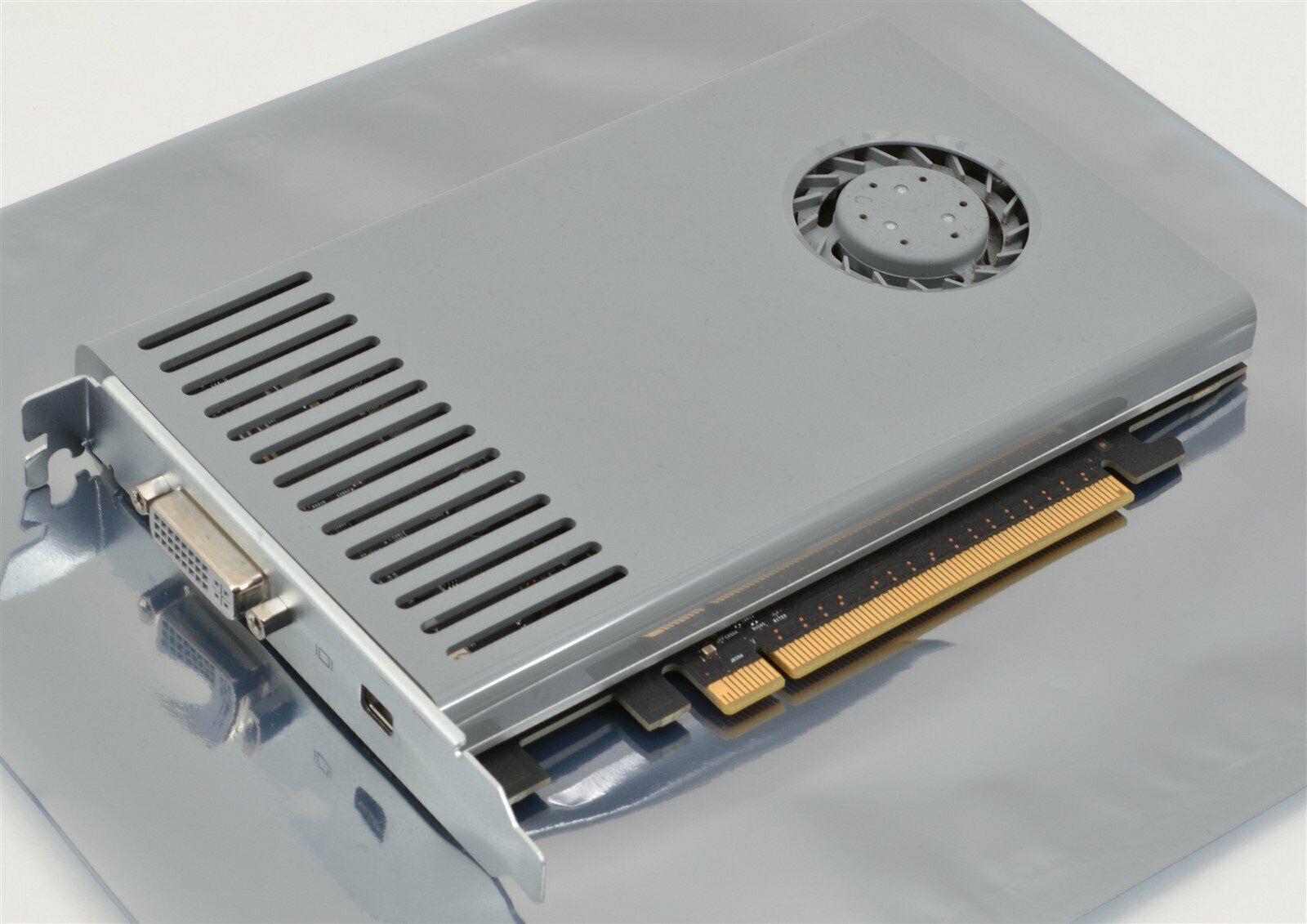

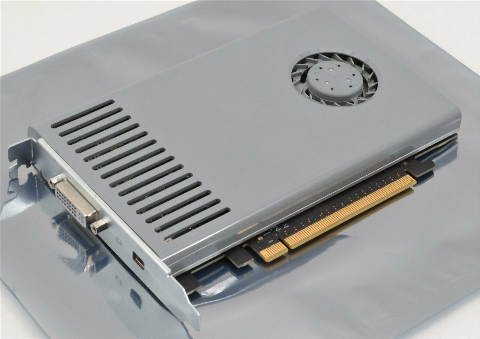

no unfortunately I don't have another pc and I tried the gt120 on all the slots of the mac pro, also I connected the cable via DVI and there are no other outputs on the gt120.
my gt120 for mac pro 3.1.
minidisplay port and what cable do I need then? my monitors all have hdmi input.
this cable maybe?
but can it make a difference connect to the monitor with DVI or HDMI or midisplay port?
The gt120 in the picture is the correct model, thanks for the confirmation. Out of my experience, those cards have not reported as a type that is likely to fail. You can do one last check and boot up with an open side door to see if the fan of that gpu spins up. Other than that the card is probably ok.

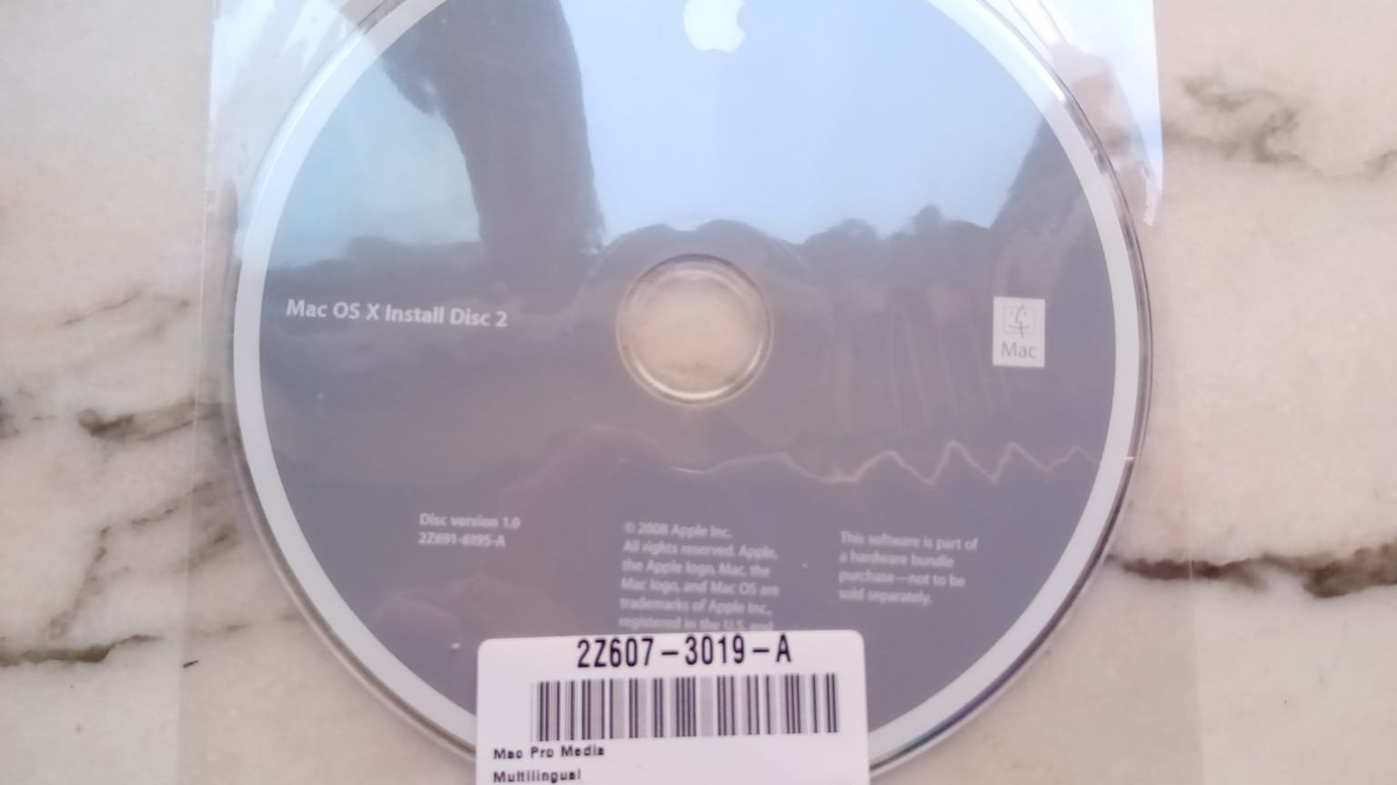

The next search for failure is to check your installation process, meaning - are all needed drivers available, in your case,- is this the correct DVD that you use?
In one of the Upper threads from you, you have mentioned MacBook Air. Is it possible that you somehow have a wrong install medium / DVD from a different device?
Maybe you have the wrong installation DVD? Does it say Mac Pro on it?
There are several different installation DVDs out there, (Full retail, device specific ones (grey) and special editions as well as self created ones) to name view.
Make sure to use the correct original install medium.

It's version 10.5.2 = too old for the GT120 (post #33).
You will have to make a usb installer .
