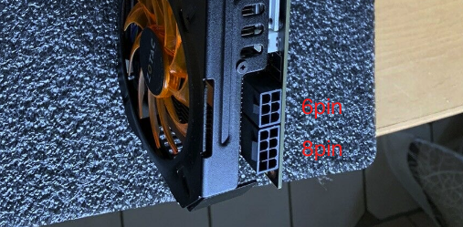

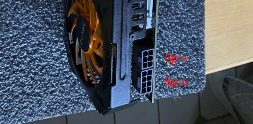

I ordered a used gtx780 my will arrive in a few days, I was wondering about the power cable they told me that the 780 has 2 cables, one 6-pin and one 8-pin, is that true?
in this case now i use the 8 pin cable for gtx960 and it will also work on the gtx 780 but i will also have to put another 6pin cable the one i had removed when i bought the mac pro used and it had a 1gb video card connected with a 6-pin cable.
am i doing the right thing? thank you.

I saw that even the gtx970 4gb is very powerful, indeed 10% less powerful than the 780ti but still has 4gb inceve of 3, now I have placed the order and it goes like this.
anyway, just to know the gtx 970 is compatible with my mac pro 2008?

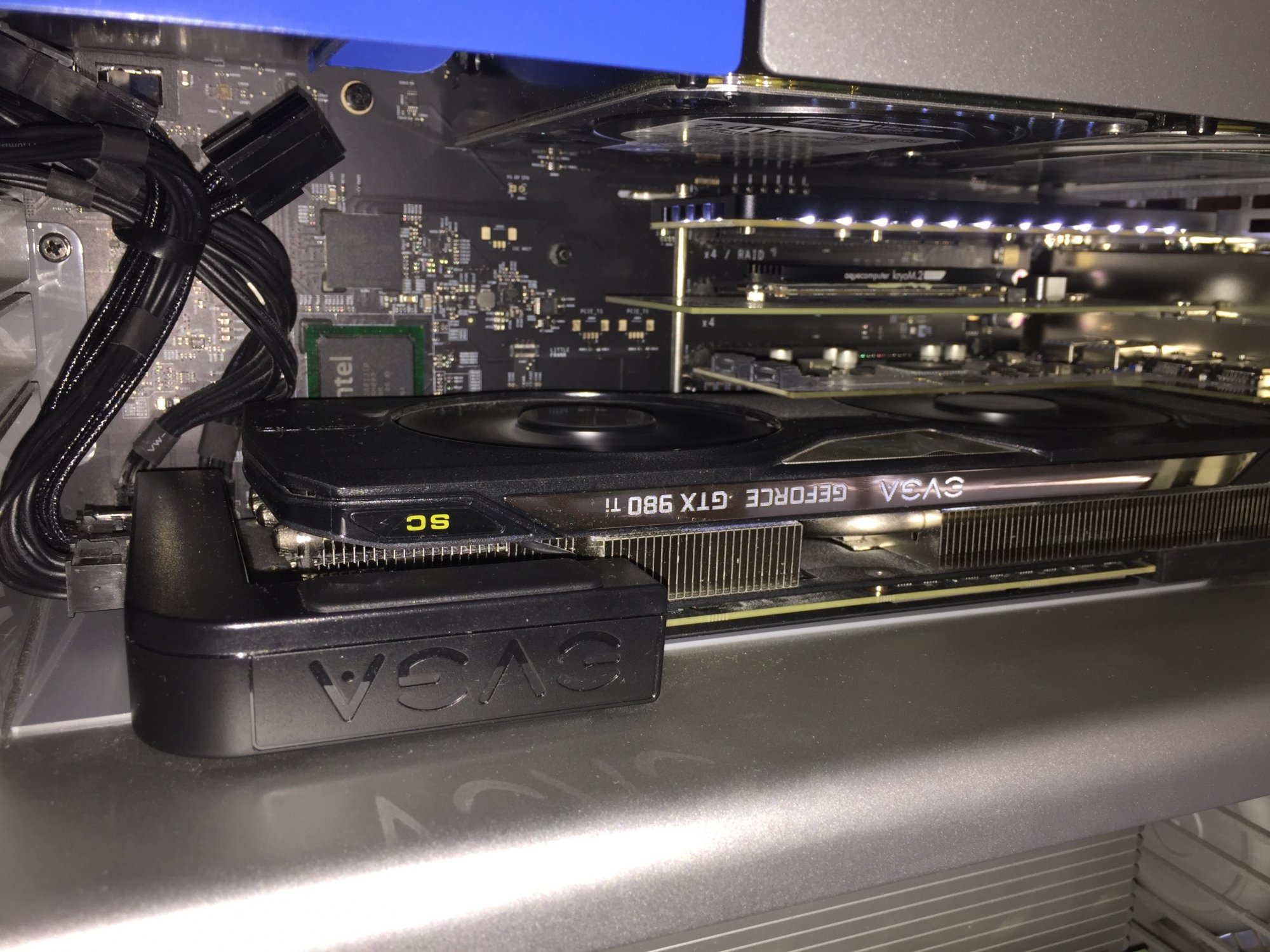

Back than when I still had my golden El Capitan setup in 2018, it looked like this in the pic below. I have used an EVGA Powerlink to connect my 980Ti. The big advantage of the EVGA Powerlink is that it balances out the power requirements between both powercables that go through the 6 pin Mac Pro cables. This way you avoid any shut down in case the GPU needs more juice during that rare 100% Power Loads. I have looked through my Mac Pro Goody-Box and I still have it here together with a Y Splitter and two 6 pin cables. You can have it all for twenty bucks + shipping to Italy. Its small and shipping should not be too expensive from South Bavaria, I am just across the alps..
Reactions: Augustots

Leave me your address in Italy in my email box and I will send you my EVGA power link with cable. You can have it for the shipping expense, this way you don’t need pixlas modification.
