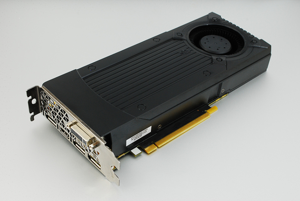

I went back to el capitan, I eliminated high sierra was a stretch in my opinion, el capitan is the right one for the mac pro 2008 and in my opinion it works better, I have a gtx 960 4gb and I connected 3 fullhd monitors and it works fine.
I am just wondering if it is better to replace my gtx 960 4gb with a gtx 980 4gb, what do you recommend?
The GTX980 performs better than the gtx960 , so would be an improvement.
You could also consider a GTX1070 or a GTX1080 (TI) : they perform much better but i dont know how prices are at the moment.
I would compare the prices and performance of these models and decide what you need and how much you want to pay for it.
Naturally you could sell the GTX960 to decrease the costs.
My best ElCapitan Mac Pro setup was with an Nvidia 980Ti from EVGA. This combo was absolutely amazing. This gpu felt as a vega 64 at that time. ElCapitan was that good that I skipped Sierra and High Sierra altogether at that time. The move to AMD GPUs was a step down for Apple but it was political motivated. Of course a 1080or a 1080Ti would be even better. It’s really up to you and the budget you have. The last official Apple Card from Nvidia was a Quadro K5000, but I don’t know much about it.
Down below you find a great store that is specialized on Mac Pro cards.
These are recommended for the MP 3.1:
Because of Bitcoin there is a world wide shortage on gpus right now. It’s not a good time to purchase gpus at the moment. Most of the cards that are mentioned above are weaker than what you have now. But you should be able to use 4.1 and 5.1 cards as well. The K5000 is the big exception of the rule, that does not need web drivers, because there was a Mac Edition available back then.

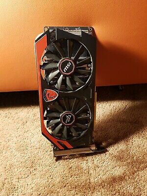

I then reinstalled high sierra on the mac pro 2008, and fcpx 10.4.6. imported 3840x2160 25p clips converted to prores 422 hq, and it works fine without clicks or problems, I don't understand why the other time it gave me big problems, now I use 2 monitors before I used 3 monitors that is that the problem?
mah !!! however I was thinking, a friend of mine uses premiere pro cs6 with a gtx 780ti 3gb and works in 4k always converted to prores saying that he also works in multicam great.
well, i instead use a gtx960 4gb msi, and according to the benckmark below it is less than my friend's 780ti 3gb.
as you can see the 780ti is 65% faster so a lot of difference from mine, but my curiosity is that mine has 4gb of vram while the 780ti has only 3 gb of vram!
does something change in your opinion? or and even if it has 1 gb less and the same more powerful than the 960?
the 1070 8gb on offer now no longer exists, the year sold and in any case it cost a lot while a gtx 780ti is also for 170 euros and it seems to me a good price for my mac pro 3.1, and I would have more power but the only doubt and the fact that it has 3gb instead of 4 like the 960.
thank you.

Hi Augustus,
To be honest with you, I did not pull up the numbers when you first mentioned the 960. Since I used to have a super speedy 980Ti for a very long time, I figured the 960 of yours would be kind of in the ball-park fast, - for sure below bit still ok. But the numbers really tell a complete different story. The 960 is a junker. There is really a massive difference here compared to the 780Ti. To put it in today’s perspective, the 780Ti is about on paar with today’s AMD RX 580. That means this card transports your Mac Pro into the year 2017/2018 From a GPU point of view. Compared to this, the current 960 really is a slow card that needs to be replaced no matter what. If you can grab a 780Ti for a reasonable price, get it. At this massive difference of 65%, the VRAM argument really does not come into play. 780Ti all the way.

Thanks, so 780ti 3gb is much better than my 960 4gb, and the fact that the 780ti only has 3gb makes no difference?
I will buy a 780ti for sure, they are at affordable prices, thanks again friend.
I have seen now on the web there are also gtx 780s at lower prices than the gtx 780ti, and in any case the 780 is much faster than the 960, so do you think that even if I take a 780 it would still be a good deal? or would you recommend spending more and getting a 780ti?
thank you.
thank you.
Looking at eBay auctions and sales prices, there can be great deals that diminish the price difference. I would get the Ti, the small difference in price is absolutely worth it. For FCPx you want a strong GPU. Dont worry too much about the Vram. My own bottleneck was always the type of gpu and never really a lack of vram. VRAM was always more of a marketing thing than actual power. AMD back in the day was very weak at that time and they introduced a 7950 Mac Edition with 3GB VRAM. The white card looked nice but it was total slow. The VRAM upgrade to 3GB at that time did not make any difference. The upgrade to a faster Nvidia card was way more effective Than going from 1GB vram to 3GB vram.
