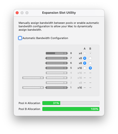

Did you check Expansion Slot Utility bandwidth allocations ?

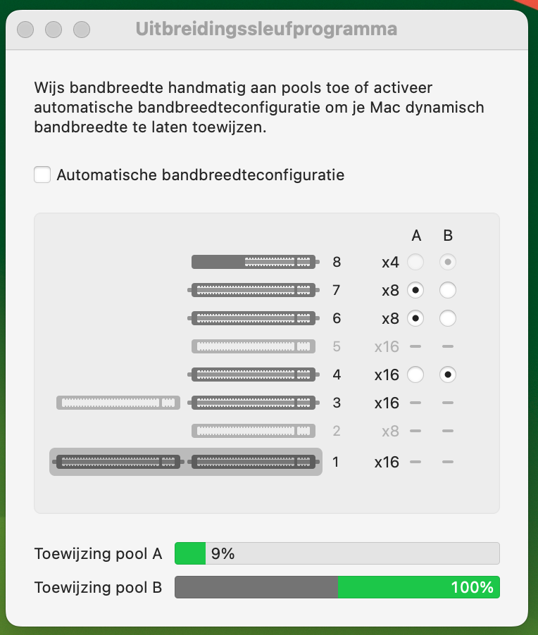

This is mine config:
Slot 3 = Sonnet
Slot 4 = IO crest
When IOcrest is in Pool B the IOcrest is vissible and the Sonnet not
When IOcrest is in Pool A the IOcrest is not visible and the Sonnet does
I spent the whole morning in switching Pool A or B, switching cards in differerent lanes and all I get
is or only the IOcrest is visible or only the Sonnet card. Seqoia only recognizes one RAID at the time.

Slot 3 = Sonnet
Slot 4 = IO crest
OK, so, you have RAID arrays on both M.2 controllers ? Just for testing, can you temporary use one or multiple NVMe blades on one of the cards without RAID ?
I've removed the RAID of the IOcrest. With two seperate blads it's working oké.
But when I configur a RAID in Seqoia it's gone again.🥴
