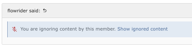

There's always at least one which doesn't have any issues like the rest of us, and with that statement for at least 2-3 times in this thread - doesn't contribute at all but braggs (at least in his mind).
At leat we have "ignore this member" option.

Ok, because you are grown up, explain the someones contribution in the thread by commenting multiple times: "I have no issues." How's this info of any use ? Of course I will ignore someone with not useful comments and make the thread cleared up and more readable. You have problem with this, I really don't care.

Is it really necessary to post that you are annoyed by some comments? Just ignore whatever you want. But we don't need to know about it.
You are inviting critique by the same standard as you display in your comments
I'm not annoyed, I just don't understand the point of stating multiple times that you don't have an issue. OK, we got it the first time.
