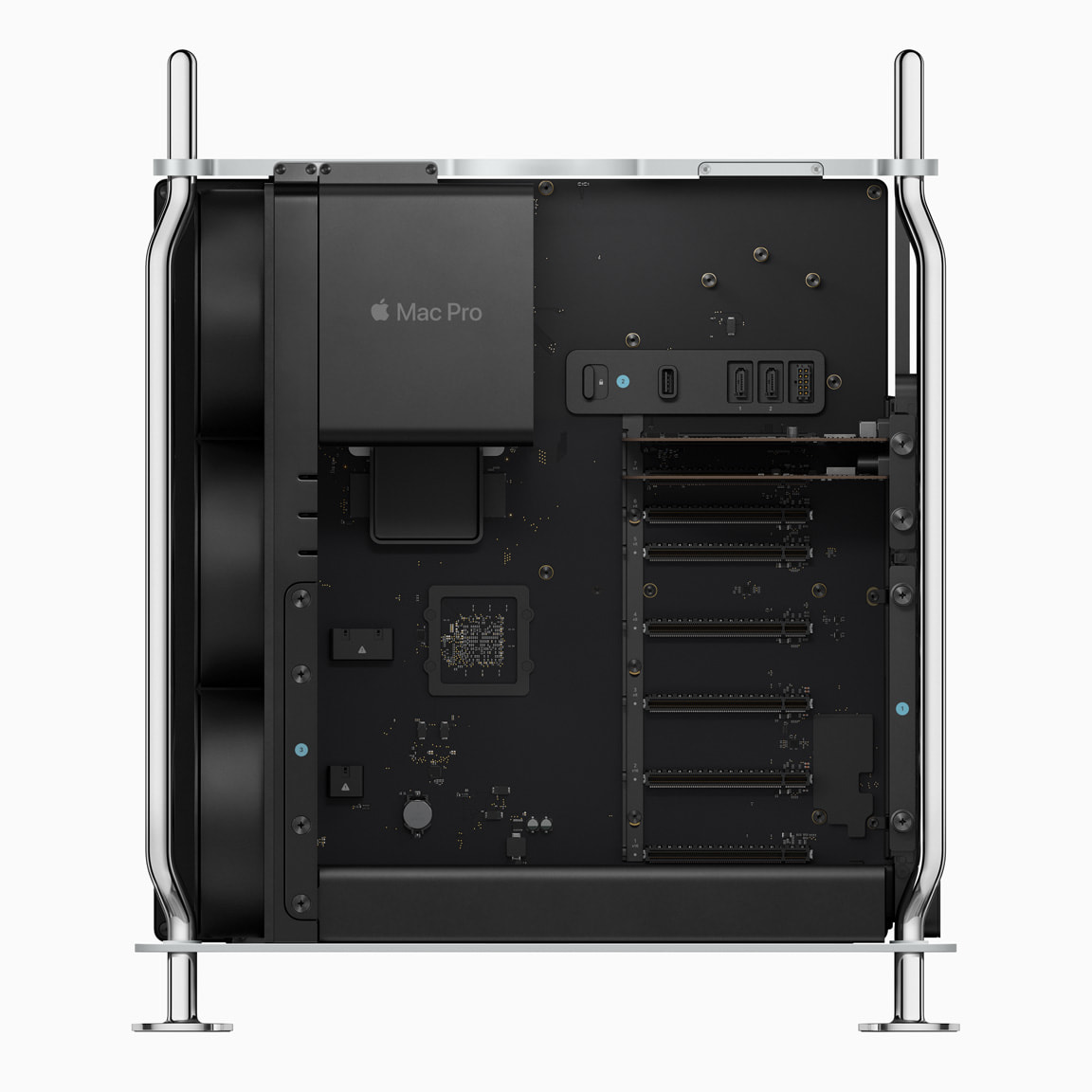

two x 1099 for two Sonnettech Echo III Destop Chassis that are PCI-E v3 and on the end of a TB bus each internal and no TB bus. So only 800quid for lower latency and higher bandwidth slots (if you need them) and if you don't you buy the Studio.
For my situation, the entire point of PCIe is to add Thunderbolt ports and fiber IO. Using a Thunderbolt port to go to PCIe will not get me more Thunderbolt bussing. Everything will be off the same thunderbolt buss from the computer.

Apologies. TB was for Thunderbolt, not terabytes.
I need 9 Thunderbolt ports to run an array of RAID drives for editing.
Ah, my mistake.
Is there any PCIe Thunderbolt cards out there? I believe the protocol is basically “PCIe in a cable” so that might be an easy way to expand there. I’m not an expert in this type of thing so I truly don’t know.
Thanks for the clarification
0339327
Cancelled
Jun 14, 2007
634
1,936
Ah, my mistake.
Not yet. But for the last MacPro, each GPU came with four Thunderbolt ports on two busses. Thus, my current machine has 12 ports of which 10 are used regularly.
Hmm that’s an interesting pickle. As opposed to the OP you seem to actually have real world critiques.
Do you mind filling in some details of your workflow to help us understand? I think unfortunately you may be in the bucket of workflows that Apple may longer be supporting.

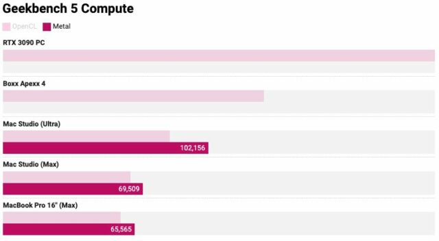

Apple GPU's performance is still fundamentally bad. Yes, it's bad. Both M1,2 series aren't even close to RTX 30 series which is based on Samsung 8nm, not TSMC 5nm. RTX 40 series are TSMC 5nm based and it's clearly not comparable. Since M1 Max/Ultra, Apple stopped comparing their own chips to Nvidia instead of Intel Mac because they know their GPU performance is just bad. Beside, the power consumption is too limited as well. Since M1 Ultra has similar performance to RTX 3060, I highly doubt that M2 Ultra is close to RTX 3090. RTX 4090's bandwidth is already way beyond M2 Ultra's 800GB/s and those workstation GPUs are way beyond that. Whoever defends Apple GPU's performacne, you never used RTX 40 series and workstation series. This is why Nvidia is dominating GPU performance for a while.
On the other hand, Mac Pro 2023 supports only one M2 Ultra which is a joke. Mac Pro 2019 supports up to 4x highend workstation GPU and others can go beyond that. Apple did not make M2 Extreme or something better instead of re-using M2 Ultra for so called workstation. No, M3,4 can not save Mac Pro as long as it's SOC and not expandible.
Apple GPU is powerful? Since M1 Ultra cant even close to RTX 3090 but 3060, which is a hard fact, I dont think M2 Ultra is still close to RTX 3090.
I use RAID 5 drives for storing video files. I backup each drive in duplicate with two other RAIDs. I have about 5 sets of these and to prevent accidental corruption, I don’t power drives that aren’t being used, which means that I can’t daisy chain drives outside the backups.
I then use SSD raid 0 drives for high speed editing. Those use another few ports.
Lastly, there are some USB devices that don’t work well on a hub. They need to go direct, such as when using a keyboard and need to hold down a keystroke during a restart.
In general, I need a lot of ports. I can prob make do with 8 but I’m hoping that Sonnettech or OWC will make a PCIe with extra thunderbolt ports and / or extra SSDs or HDDs.

In games, it is closer to 3070 laptop GPU, which is based on GA104 die.
Which games though? There are very few demanding games with high quality macOS ports out there. RE village would be interesting to look at, certainly Death Stranding when it arrives (even though it’s a slightly older game it’s technology is super impressive).

Ah, my mistake.
There are tons of PCIe thunderbolt cards out there. Some of them even work in the 5,1 Mac Pro, which is pretty neat! No idea if those cards also work in the 7,1 or 8,1 but I would bet they are supported by MacOS moreso than the 2009 era backplane of the classic Mac Pro, so they probably do work in modern mac Pros. Silly that Apple doesn't sell one themselves, another 6 or 8 TB ports by using one of the PCIe slots on the 8,1 would be worth a lot to some users for sure. Worst case, the Apple I/O cards will end up on secondhand market someday and I bet there's no reason you can't run two of them in an 8,1
A maxed out 2023 MP is around $10K which isn’t bad, provided it does the job.
Do none of the PC PCie thunderbolt cards work in the 7,1 Mac Pro? Gigabyte Titan Ridge cards definitely worked in the 5,1 and gave 2 thunderbolt ports quite affordably.
