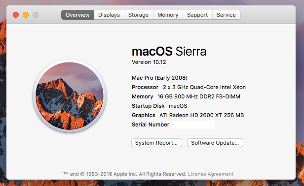

I had to use the patch tool but macOS Sierra is running quite happily on my Mac Pro 3,1. I don't have a microphone so Siri is disabled. I'll have to get around to replacing the stock graphics card. Mine originally came with two 2600XT cards and can support up to four displays, though I took one card out so I could put in an Accelsior S card with a SATA-III controller for an SSD. (Boot time is about 35 seconds - not bad!)

Running smooth on my 3,1! For some reason, the patched USB installer would not boot - it would kernel panic halfway through. But I used the patched installer on another Mac and installed OS X directly onto the external SSD. Slid that back into the Mac Pro, and boom, Sierra booted right up! My USB 3 card works, my osxwifi.com AC card works with handoff, copy&paste, unlock with apple watch, GTX 970 with nVidia web drivers, everything! It's quick and running smoothly!

The good news is, after a LOT of help from Netkas, it looks like I'm finally there and have Sierra running on Mac Pro 3,1
It's installing now.
I will produce detailed, clear, unambiguous, instructions on how to get Sierra running on the Mac Pro. Given everything I have learned from repeated, failed installs, I now know what works and what doesn't, and you'll find that if you follow the instructions precisely, it isn't difficult to get it up and running. Nor will it be maintaining it.
NVIDIA has also released the web driver for Sierra - which is great news.
http://us.download.nvidia.com/7tx5AvsWQd8nYQnjJcntrzcxTzpKACuH/WebDriver-367.05.10.05b03.pkg

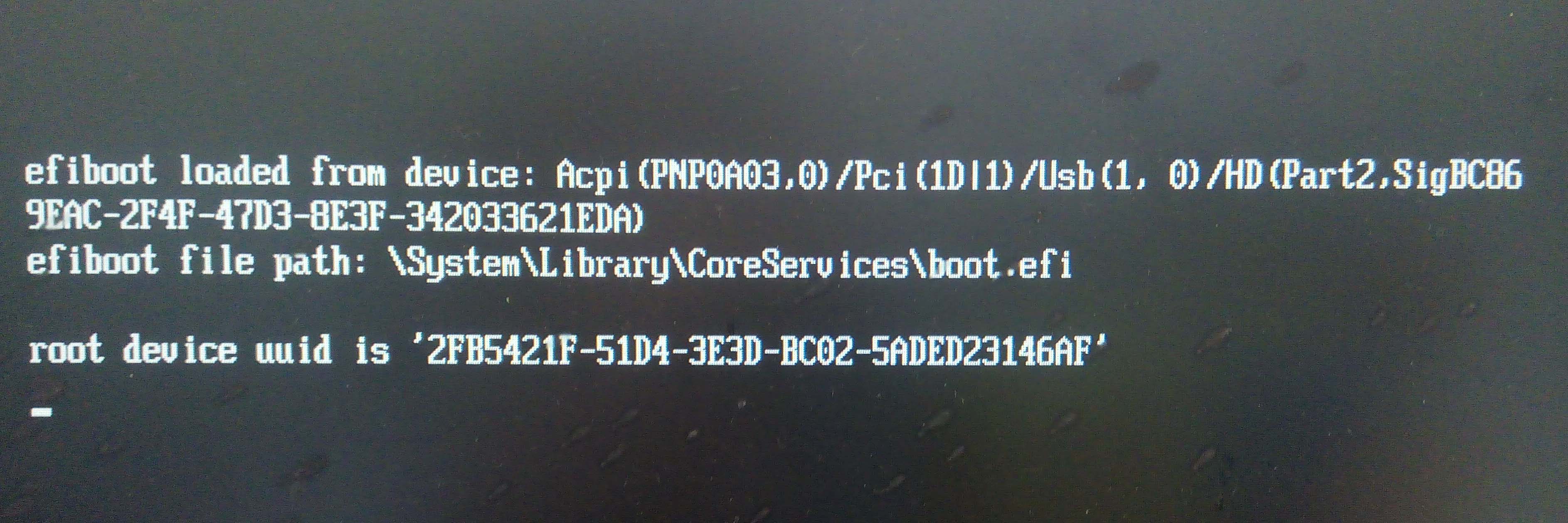

Hi,
Can someone advice how to solve boot stuck on MacPro 3.1 (early 2008, 2x3GHz Quad Core, Ati HD 2600 XT, 32 RAM).
Using USB flash drive for startup, used this way for creating bootable flash drive http://dosdude1.com/sierrapatch.html
Also was using this way https://forums.macrumors.com/threads/mac-pro-3-1-installation-guide-for-sierra.1978005/
Result same for both, see pict.
I will be grateful for the advice.
Maybe try a different USB drive?

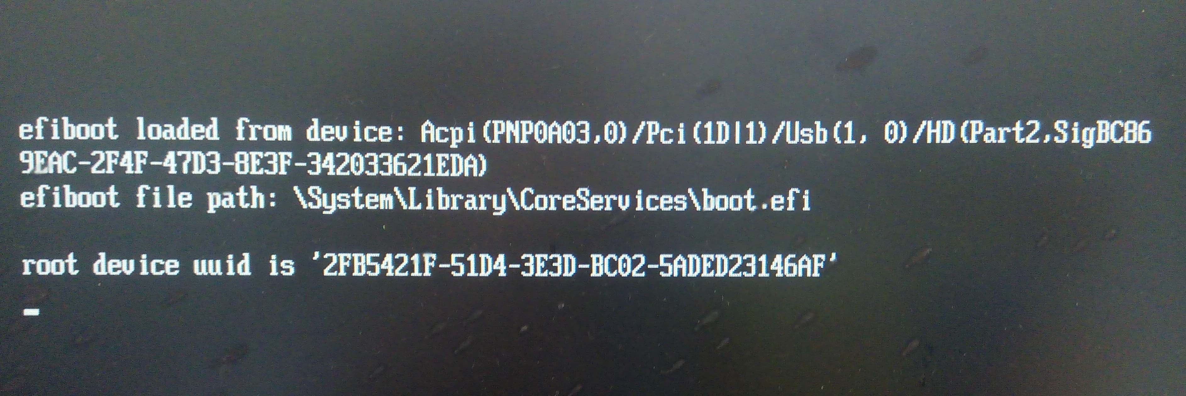

Hi,
As I indicated earlier in this thread, the ATI (AMD) HD2600XT is a crap card (It's been recalled at least twice) and should be replaced. This may be your problem. I was lucky and unloaded mine on eBay years ago.
