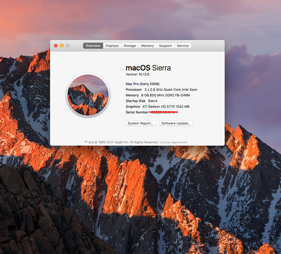

Anyone updated to 10.12.6?
I did the update from the Apple App store, no problems.

How did you do the update, was it via the App Store or did you download from the Support Download pages.
I guess it would do no harm to rerun the Post install patch.
Via the Combo Update. As you say, reapplied the Post Install path and now it works like a charm.
Thank you so much.
