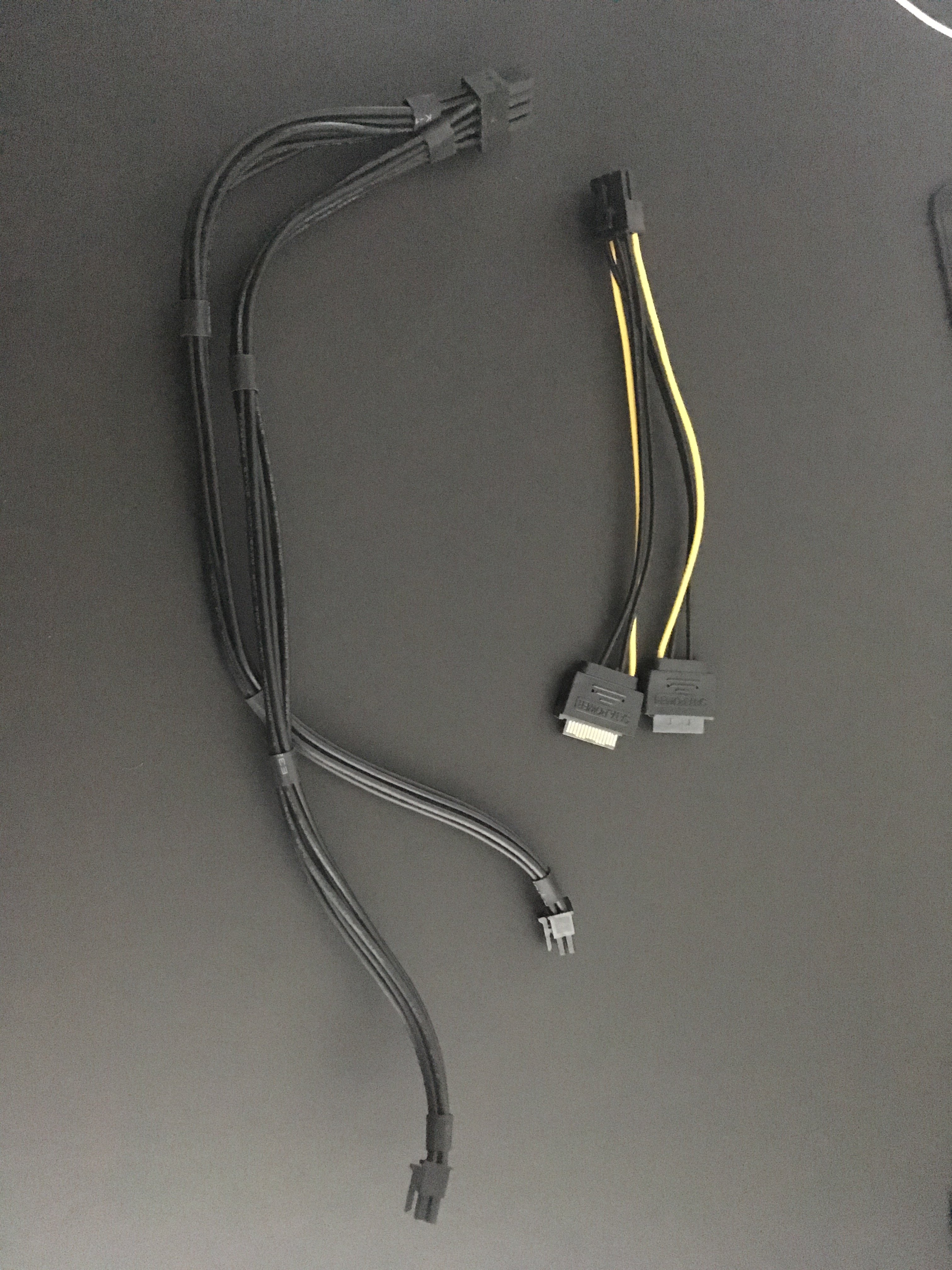

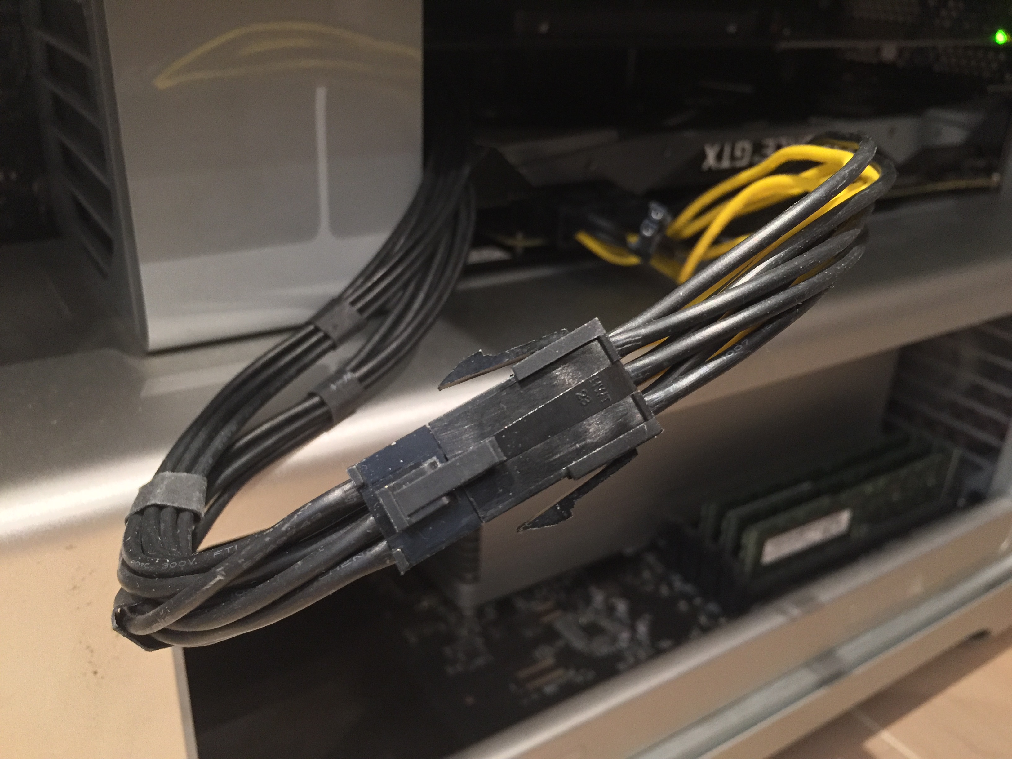

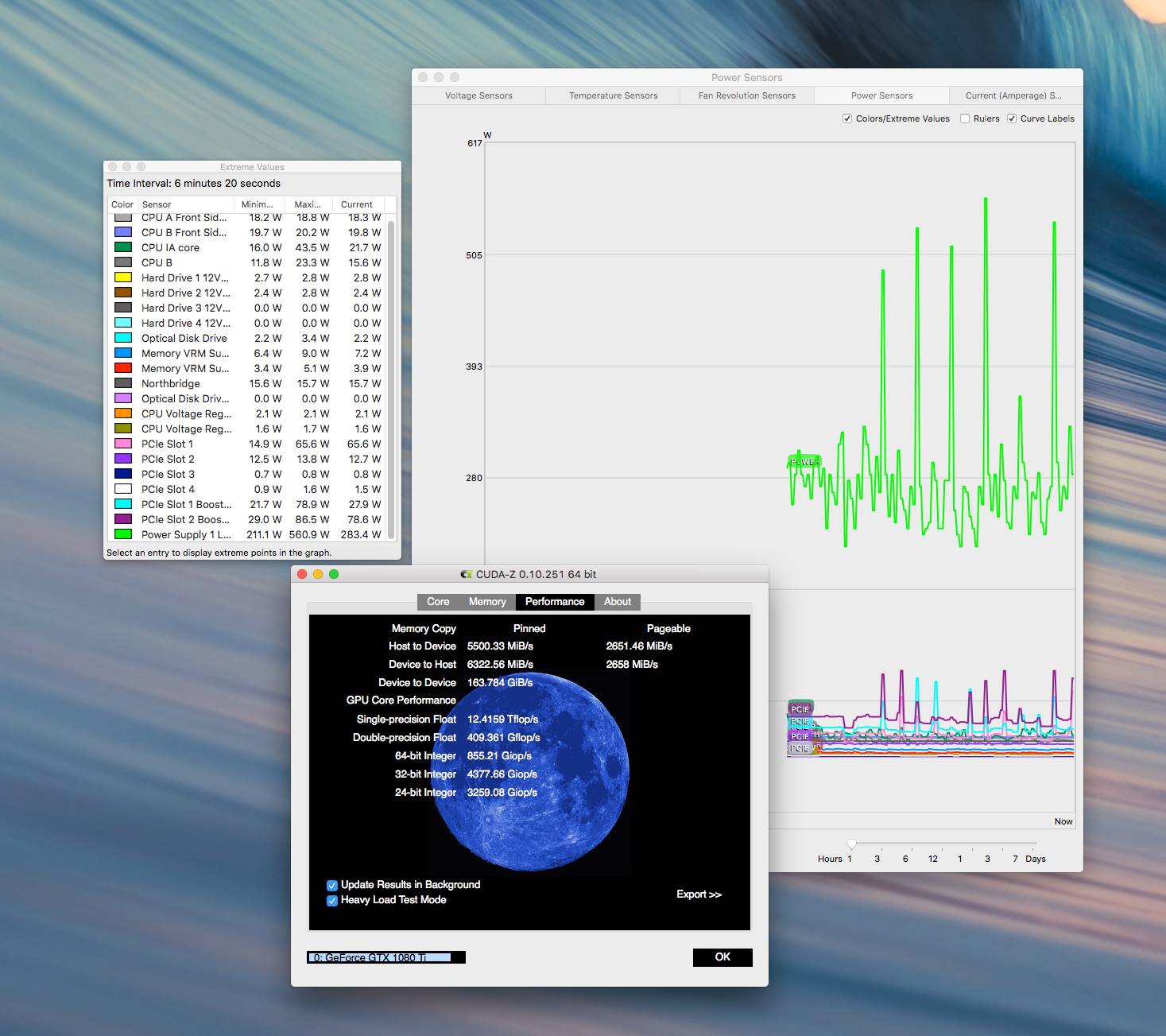

Just a short note that you can run Sapphire Radeon RX 580 Nitro+ Special Edition (the overclocked one) on a regular unmodified Mac Pro.
For reliable operation you need to completely ignore 6-pin input on the card and use only 8-pin with a splitter to 2 x 6-pin on the motherboard.
I measured the power consumption with Marcel Bresink's Hardware Monitor and the card is idling at only 7.4W on PCIe slot and around 10 - 15W per PCIe AUX lines A and B.
Then, I pushed the card very hard with the FurMark test and it passed the benchmark flawlessly. The consumption was 85-95W at AUX lines and 50-65W on PCIe slot. So, everything seems within specifications that we expect and I guess it's reasonably safe.

Sounds good, but why not further split the 8pin to dual 6+2? So that no need to leave the 6pin input useless.
The card won’t draw extra 75w. With still at least 55W “safe” power available from the mini 6pins. I personally believe it’s better to connect the other 6pin as well.

Just saw an interesting post on Facebook.
This guy power the PNY blower 1080Ti via a EVGA powerlink. And it can run CUDA-Z without shutdown.
So, may be CUDA-Z isn't really that demanding, but can create a power spike that's strong enough to shut down the Mac.
May be it's because there are some capacitors inside the powerlink to "smoothen" the power draw.
If the theory is correct, I wonder if this kind of cables (with build in capacitor) can help as well.
https://www.btosinte.com/Seasonic-8...Cable-w-inline-capacitor-SS-IN-8-2x62PCIe.htm

That's what I did... As you can see on the picture I finally got my hardware home
The 2*mini 6-pin to 8-pin cable seems to be great and can power it (my GTX 970) so the lights and fans turn on but the 2*sata to 6-pin cable won't fit in my Mac Pro so did not get any image. I had to crack the "sides" on the sata connectors to get it connected to the motherbord (guess there is no other way since it's the power from the slots one needs and not the data part) ? ? ?
but......
That cable isn't long enough since it can't connect to the GPU despite being 20cm
I bought this one:
https://www.ebay.com/itm/20cm-Dual-SATA-15Pin-Male-M-to-PCI-e-6-Pin-Female-F-Video-Card-Power-Cable/162714342690?ssPageName=STRK:MEBIDX:IT&_trksid=p2057872.m2749.l2649
I am stuck :( :( :(
My plan was to power this card "the right way" by using two SATA ports but seems I need to take the road with mini 6-pin to 6-pin and mini 6-pin to 8-pin ? ? ?
Reactions: MIKX
but......
I bought this one:
I am stuck :( :( :(
It's fine to use mini 6 -> 8pin to power a 6+8pin 970. The 970's TDP is quite low actually, nothing to worry about.
But if you want to do it "the right way", then why not get another cable? A longer dual SATA -> 6pin or a FEMALE 6pin to 6pin EXTENSION cable can also fix your problem.
In fact, for 970. I prefer to get another FEMALE 8pin -> Dual 6+2 pin. So that you don't need any SATA power.
I can using this "bridge method" to power a 1080Ti, for 970, this should be nothing.

Thanks for the answers!
I know GTX 970 (6-pin + 8-pin) isn't that demanding like some of the faster cards for the Mac Pro but I want to do it the best way possible and maybe be able to overclock it in windows (it's a fantastic card for that, many achieve stock GTX 980 speeds)
But where? I have been looking all over. All cables are 15 to 20 cm long and all of them seems to have "clippers" on the sides so you have to break them of to get the cable connected on to the "wider" SATA ports on the Mac Pro motherboard...
Should work too yes but it's about 3cm that is missing and all the extension cables I am able to find are like 40-50 cm and that's a whole lot of extra crap lying inside my beautiful baby :)
Please post links for all the cables you imagine I would have to use with this method. At this point I'm a bit confused...
[doublepost=1525110024][/doublepost]
https://www.ebay.com/itm/PCI-E-8p-F...GPU-Video-Card-Power-Cable-30cm-/263422269544
So you want to connect this kind of cable to the 2*mini 6-pin --> 8-pin I already bought?
Will this method distribute power better than one mini 6-pin to 6-pin and one mini 6-pin to 8-pin ? ? ?

Guess that will be my back-up plan!
No ideas for the other solutions? Am I completely retarded or isn't it really uphill to get the right cables like I described in the last post ? ? ?
It's your choice. I can't tell you where to get the longer cable. I can easily get those long enough cable from the computer shop which just 20min away from my place. So, no link can provide.
And if you don't want any "too long" cable inside the case as well. Then obviously it's impossible to buy a 3cm extension cable. However, it is very easy to mod the cable by yourselves to make it 3cm longer.
And yes, there is no "right connector" cable you can get on the SATA side. AFAIK, you have to remove the latch.
As I said, I personally prefer the "female 8pin -> dual 6+2pin" method. And you found the cable.
MikkelAD
macrumors regular
Feb 17, 2018
188
33
Damn I live in the wrong country :) Just thought it would be easy to find on eBay/Amazon but it really isn't :(
Well a new kind of wire and that should be doable maybe...
By the latch you mean those two clippers (1 on each side of the SATA cable) right?
Yep looks like that will be the way to go most likely. Damn I hope my Gigabyte GTX 970 G1 will work probably now that it's not a reference GTX 970...
I read the post you linked earlier about your own GPU upgrade. Can you somehow explain to me why the power load will be more evenly distributed with the "bridge method ? ? ?
Again thanks for all the answers!
